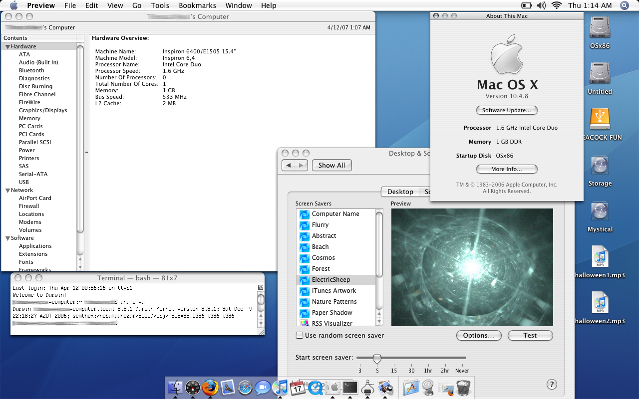

Mystical Dream Posted April 12, 2007 Author Share Posted April 12, 2007 Update - Installation complete! So here's the rundown of what I needed to do to install OSX 10.4.8 sucessfully on my Dell 6400/E1505 Hardware - Dell 6400/E1505 15.4" Core 2 Duo - T2050 1.6 SSE3 Sigmatel 9200 HDA Broadcom 1390 Wireless Broadcom 440bx LAN Intel 945 (GMA950) - Native 1280x800 80gb SATA + 120gb USB Triple boot WinXP-MCE, Fedora 6 and OSX Software: Acronis Disk Suite Alcohol 120% Image : Mac OS X 10.4.8 [JaS AMD-Intel-SSE2-SSE3 with PPF1 & PPF2].iso Burned to DVD for native install Keep in mind that I did not wipe my drive prior to partitioning or installation of Linux or OSX. First thing's first - Partition the disk properly. Most of these Dell's shipped with Windows XP-MCE installed with 2 other partitions on the drive. There is a small 50mb partition in the front of the disk, the main NTFS partition, then another partition with the restore info. I don't care about the restore point - Deleted the 50mb partition and moved NTFS to the front. Without that partition what is the point of the other? Delete that other partition. (Note: I think that removing these factory partitions before installing Linux/OSX would have saved alot of headaches.) Final partitions: NTFS - 35gb~ (this partition uses up whatever the other 3 do not) Ext3 - 10gb FAT32 - 25gb SWAP - 1gb Acronis does a fast job of partitioning the drive. I used to use PartitionMagic. Not any longer. Be aware that I think removing that first partition from the drive does something to the NTLoader. You will need to repair the Windows boot partition. I will point out when I noticed this error in the following steps. Once the drive was partitioned I installed Fedora 6 to the ext3 partition. Please note that Fedora 6 does not support the network card and sound out of the box. It would be suggested to install a minimal FC5 then install FC6 with all the options you desire in order to expedite the process. Wireless still requires ndiswrapper process. GRUB installed as bootloader. Install OSX from DVD. Disk utility >Erase >FAT32 partition format as MS-DOS (can we skip this step?) >Format as HFS+ (journaled) 2x (it appeared to have success after first pass) >Exit Continue install - Select customizations you desire. I chose: Intel SSE3, GMA900+950, English Only, Sigmatel Audio, No Printers Skip Disc Verification (unless you are not sure of the quality of your media) Welcome to Tiger video! No sound. Registered (do you really think Apple is going to send someone to your house? I don't. I'm Beta Testing and own a copy of Tiger) Wireless Works. Lan works. Audio does not work. Video works. Reboot. (skipped Grub?) Wireless does not work. Lan does not work. Audio still does not work. Video is fine. Replaces IONetworking.kext with older version from Devilhood's post (not positive this is necessary). Reboot. No networking. Used Sportman's guide for Broadcom 1390 (4311 is the number BTW). Used EN2. Reboot. Found Airport. Found LAN! Reboot for AppleHDA. Press F8 at Darwinx86 and use -legacy. Used Taruga's guide for this. I used an audio codec I found in that post then pulled my own from my linux boot. There is a difference in the files, but not a functional difference that I have noticed. Audio out works, Mic IN does not. Mute on jack does not work. I don't have super loud external speakers, but frequency response seems good. Reboot for Windows. F8 at Darwinx86. NTLDR (hal.dll) cannot be found (this is the part I mentioned before). Boot to WinXP install disk to repair the MBR using fixmbr. Reboot. Boot brings me to a menu to choose which Windows to boot to - Blank or XP-MCE. MCE gives me Hal.dll error, blank boots to Windows. Edit boot.ini to remove menu. Reboot. Windows boots fine. Reinstall GRUB from LiveCD (GPartEd). Generic b&w GRUB menu Linux cannot find kernel, Windows boots, OSX not found. Boot to linux using Fedora disc to edit /boot/grub/menu.lst Partitions are misdirected - corrected: windows root(0,0) linux root(0,1) Add OSX to menu (0,2), also specify makeactive after rootnoverify on windows and OSX. This would also be a great time to set your default boot option. Reboot. Fedora color GRUB loader: Linux kernel boots. Windows boots. OSX boots. Linux boots. Functional: 1390 Wireless, Sigmatel 9200, BCM440X LAN, Video, USB. Partial Function: Single Processor Front volume controls - No mute or Track control. Touchpad - No Sidebar Scroll/Multiple Finger Scroll NTFS Volume management Keyboard - Ctrl, Windows, Alt - Not always consistent (cmd-shft-3 screenshot was ctrl-shift-3, cut and paste is alt-c/alt-v) No Function: Wake from Sleep SDCard Reader That just about wraps it up. A satisfactory install of OSX on a machine that was already running a dual boot setup. Learned alot about MBR editing in this process due (mostly) to the fact that I removed the first primary partition after installing linux and before installing OSX. I feel that this may also have been what caused the hal.dll error I received, not the installing of OSX. See attached screenshot. If anyone needs help with post installation partition management please post it here! I am not a developer and do not have all the answers, but I have avoided a wipe and install. If anyone has any problems with their Dell 6400, please post them here. Mad thanks go out to JaS - without you this project would have been more hassle than compiling a slackware 1 kernel. Devilhood - Thanks for the 9400 walkthrough! Taruga - Great job on the AppleHDA fix! Thank you for your continued efforts to push the impossible into reality! Mystical Dream Link to comment https://www.insanelymac.com/forum/topic/46590-osx-on-a-dell-6400-status/#findComment-345308 Share on other sites More sharing options...
