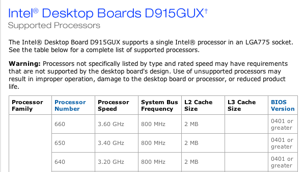

guilliamo Posted March 12, 2007 Share Posted March 12, 2007 billuta: Your English is fine and MUCH better than my Spanish. What you want to do will work fine, and will not require any modifications to your OSX86 installation. Two cautions: 1) Need to make sure that your BIOS will support the faster/newer processor (see attached). 2) Need to make sure that your heat sink & fan support the new processor. G Link to comment https://www.insanelymac.com/forum/topic/45050-updating-the-micro/#findComment-322039 Share on other sites More sharing options...
