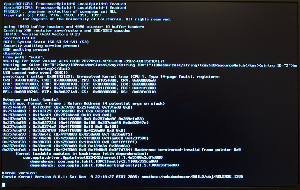

I do receive this error during the boot
panic(cpu 1 caller 0x001A3129): Unresolved kernel trap (CPU 1, Type 14=page fault), ...
and probably the problem is the network card, isn't it?
Kernel loadable modules in backtrace (with dependencies):
com.apple.driver.AppleIntel8254XEtnernet(1.1.4a5)@0x3c01d000
dependency: com.apple.iokit.IOPCIFamily(2.1)@0x359ca000
dependency: com.apple.iokit.IONetworkingFamily(1.5.1)@0x3bf3e000
Is there any way to fix this problem? Or is there any way to disable the network card, do you think it might be a solution?

Do these lines mean I do not have these files?
if not, what do they mean?

I was having the same problem with an Toshiba Satellite P105, but, belive it or not the solution is quite easy
This folliwing line means: (I Belive)
that there's a problem with your distribution intel integrated ethernet driver.
Simple as is, just disable the ethernet from your bios, and you will be more than done (at least I did!)
Good luck! and post if it worked for you
