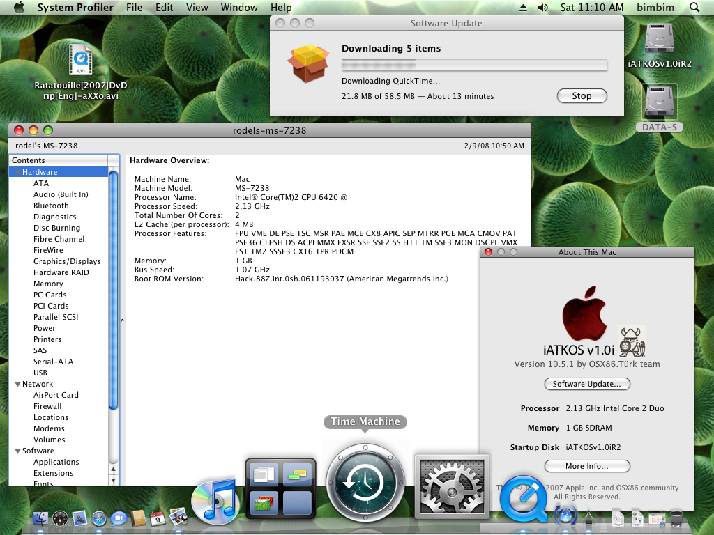

rjnagua Posted February 9, 2008 Share Posted February 9, 2008 BoBoeBoe, I was able to install iATKOS v1.0i R2, i just downgraded my bios from latest 1.8 to 1.6. Here's my system specs: MSI P965 Platinum v.1.1 with BIOS v1.6 Seagate SATA 120GB Seagate SATA 160BG Inno3D Nvidia 7300GT DDR2 256MB LAN : builtin Sound: buildin Card Reader: not working check this thread **http://forum.insanelymac.com/index.php?showtopic=39567&mode=threaded** ===START=== Finally i got it working so here is what i did: i was having problem with ACPI when trying to boot from the iatkos v 1.0i and r2 i was getting this ''extension ''com.apple.driver.AppleACPIPlatform'' has immediate dependencies on com.apple.kernel and com.apple.kpi components use only one style'' or ''extension ''com.apple.driver.ACPI_SMC_Platformplugin'' has immediate dependencies on com.apple.kernel and com.apple.kpi components use only one style'' and i solve it thank god then all of you what i did is downgrade My motherboard bios from latest online v1.8 to 1.6 and it fix my problem right away. my sys : Intel Core 2 Quad 2.4GHz 2GB kingston hyberx 800MHz DDRII Memory MSI P965/ICH8R platinum Mainboard bios downgrade to v1.6 WesternDigital sata WD1600AAJS HD WesternDigital sata WD5000AAKS HD lite-on sata 20x DVD Burner : working Nvidia GeForce 7600GT 256MB : working with r2 thermatek 750W Power Supply 12cm fan realtek audio : working out of the box cardredar : not working =========== END OF HIS POST======== Link to comment https://www.insanelymac.com/forum/topic/39567-howto-install-os-x-on-msi-p965-platinum-core2duo/#findComment-614902 Share on other sites More sharing options...
