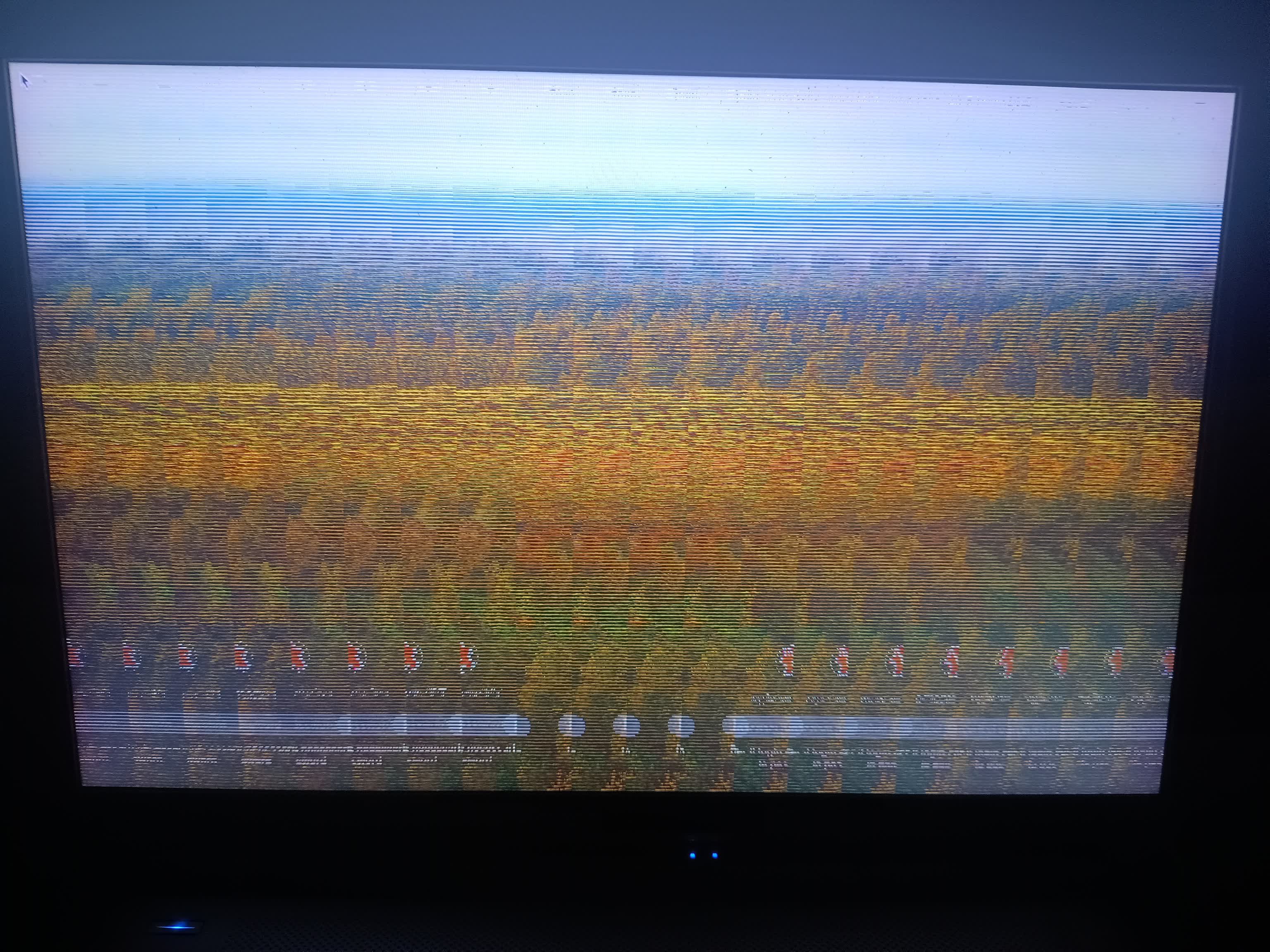

- FB-only is working but on my machine got visual problems tiling/stride core on 'paramSurfCompare' hook (forcing linear and stride 0xa0 is the only one way in which I can see something.. despite to apple wants x-tiled with 0x14 stride got black screen with this mode)
