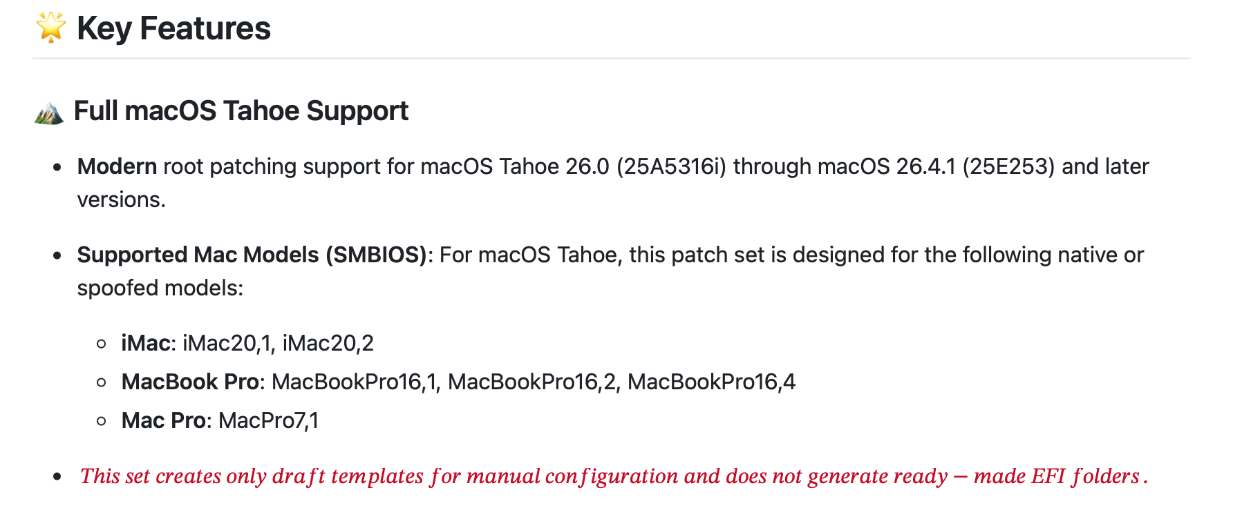

MakAsrock Posted April 26 Author Share Posted April 26 (edited) OCLP-Plus (Tahoe Patch Set) for now it will be like this: 🏔️ Full macOS Tahoe Support Modern root patching support for macOS Tahoe 26.0 (25A5316i) through macOS 26.4.1 (25E253) and later versions. 📖 `Readme` 🔖`Changeling` Supported native or spoofed models (SMBIOS) in macOS Tahoe: iMac: iMac20,1, iMac20,2 MacBook Pro: MacBookPro16,1, MacBookPro16,2, MacBookPro16,4 Mac Pro: MacPro7,1 This set creates only draft templates for manual configuration and does not generate ready-made EFI folders. Legacy root patching support for macOS Sequoia 15.7.5 (24G624) and earlier, as in OpenCore Legacy Patcher 2.4.1. Note: For macOS Sequoia and earlier, compatibility and SMBIOS requirements follow the standard limits of each respective operating system. Edited April 28 by MakAsrock 3 Link to comment https://www.insanelymac.com/forum/topic/362543-the-oclp-plus-3x-tahoe-patch-set/page/3/#findComment-2849547 Share on other sites More sharing options...

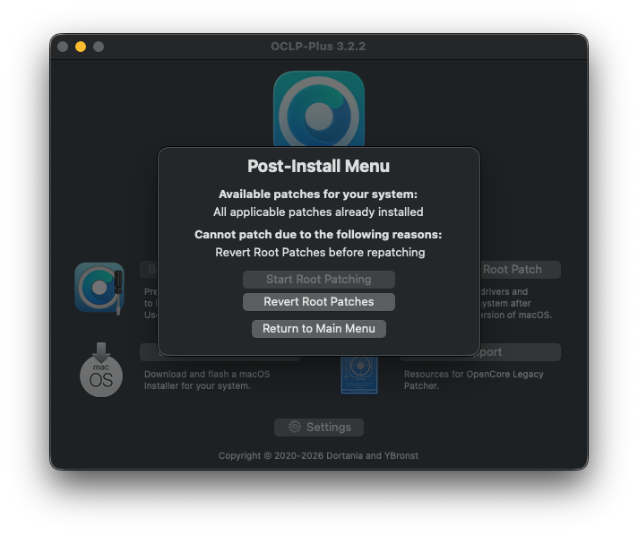

Jessy Lou Posted May 4 Share Posted May 4 (edited) Done with the PCI path I got from Hackintool on Sequoia. Just booted on Tahoe... Same. I checked with Hackintool, the card is present on PCIe. When I open OCLP-Plus, to run Post-Install Root Patch, I always get: Available patches for your system: All applicable patches already installed Cannot patch due to the following reasons: Root volume dirty, unpatch to continue. I have this since days, without finding the solution. Shall I try to rebuild the EFI partition? Honestly I don't know how to fix this, while many others get success on the 1st shot. PS: while my Sequoia partition is vital for me, I'm booting Sequoia based on the following config.plist (I didn't manage to use only one, even after the helpful help from KGP)... and I can't boot on Tahoe with this config.plist: crash. My install: first SSD (NVMe) dedicated to Sequoia with its dedicated EFI partition. Second SSD (Samsung on SATA) dedicated to Tahoe with its dedicated EFI partition. While I boot on Tahoe quite quickly and while everything (including Ethernet) is working except my Wi-Fi, I'm not that convinced the Tahoe EFI partition is broken. But I don't know what "Root volume dirty" means. config-sequoia.plist Edited May 4 by Jessy Lou 1 Link to comment https://www.insanelymac.com/forum/topic/362543-the-oclp-plus-3x-tahoe-patch-set/page/3/#findComment-2849813 Share on other sites More sharing options...
MakAsrock Posted May 4 Author Share Posted May 4 28 minutes ago, Jessy Lou said: Done with the PCI path I got from Hackintool on Sequoia. Just booted on Tahoe... Same. I checked with Hackintool, the card is present on PCIe. When I open OCLP-Plus, to run Post-Install Root Patch, I always get: Available patches for your system: All applicable patches already installed Cannot patch due to the following reasons: Root volume dirty, unpatch to continue. I have this since days, without finding the solution. Shall I try to rebuild the EFI partition? Honestly I don't know how to fix this, while many others get success on the 1st shot. PS: while my Sequoia partition is vital for me, I'm booting Sequoia based on the following config.plist (I didn't manage to use only one, even after the helpful help from KGP)... and I can't boot on Tahoe with this config.plist: crash. My install: first SSD (NVMe) dedicated to Sequoia with its dedicated EFI partition. Second SSD (Samsung on SATA) dedicated to Tahoe with its dedicated EFI partition. While I boot on Tahoe quite quickly and while everything (including Ethernet) is working except my Wi-Fi, I'm not that convinced the Tahoe EFI partition is broken. But I don't know what "Root volume dirty" means. config-sequoia.plist 37.65 kB · 1 download The "Root volume dirty" error happens when OCLP detects that previous patches were interrupted or the system volume flag wasn't cleared. You don't need to rebuild your EFI partition! To fix this, you just need to revert the root patches and apply them again. Here is how: Open OCLP-Plus in macOS Tahoe. Click on Post-Install Root Patch. Look for the "Revert Root Patches" button (or it might be under the "Unpatch" option depending on your version) and click it. Once it finishes, reboot your computer. After the reboot, open OCLP-Plus again, go back to Post-Install Root Patch, and run the patcher normally. 1 Link to comment https://www.insanelymac.com/forum/topic/362543-the-oclp-plus-3x-tahoe-patch-set/page/3/#findComment-2849815 Share on other sites More sharing options...

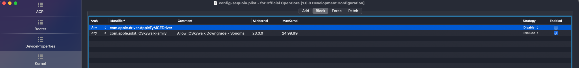

kgp Posted May 4 Share Posted May 4 (edited) 1 hour ago, Jessy Lou said: Done with the PCI path I got from Hackintool on Sequoia. Just booted on Tahoe... Same. I checked with Hackintool, the card is present on PCIe. When I open OCLP-Plus, to run Post-Install Root Patch, I always get: Available patches for your system: All applicable patches already installed Cannot patch due to the following reasons: Root volume dirty, unpatch to continue. I have this since days, without finding the solution. Shall I try to rebuild the EFI partition? Honestly I don't know how to fix this, while many others get success on the 1st shot. PS: while my Sequoia partition is vital for me, I'm booting Sequoia based on the following config.plist (I didn't manage to use only one, even after the helpful help from KGP)... and I can't boot on Tahoe with this config.plist: crash. My install: first SSD (NVMe) dedicated to Sequoia with its dedicated EFI partition. Second SSD (Samsung on SATA) dedicated to Tahoe with its dedicated EFI partition. While I boot on Tahoe quite quickly and while everything (including Ethernet) is working except my Wi-Fi, I'm not that convinced the Tahoe EFI partition is broken. But I don't know what "Root volume dirty" means. config-sequoia.plist 37.65 kB · 1 download Your config.plist is heavily misconfigured and would never work such with OCLP under Tahoe! Please don’t go around saying this config.plist is something I came up with for OCLP on Tahoe. 😉 1.) For Tahoe, set MaxKernel to 25.99.99! You have actually 24.99.99! 2.) Enable Kernel Quirk "DisableIOMapper" (i.e. Apple-VTD off) 3.) Add boot argument -amfipassbeta 4.) Use csr-active-config = 03080000 Simply use the revised config.plist attached below! Good luck, KGP 👍 P.S: I did not check your onboard ethernet controller but I have seen that you are using IntelMausi.kext V1.0.8. You might want to try IntelMausiEthernet.kext v3.0.0 instead. IntelMausiEthernet.kext.zip config-sequoia-revised.plist Edited May 4 by kgp Adding inconsistency 4.) 3 Link to comment https://www.insanelymac.com/forum/topic/362543-the-oclp-plus-3x-tahoe-patch-set/page/3/#findComment-2849817 Share on other sites More sharing options...
kgp Posted May 4 Share Posted May 4 (edited) @Jessy Lou, I found another inconsistency! See 4.) in my post above and reload the attached config-sequoia-revised.plist. Edited May 4 by kgp 1 Link to comment https://www.insanelymac.com/forum/topic/362543-the-oclp-plus-3x-tahoe-patch-set/page/3/#findComment-2849818 Share on other sites More sharing options...
MakAsrock Posted May 4 Author Share Posted May 4 (edited) 2 hours ago, Jessy Lou said: Done with the PCI path I got from Hackintool on Sequoia. Just booted on Tahoe... Same. I checked with Hackintool, the card is present on PCIe. When I open OCLP-Plus, to run Post-Install Root Patch, I always get: Available patches for your system: All applicable patches already installed Cannot patch due to the following reasons: Root volume dirty, unpatch to continue. I have this since days, without finding the solution. Shall I try to rebuild the EFI partition? Honestly I don't know how to fix this, while many others get success on the 1st shot. PS: while my Sequoia partition is vital for me, I'm booting Sequoia based on the following config.plist (I didn't manage to use only one, even after the helpful help from KGP)... and I can't boot on Tahoe with this config.plist: crash. My install: first SSD (NVMe) dedicated to Sequoia with its dedicated EFI partition. Second SSD (Samsung on SATA) dedicated to Tahoe with its dedicated EFI partition. While I boot on Tahoe quite quickly and while everything (including Ethernet) is working except my Wi-Fi, I'm not that convinced the Tahoe EFI partition is broken. But I don't know what "Root volume dirty" means. config-sequoia.plist 37.65 kB · 2 downloads I was totally gonna slack off until tomorrow because that config was heavily misconfigured and it's Lag BaOmer BBQ time here today! But kgp did all the heavy lifting for me! Tausend Dank, Kumpel! 🇩🇪 🤗 Edited May 4 by MakAsrock 2 2 Link to comment https://www.insanelymac.com/forum/topic/362543-the-oclp-plus-3x-tahoe-patch-set/page/3/#findComment-2849823 Share on other sites More sharing options...
Jessy Lou Posted May 5 Share Posted May 5 Quick tests done this morning: 1). Took the config-sequoira-revised.plist from KGP (without replacing with IntelMausiEthernet.kext yet). 2). Boot on Tahoe = OK 3); Boot on Sequoia = OK Details on Sequoia: 100% Ok. Everything is working as expected. Details on Tahoe: Wi-Fi device is seen (not only from Hackintool) but the network remains yellow without being able to grab any network. What I did on Tahoe: 1). Run OCLP and revert the root patches + Boot 2). Run again OCLP and run Post-Install Root Patches (everything seemed Ok, as during all my tests) + Boot 3). Wi-Fi is greyed and yellow in Network details, without seeing any network to connect to. 4). Run OCLP to check to status: still Cannot patch due to the following reasons: Root volume dirty, unpatch to continue. I have to confess I didn't clear the NVRAM twice as this config.plist is designed to work on both Sequoia and Tahoe. Thanks again for your help which is really very appreciated. 1 1 Link to comment https://www.insanelymac.com/forum/topic/362543-the-oclp-plus-3x-tahoe-patch-set/page/3/#findComment-2849837 Share on other sites More sharing options...
kgp Posted May 5 Share Posted May 5 (edited) 7 hours ago, Jessy Lou said: Quick tests done this morning: 1). Took the config-sequoira-revised.plist from KGP (without replacing with IntelMausiEthernet.kext yet). 2). Boot on Tahoe = OK 3); Boot on Sequoia = OK Details on Sequoia: 100% Ok. Everything is working as expected. Details on Tahoe: Wi-Fi device is seen (not only from Hackintool) but the network remains yellow without being able to grab any network. What I did on Tahoe: 1). Run OCLP and revert the root patches + Boot 2). Run again OCLP and run Post-Install Root Patches (everything seemed Ok, as during all my tests) + Boot 3). Wi-Fi is greyed and yellow in Network details, without seeing any network to connect to. 4). Run OCLP to check to status: still Cannot patch due to the following reasons: Root volume dirty, unpatch to continue. I have to confess I didn't clear the NVRAM twice as this config.plist is designed to work on both Sequoia and Tahoe. Thanks again for your help which is really very appreciated. 1.) Dirty root volume: After reverting the root patches, you must reboot your system before reapplying them. This also allows you to switch between different OCLP variants for root patching. 2.) My revision of your config.plist is designed to work with both Sequoia and Tahoe. For Sequoia, however, I recommend using OCLP 2.4.1. 3.) In your config.plist (Kernel -> Add), make sure AMFIPass.kext is placed before IOSkywalkFamily.kext, IO80211FamilyLegacy.kext, and IO80211FamilyLegacy.kext/Contents/PlugIns/AirPortBrcmNIC.kext. 4.) For Tahoe, use OpenCore 1.0.6 or 1.0.7. 5.) Try to use IntelMausiEthernet 3.0.0 instead of IntelMausi 1.0.8 6.) Make sure you are using the correct kext versions for OCLP. You can use my Broadcom EFI folder as a reference. I was not able to verify this, as you only provided your config.plist and not the full EFI folder. 7.) We’re talking about a Broadcom Wi-Fi chipset here, not an Intel one, right? 8.) As another option delete Wi-Fi in System Settings-> Network and Add Service -> Wi-Fi subsequently (Wi-Fi reset). Alternatively you could test your EFI-Folder on a separate disk with OCLP after a clean install. Edited May 5 by kgp 2 Link to comment https://www.insanelymac.com/forum/topic/362543-the-oclp-plus-3x-tahoe-patch-set/page/3/#findComment-2849838 Share on other sites More sharing options...

kgp Posted May 5 Share Posted May 5 (edited) 8 minutes ago, MakAsrock said: At first glance, everything looks good. However, the "dirty" root volume error must be corrected; otherwise, you won't be able to install patches for the root partition. This is usually accomplished by rolling back the patches and then rebooting the system. If that doesn't help, try a clean installation. You can also try OCLP-Mod 3.1.9 or OCLP 3.0.0 Nightly (amphipassbeta version) to test without making changes to the EFI folder, or use them to undo root patches. That said, I was planning to make a few important changes to your configuration, such as a USB port remapping kext, a patch to prevent forced partition encryption, and a few other minor tweaks. But as you wish — you can certainly handle this yourself. My dear friend, His last reply was a bit ambiguous, but if he hadn’t successfully cleaned the dirty root volume by reverting the patches, he wouldn’t have been able to reinstall OCLP and get Wi-Fi and audio working under Tahoe. That said, feel free to further refine his EFI folder if you think additional improvements are still necessary. Looks like my part here is done — over and out 🙂 All the best, KGP 🤗 Edited May 5 by kgp 1 Link to comment https://www.insanelymac.com/forum/topic/362543-the-oclp-plus-3x-tahoe-patch-set/page/3/#findComment-2849863 Share on other sites More sharing options...
Jessy Lou Posted May 5 Share Posted May 5 I confirm despite the dirty root, I was able to reapply root patches successfully, having both sound and Wi-Fi working well. I still schedule to reinstall on fresh install to avoid keeping dirty things coming ONLY from my numerous (and undocumented) tests. Thanks for the information about the 3 entries for OCLP under “General Settings” → “Login Items & Extensions” that are normal. I'm therefore stoping diving in this direction. Next step: reinstall to keep MakAsrock posted as he advised me to. So far: thanks again KGP for this huge step forward for me! 2 Link to comment https://www.insanelymac.com/forum/topic/362543-the-oclp-plus-3x-tahoe-patch-set/page/3/#findComment-2849865 Share on other sites More sharing options...
