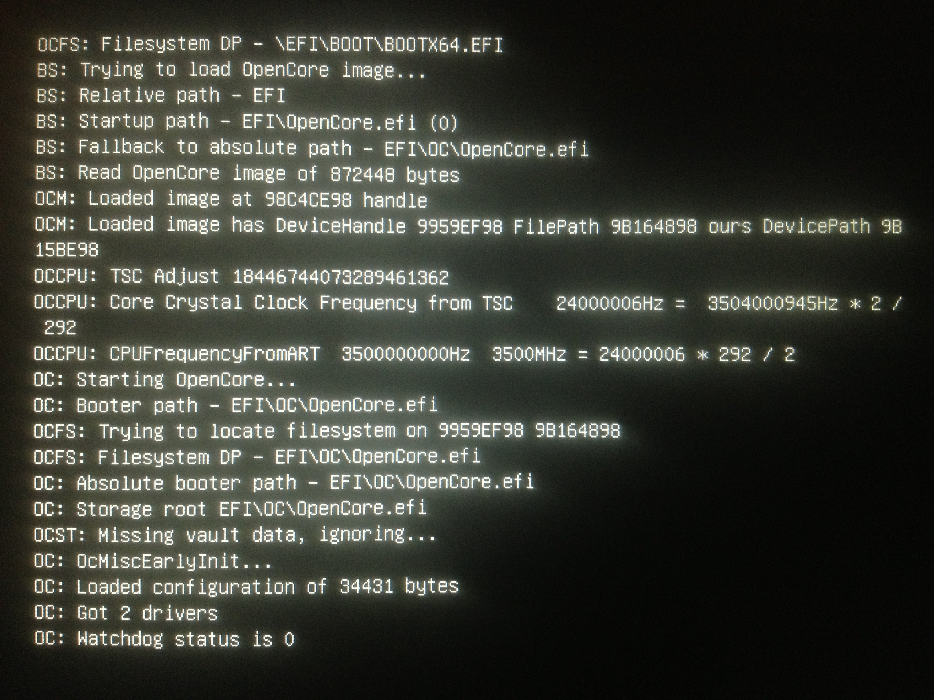

SevenTheAppleKitty Posted March 10 Share Posted March 10 not entirely sure this is the right forum section, but everyone else seems to be using it for troubleshooting. I'm trying to install MacOS (don't actually remember exactly what I downloaded from macrecovery, but i think it was tahoe) using opencore with dortania's guide, comet lake machine (Celeron G5905, 12GB RAM, GTX 1050 Ti, RTL8111, Installing to a SATA SSD) EFI and last log file attached EFI.zip opencore-2026-03-10-024623.txt 1 Link to comment https://www.insanelymac.com/forum/topic/362496-stuck-on-watchdog-status-is-0-on-boot/ Share on other sites More sharing options...
Max.1974 Posted March 10 Share Posted March 10 (edited) Maybe the issue is your GTX 1050 Ti. Pascal Nvidia GPUs are not supported in macOS Tahoe. You should disable it and use the Comet Lake iGPU instead. Edited March 10 by Max.1974 Link to comment https://www.insanelymac.com/forum/topic/362496-stuck-on-watchdog-status-is-0-on-boot/#findComment-2848058 Share on other sites More sharing options...
SevenTheAppleKitty Posted March 10 Author Share Posted March 10 1 hour ago, Max.1974 said: Maybe the issue is your GTX 1050 Ti. Pascal Nvidia GPUs are not supported in macOS Tahoe. You should disable it and use the Comet Lake iGPU instead. but i’m not even able to get to the opencore boot picker, so I can’t get to macos either way… 1 Link to comment https://www.insanelymac.com/forum/topic/362496-stuck-on-watchdog-status-is-0-on-boot/#findComment-2848059 Share on other sites More sharing options...

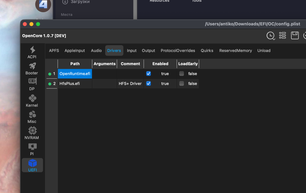

ANTIKO Posted March 10 Share Posted March 10 Try replacing the HsfPlus.efi file with HsfPlusLegacy.efi in the UEFI drivers 1 1 Link to comment https://www.insanelymac.com/forum/topic/362496-stuck-on-watchdog-status-is-0-on-boot/#findComment-2848060 Share on other sites More sharing options...

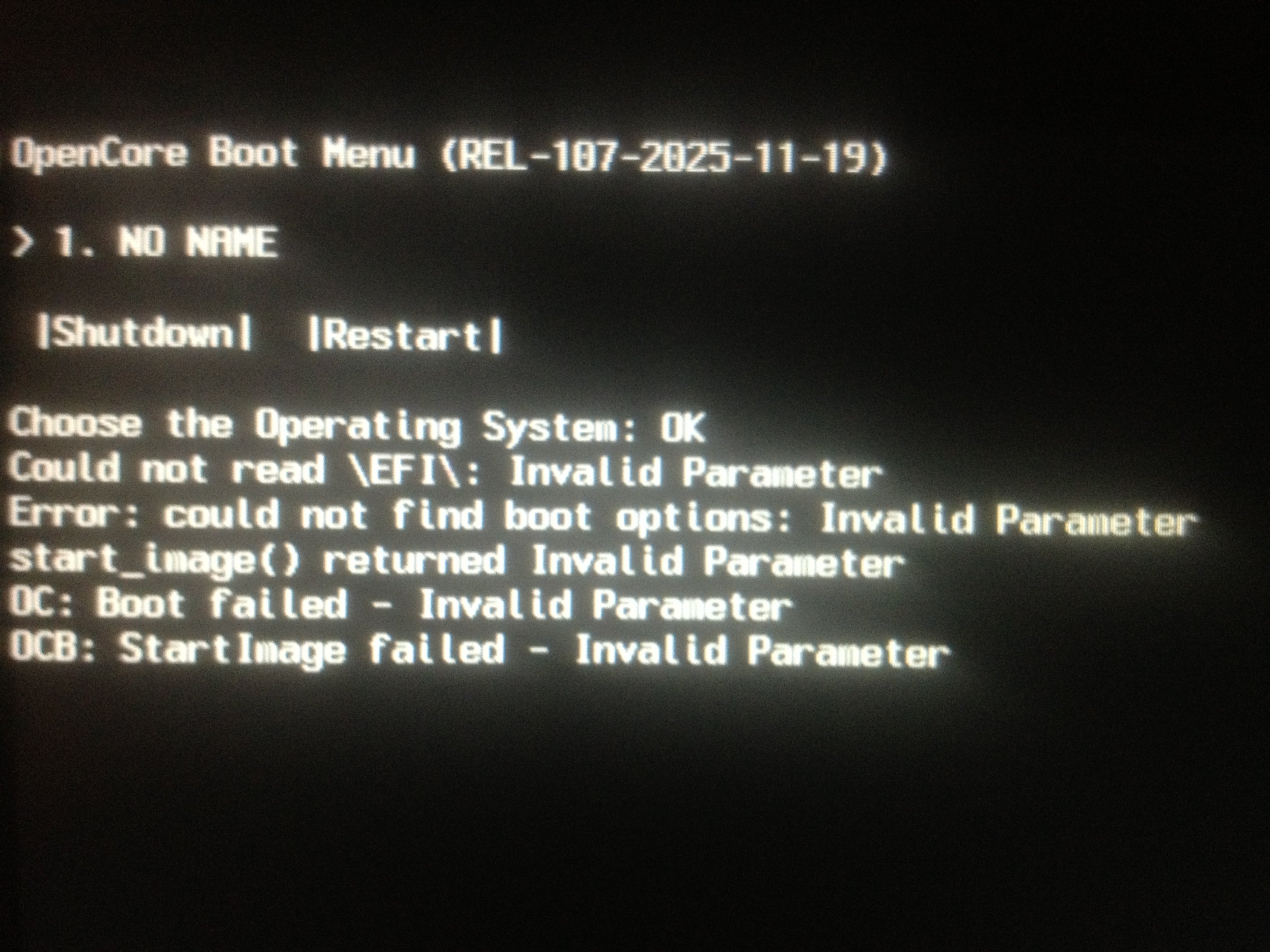

SevenTheAppleKitty Posted March 10 Author Share Posted March 10 5 hours ago, ANTIKO said: Try replacing the HsfPlus.efi file with HsfPlusLegacy.efi in the UEFI drivers This actually got the boot picker to load! although it only presents "NO NAME" and it's not bootable either it's failing real hard to boot MacOS, or it's attempting to boot my linux mint drive Link to comment https://www.insanelymac.com/forum/topic/362496-stuck-on-watchdog-status-is-0-on-boot/#findComment-2848075 Share on other sites More sharing options...
ANTIKO Posted March 11 Share Posted March 11 46 minutes ago, SevenTheAppleKitty said: Это действительно позволило загрузить загрузчик! Хотя он отображает только "NO NAME", и система не загружается. Либо система с трудом загружает macOS, либо пытается загрузить мой Linux Mint с диска. Most likely, the HsfPlusLegacy.efi driver was not registered in the config, instead of HsfPlus.efi 1 Link to comment https://www.insanelymac.com/forum/topic/362496-stuck-on-watchdog-status-is-0-on-boot/#findComment-2848077 Share on other sites More sharing options...
SevenTheAppleKitty Posted March 11 Author Share Posted March 11 3 hours ago, ANTIKO said: Most likely, the HsfPlusLegacy.efi driver was not registered in the config, instead of HsfPlus.efi I made sure to refresh my config.plist once i replaced the hfspluslegacy driver and iirc if the plist points to a nonexistant file, opencore crashes instead of getting extremely confused 1 Link to comment https://www.insanelymac.com/forum/topic/362496-stuck-on-watchdog-status-is-0-on-boot/#findComment-2848090 Share on other sites More sharing options...
Max.1974 Posted March 11 Share Posted March 11 4 hours ago, SevenTheAppleKitty said: I made sure to refresh my config.plist once i replaced the hfspluslegacy driver and iirc if the plist points to a nonexistant file, opencore crashes instead of getting extremely confused Hi, "NO NAME" seems to be an ESP partition created by Windows or Linux, so you may need to install macOS on a disk entirely formatted in APFS. My impression is that you are using Windows and macOS as a secondary partition, and you left the EFI that Windows created in the ESP (Windows ESP) instead of the macOS ESP or the native EFI partition. Format the entire disk. Post here a report from AIDA64 or Hardware Sniffer (OpenCore Simplify) so we can try to create your basic EFI. Link to comment https://www.insanelymac.com/forum/topic/362496-stuck-on-watchdog-status-is-0-on-boot/#findComment-2848095 Share on other sites More sharing options...
