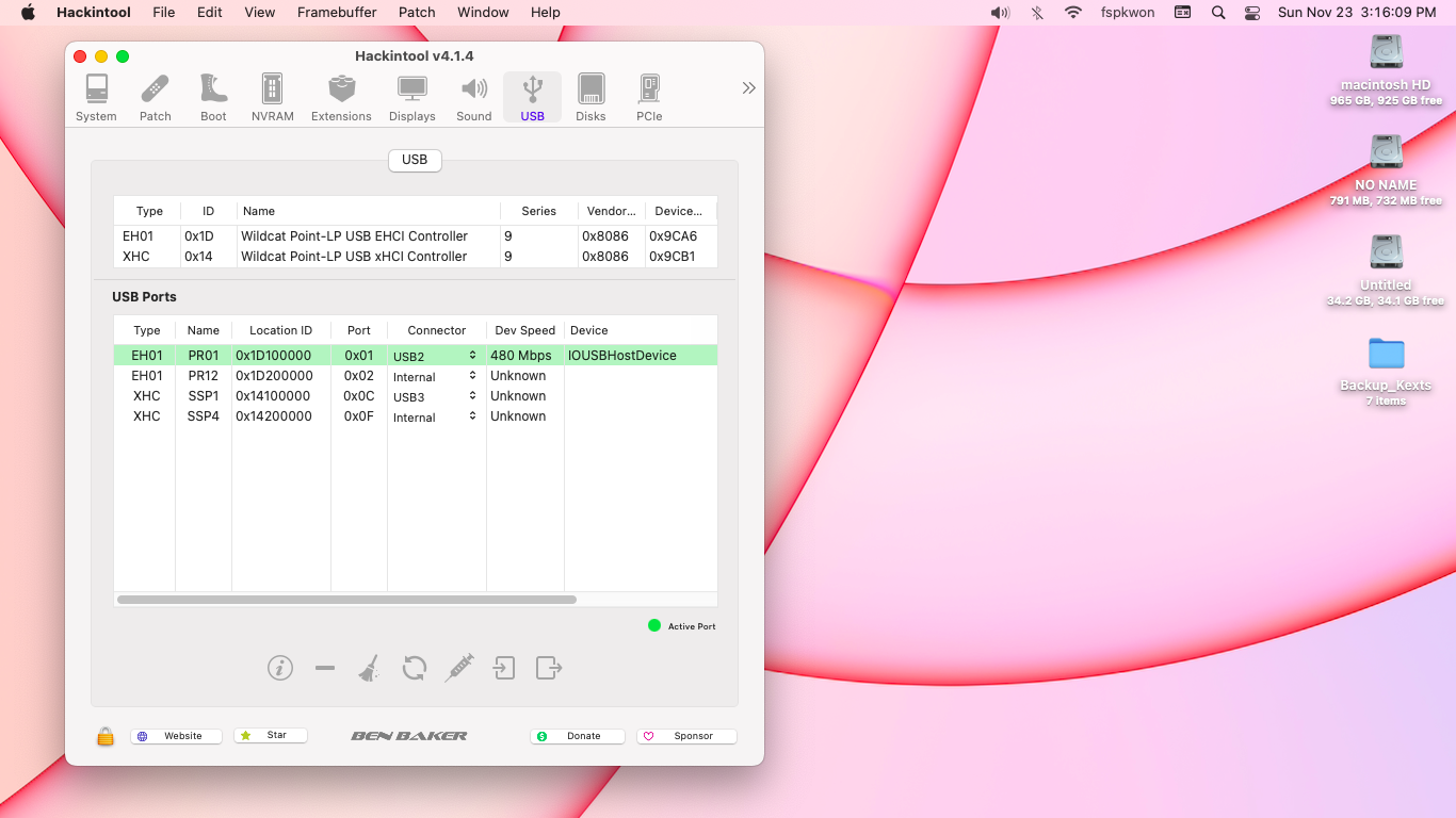

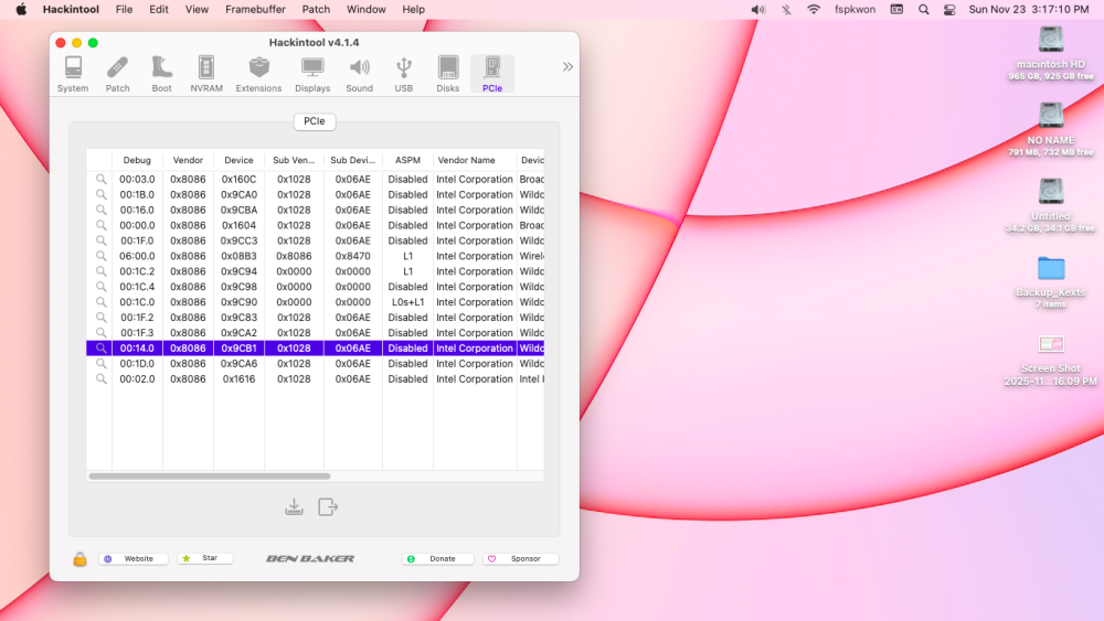

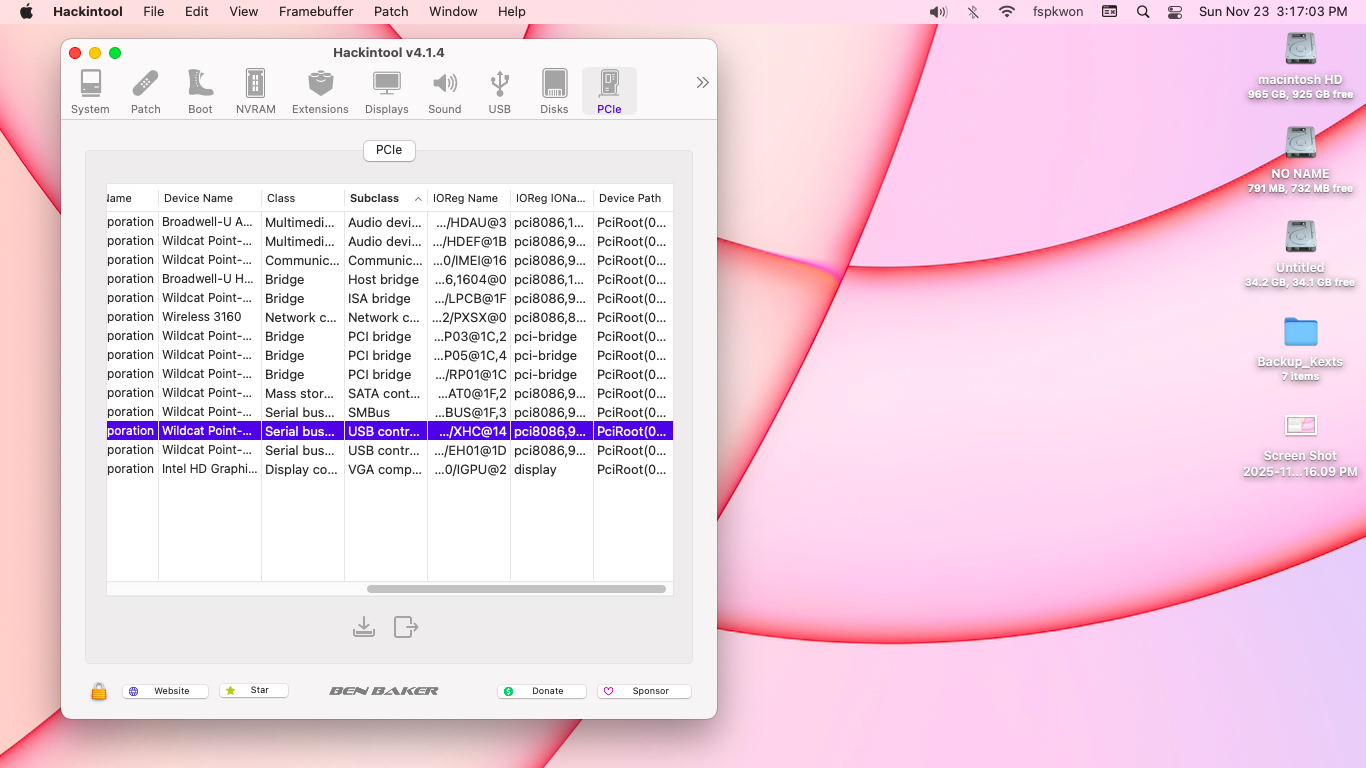

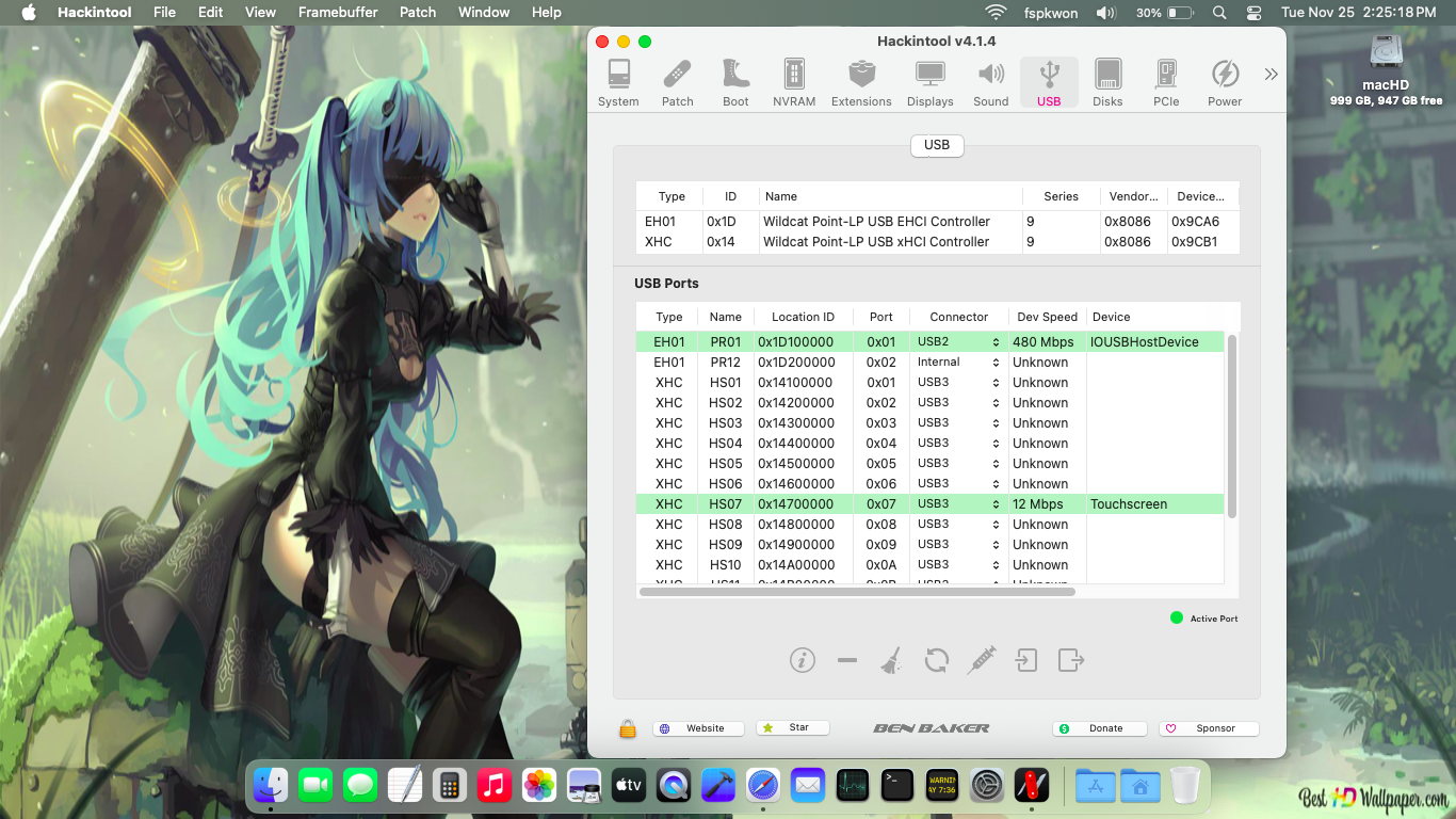

fspkwonx86 Posted November 23, 2025 Share Posted November 23, 2025 (edited) Issue as states the USB3/2 Isn't working although its SAYING its connected and detected... This would mean anything on an Internal or External USB-BUS of the laptop is not working and i do believe the ones offering the configuration didn't get it working actually..... so far I'm trying FakePCIIIDS but not editing a plist or anything, XHCI-Unsupported or FAKEPCIIDS-XHCIMux , and USBInjectAll + Various SSDT Fixes.... that are supposed to be used in conjunction to get it to work, I've tried SSD-Less and USBMap that doesn't work ALSO*... Current Method I'm using just for working ON not necessarily IS working is just changing device acpi names in opencore Would like to say its working! Its when you rename the ACPI Devices, and then acquire a set of SSDTs basically its a specific fix that opens up all the ports.. so all that's missing from this model inspiron 14 5458 there's a TON of these i assume... is CardReader, Touchscreen, and Ethernet... Did something experimental and freaking broke usb again... Update: So I updated to sequoia , still cant figure out which of what i have on here that got it working lets see here on the USB 1.0 Bus which is weird i didnt think it had one.. Has the Touchscreen and the Internal Camera is no longer getting error that it cant be detected its just a black box with no input from the driver because USB isnt working Model: Microdia.. in Dell.. Edited November 25, 2025 by fspkwonx86 Link to comment https://www.insanelymac.com/forum/topic/362000-intel-9-series-laptop-broadwell-u-wildcat-pointlp-usb-not-working-detected/ Share on other sites More sharing options...
