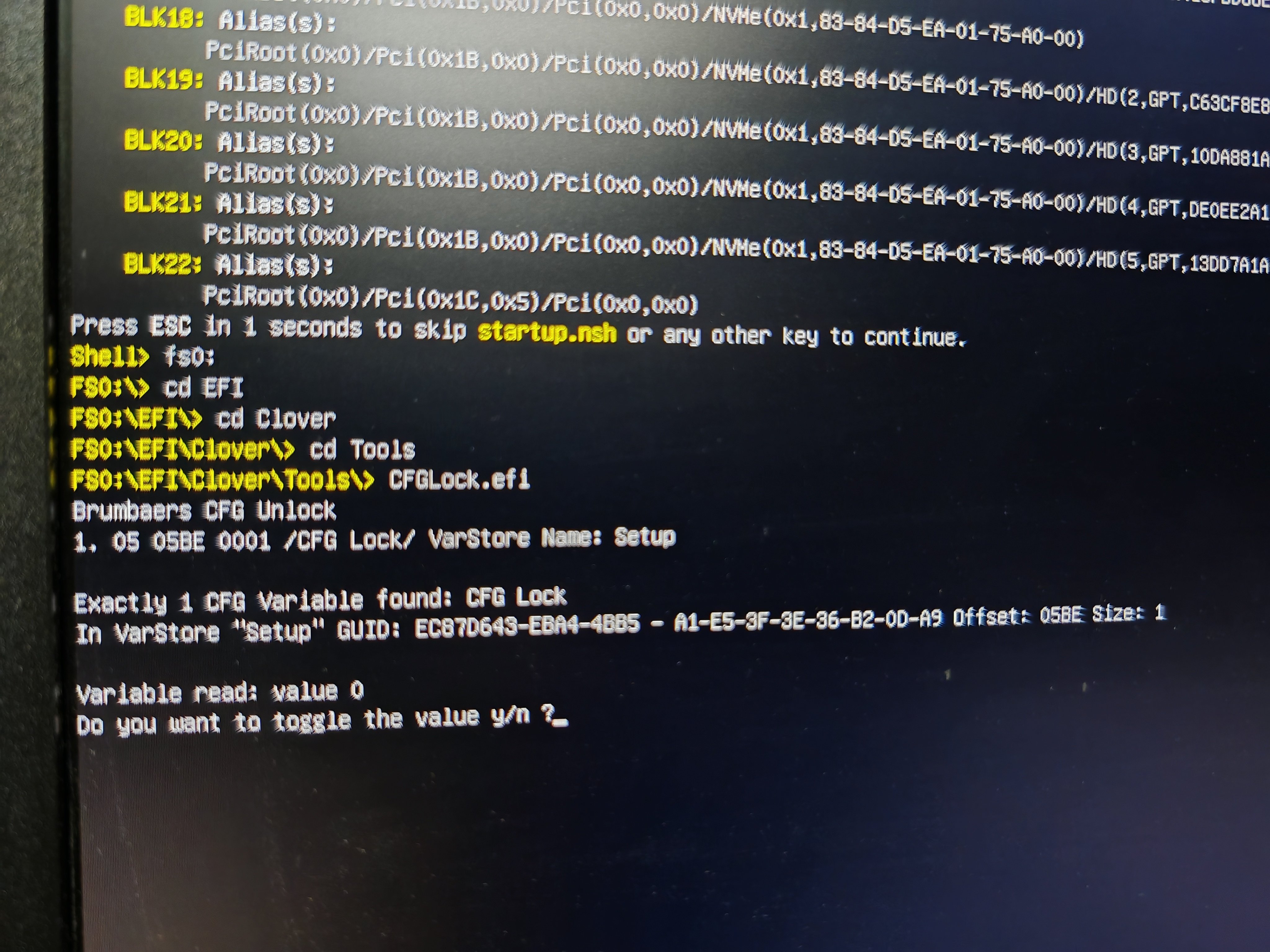

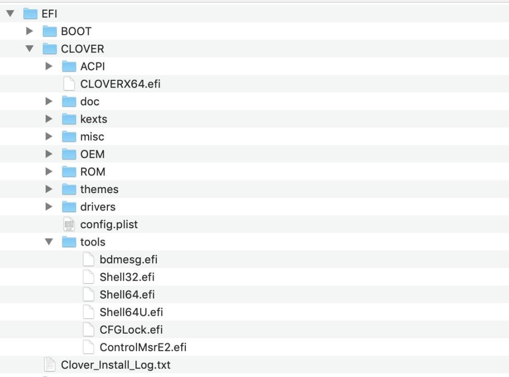

Unoxa Posted November 19, 2025 Author Share Posted November 19, 2025 Just want to add some more info on this, have taken a picture of the Clover folder on the EFI partition and of how unlocking with CFGLock.efi looks when using the UEFI shell. This might make it easier for other new users. Quote Link to comment https://www.insanelymac.com/forum/topic/361984-unlocking-dell-bios-from-uefi-shell-with-cfglockefi-using-clover-usb-installer/#findComment-2843930 Share on other sites More sharing options...
