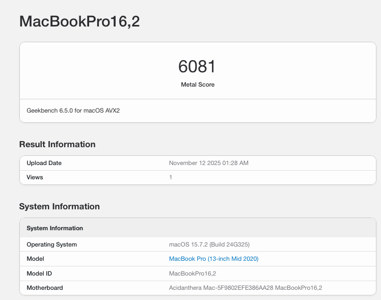

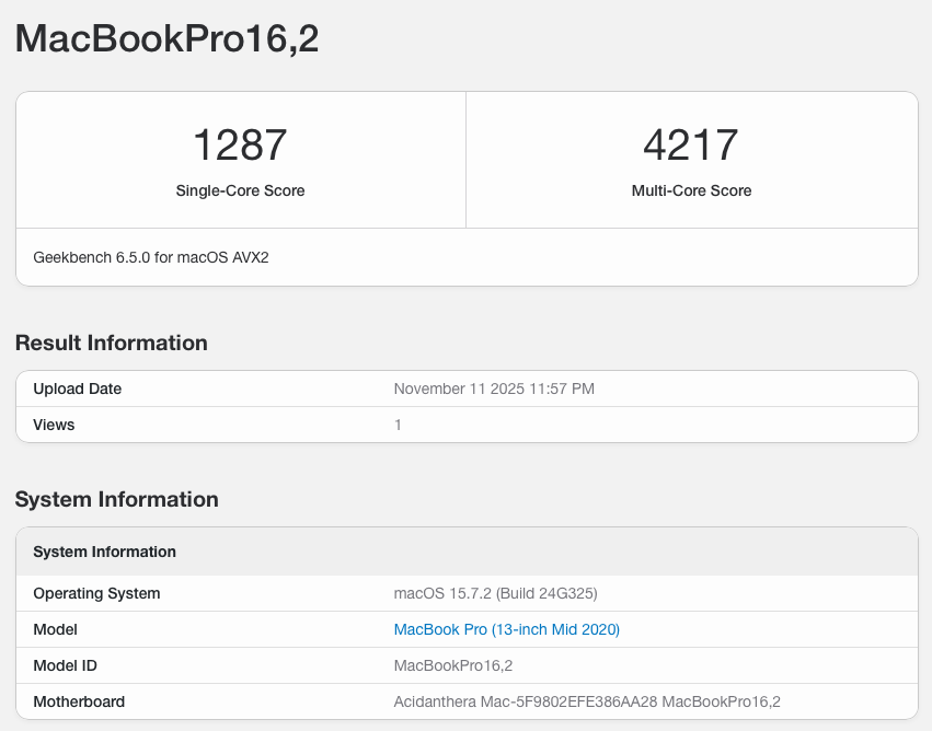

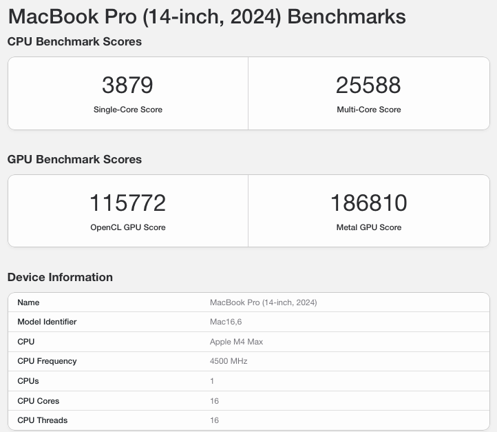

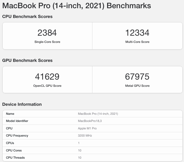

deeveedee Posted November 12, 2025 Author Share Posted November 12, 2025 (edited) This hack has respectable performance for a used, inexpensive laptop, but not anywhere near what Apple Silicon delivers. No wonder Apple dropped Intel - this 10th generation Intel CPU delivers performance no better than Intel's 8th gen. Geekbench 6 CPU: 2020 HP EliteBook 850 G7 (Intel i7-10610U) Spoiler Geekbench 6 Metal: 2020 HP EliteBook 850 G7 (Intel i7-10610U) Spoiler Geekbench 6: 2021 MacBookPro (M1) Spoiler Geekbench 6: 2024 MacBookPro (M4) Spoiler Edited November 12, 2025 by deeveedee Link to comment https://www.insanelymac.com/forum/topic/361826-need-help-fixing-wake-on-the-hp-elitebook-850-g7/page/2/#findComment-2843577 Share on other sites More sharing options...
