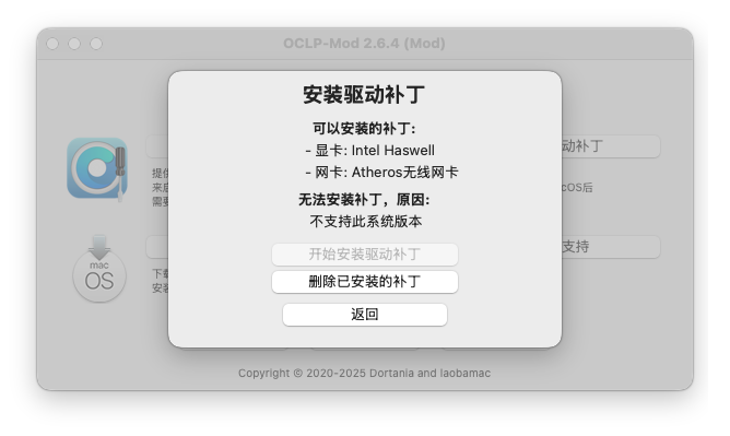

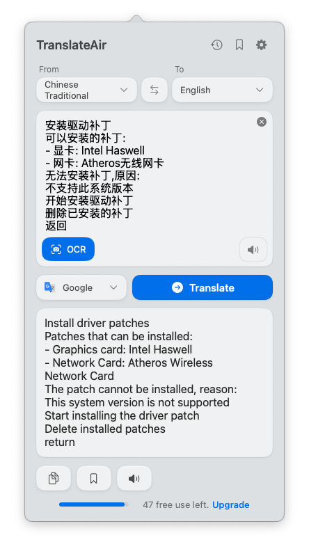

Thebes Knossos Posted September 24, 2025 Author Share Posted September 24, 2025 Tahoe installed on this old Acer E5-571 from 2015. But OLCP-Mod il not ready. No audio due to lack of AppleHda, and patches for wifi and Haswell GPU are not ready: Link to comment https://www.insanelymac.com/forum/topic/361676-solved-how-to-disable-sata-dvd-atapi-device-spamming-messages-ventura-133/page/2/#findComment-2841239 Share on other sites More sharing options...

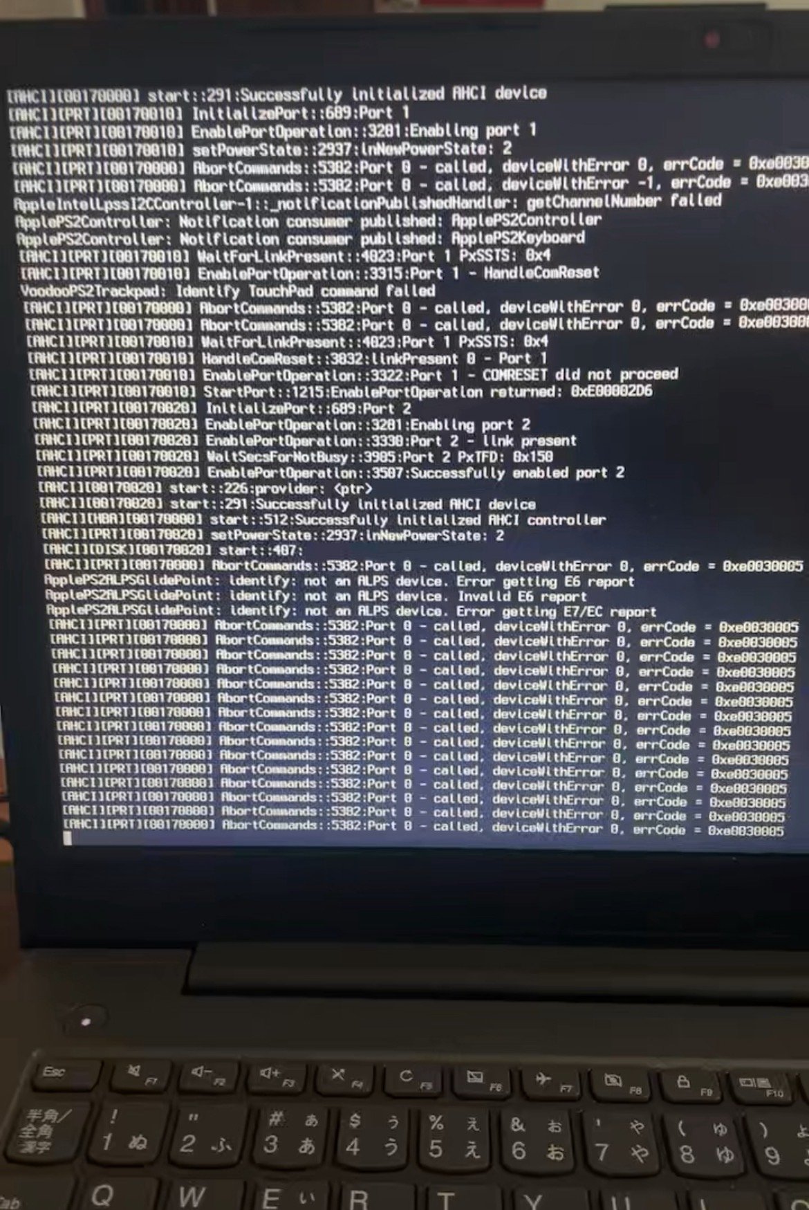

Thebes Knossos Posted October 2, 2025 Author Share Posted October 2, 2025 (edited) Back to the thread. The message comes from AppleAHCIPort::AbortCommands / IOAHCISerialATAPI packed in /system/library/kernelcollections/BootKernelExtensions.kc . Yes this Acer have an ATAPI interface, sure Apple's Mackbooks haven't such a DVD device since years. The messages form post 1 are only informative. Edited October 23, 2025 by Thebes Knossos Link to comment https://www.insanelymac.com/forum/topic/361676-solved-how-to-disable-sata-dvd-atapi-device-spamming-messages-ventura-133/page/2/#findComment-2841629 Share on other sites More sharing options...
Thebes Knossos Posted October 23, 2025 Author Share Posted October 23, 2025 (edited) Finally solved this spamming message found everywhere (dmesg, screen logs etc) They are here since Ventura 13.3 . The best patch I've made is to put a null string instead message for the iolog call. Easy with Kernel patch, thanks to Opencore : <dict> <key>Arch</key> <string>Any</string> <key>Base</key> <string></string> <key>Comment</key> <string>Disable iolog '[AHCI][PRT][%08X] %s::%d:Port %d - called'</string> <key>Count</key> <integer>1</integer> <key>Enabled</key> <true/> <key>Find</key> <data>W0FIQ0ldW1BSVF1bJTA4WF0gJXM6OiVkOlBvcnQgJWQgLSBjYQ==</data> <key>Identifier</key> <string>com.apple.driver.AppleAHCIPort</string> <key>Limit</key> <integer>0</integer> <key>Mask</key> <data></data> <key>MaxKernel</key> <string></string> <key>MinKernel</key> <string></string> <key>Replace</key> <data>AEFIQ0ldW1BSVF1bJTA4WF0gJXM6OiVkOlBvcnQgJWQgLSBjYQ==</data> <key>ReplaceMask</key> <data></data> <key>Skip</key> <integer>0</integer> </dict> Tested on Ventura 13.3+ and Sonoma. I think is ok too for Sequoia and Tahoe. Edited October 23, 2025 by Thebes Knossos 2 Link to comment https://www.insanelymac.com/forum/topic/361676-solved-how-to-disable-sata-dvd-atapi-device-spamming-messages-ventura-133/page/2/#findComment-2842694 Share on other sites More sharing options...
