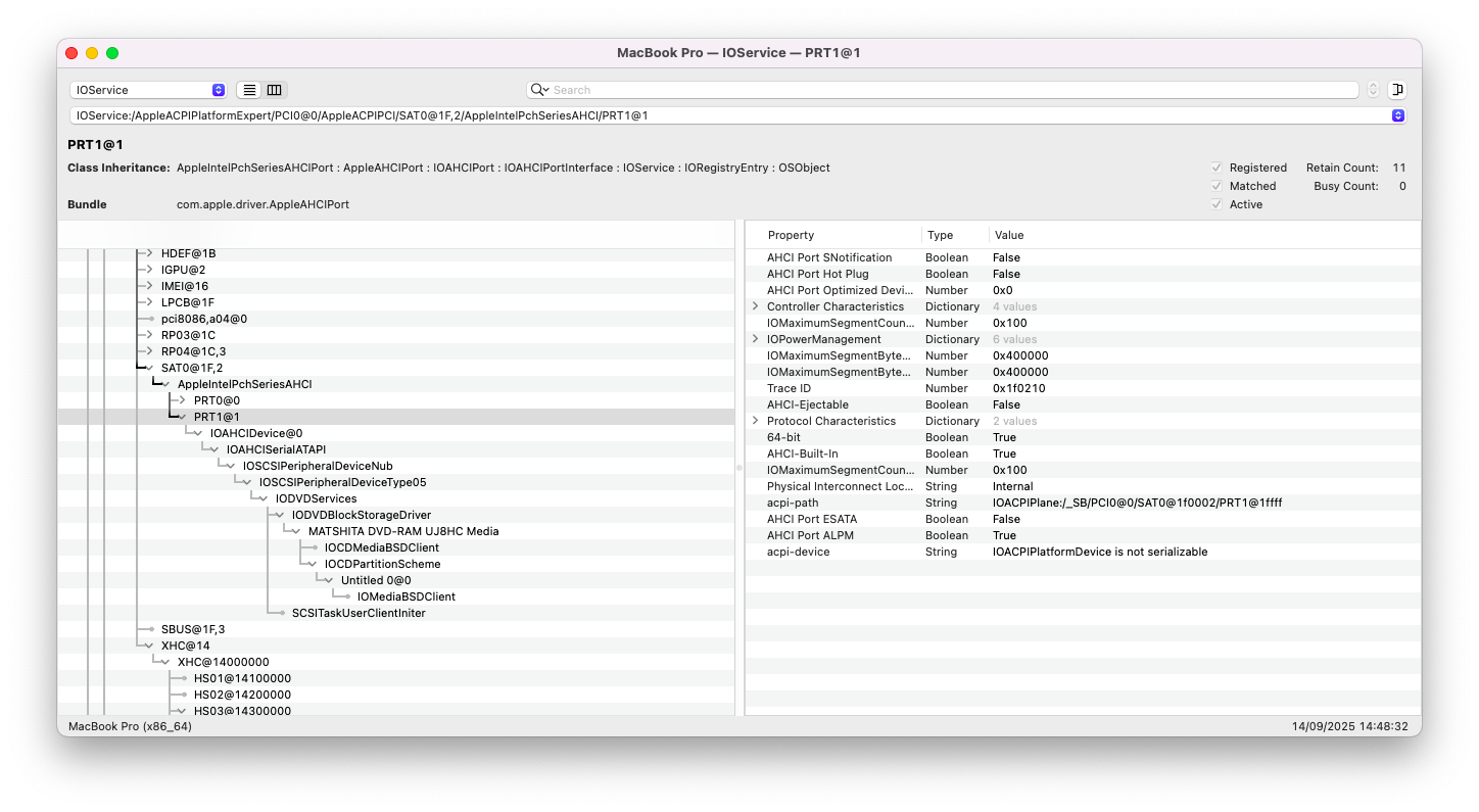

deeveedee Posted September 14, 2025 Share Posted September 14, 2025 (edited) @Thebes Knossos I think if done properly, your ACPI patch should have worked. Are you certain of the following: 1. Your SATA ACPI path is correct 2. Your SATA Device ACPI does not already have a method _STA (requiring you to rename it) If you're not certain, post your extracted original ACPI so we can inspect it. Edited September 14, 2025 by deeveedee Link to comment https://www.insanelymac.com/forum/topic/361676-solved-how-to-disable-sata-dvd-atapi-device-spamming-messages-ventura-133/#findComment-2840607 Share on other sites More sharing options...

Thebes Knossos Posted September 14, 2025 Author Share Posted September 14, 2025 (edited) OC folder you mean ? F4 extraction via Opencore dit not work. Thanks for your help. Edit Dumped with MaciASL, I don't know if it can help: System_DSDT.aml Copy of IORegistryExplorer: Edited September 15, 2025 by Thebes Knossos Link to comment https://www.insanelymac.com/forum/topic/361676-solved-how-to-disable-sata-dvd-atapi-device-spamming-messages-ventura-133/#findComment-2840615 Share on other sites More sharing options...

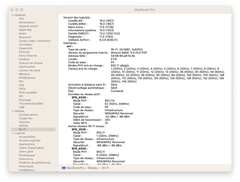

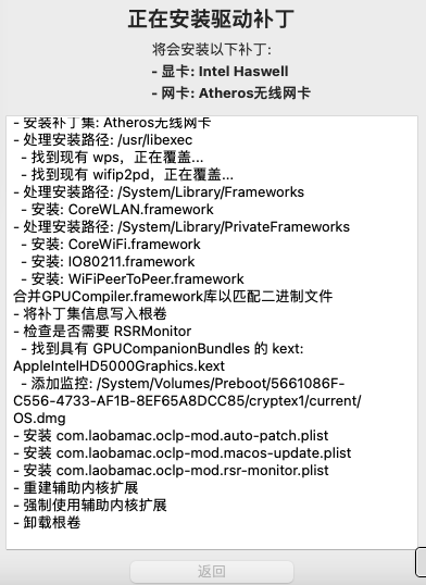

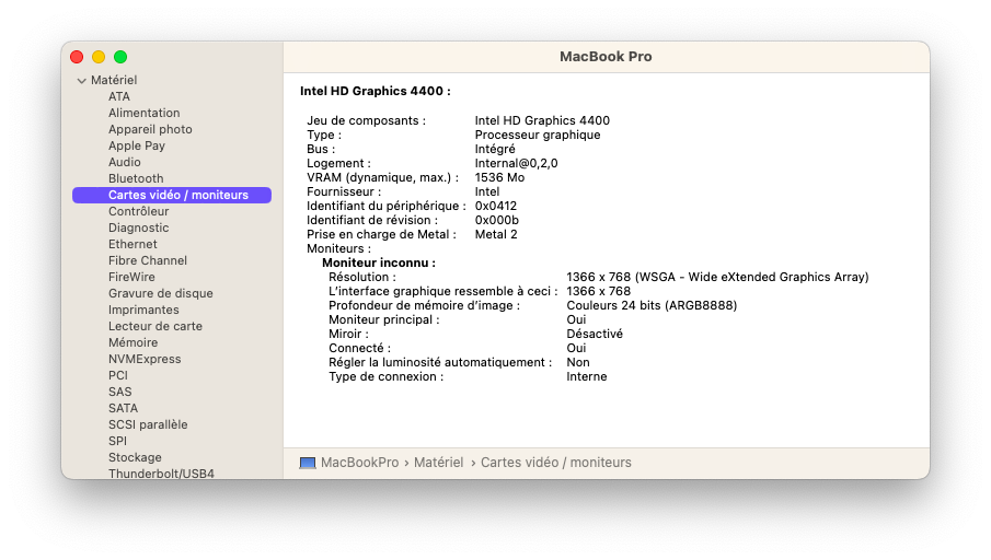

Thebes Knossos Posted September 20, 2025 Author Share Posted September 20, 2025 (edited) Yes, OLCP standard did find nothing to patch. Patch done, Métal 2 now on this old machine, Wifi 5G back (200 Mbits with speed test): Edited September 20, 2025 by Thebes Knossos Link to comment https://www.insanelymac.com/forum/topic/361676-solved-how-to-disable-sata-dvd-atapi-device-spamming-messages-ventura-133/#findComment-2840969 Share on other sites More sharing options...
deeveedee Posted September 20, 2025 Share Posted September 20, 2025 (edited) I am surprised and am learning something new. Why do you think OCLP (original) was unable to find patches for Ventura, but OCLP-Mod was able to find patches? I assume you tried OCLP 1.5.0 or later version. Edited September 20, 2025 by deeveedee Link to comment https://www.insanelymac.com/forum/topic/361676-solved-how-to-disable-sata-dvd-atapi-device-spamming-messages-ventura-133/#findComment-2840979 Share on other sites More sharing options...
Thebes Knossos Posted September 20, 2025 Author Share Posted September 20, 2025 OLCP standard detect an AcerE5-571 (not a MacBookPro14,1) and blocks here. I haven't investigate more. Olcp-mod gives possibility to patch directly, no more need to handle with sources from OLCP like here : (look complete first video at post 2). Ventura is full ready now. Good news Kodi have DRM enabled now at all . I think next year Sonoma is need for DRM with MacOS, under Linux and Windows 10 (triple boot on my computers) no such problem.. Concerning the message for port1 PRT1, It remains, including for normal boot and a new fresh Sonoma prepared USB install stick. I think i loose seconds at startup... Link to comment https://www.insanelymac.com/forum/topic/361676-solved-how-to-disable-sata-dvd-atapi-device-spamming-messages-ventura-133/#findComment-2840980 Share on other sites More sharing options...
