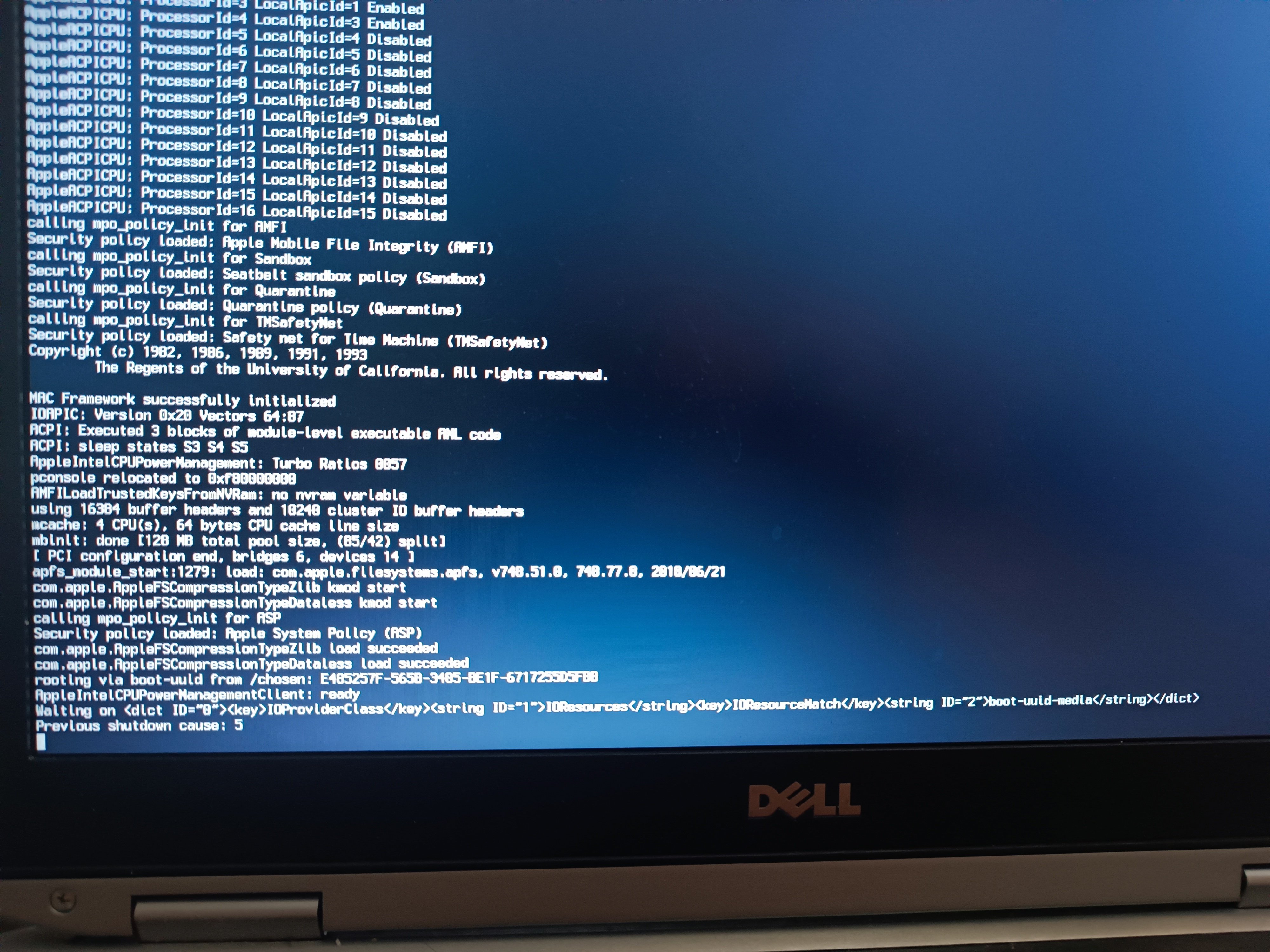

BOBOBOBOBOOBOBOB Posted August 8, 2025 Share Posted August 8, 2025 Hi guys, hope for your help, i've got a problem with installing mac os high sierra on my dell e6420 with i5-2520m and hd graphics 3000. The error is prohibited sign and logs behind. Here is my efi https://www.mediafire.com/folder/3u56uvkgtfc2z/efi 1 Quote Link to comment https://www.insanelymac.com/forum/topic/361487-mac-os-high-sierra-error-booting-installer-usb-prohibited-sign-error/ Share on other sites More sharing options...
LockDown Posted August 8, 2025 Share Posted August 8, 2025 Send pic of the verbose mode Quote Link to comment https://www.insanelymac.com/forum/topic/361487-mac-os-high-sierra-error-booting-installer-usb-prohibited-sign-error/#findComment-2838666 Share on other sites More sharing options...

LockDown Posted August 8, 2025 Share Posted August 8, 2025 11 hours ago, BOBOBOBOBOOBOBOB said: "Waiting for root device" Set to AHCI in your bios Quote Link to comment https://www.insanelymac.com/forum/topic/361487-mac-os-high-sierra-error-booting-installer-usb-prohibited-sign-error/#findComment-2838708 Share on other sites More sharing options...
