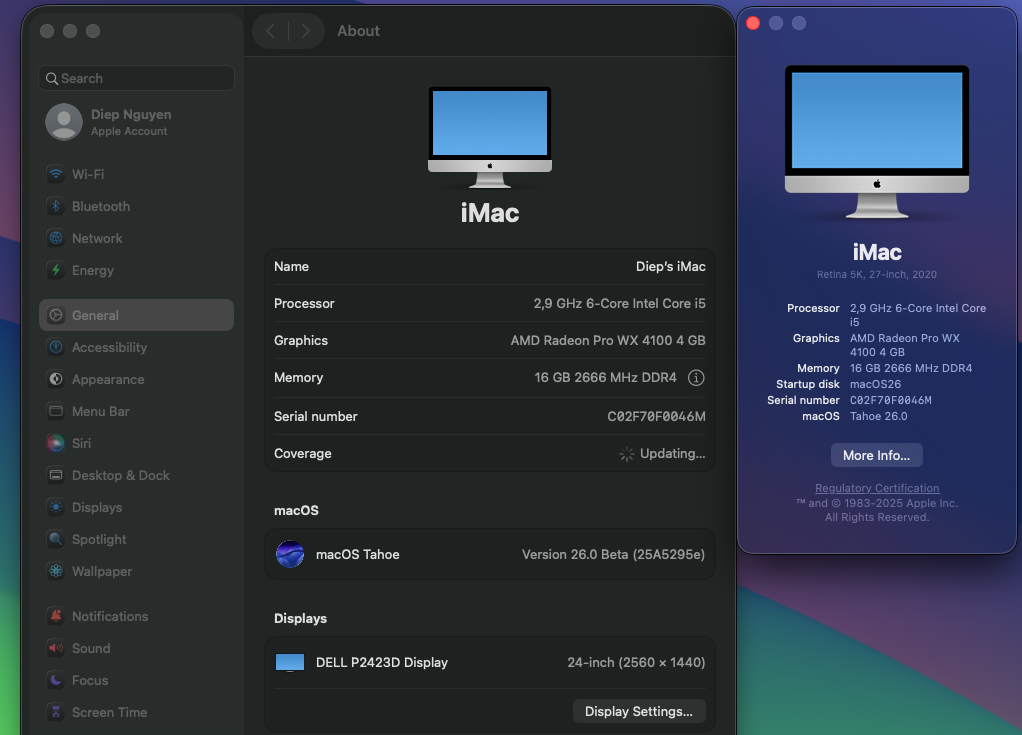

DiepNguyen Posted June 29, 2025 Share Posted June 29, 2025 Hi, I just installed Tahoe beta 2 successully on my P330 tiny so I would like to share some steps to install so anyone is struggling could follow. 1. Use an existing EFI that is working well with previous macOS 2. Upgrade Opencore 1.0.5 https://github.com/dortania/build-repo/releases and other kext on that page the mentioned for macos26. 3. Disable all the USB kexts,USBPorts.kext,USBInjectAll.kext,USBToolBox.kext,UTBMap.kext,USBMap.kext,XHCI-unsupported.kext, XhciPortLimit,etc.Use the SSDT-UIAC.aml instead.(Can be exported by Hackintool. 4. Use the attachment lilu.kext 5. edit config.plis to add SSDT-UIAC.aml and remove kexts on steps 3. 6. Change the msbios to supported msbios for tahoe And now you can install tahoe, after success, you can fig the usb also. See my attached EFI Hope it helps everyone to save time. Lilu.kext.zip OC_tahoe.zip 1 Quote Link to comment https://www.insanelymac.com/forum/topic/361255-guide-steps-to-install-tahoe/ Share on other sites More sharing options...
