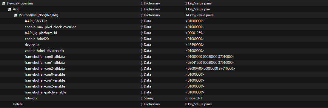

hoaug Posted June 11, 2025 Share Posted June 11, 2025 (edited) Hello everyone, Over the past few days, I’ve borrowed a Mini PC — the HP EliteDesk 800 G2 — with the following specs: CPU: i5-6600 iGPU: HD530 SSD: SN730 + an unknown-brand SATA SSD Wi-Fi: BCM4352 I attempted to Hackintosh it, and everything works quite well except for wake after sleep. The system won’t wake up once it enters sleep mode. I’ve done a lot of research in places such as: - https://www.insanelymac.com/forum/topic/359277-hp-elitedesk-800-g4-g5-mini-with-rx560x-dgpu-hackintosh/ - https://github.com/randyzhong/HP-EliteDesk-800-G2-DM-Hackintosh - https://github.com/Never2333/macos-14.5-sonoma-efi-for-hp-elitedesk-800-g4-mini-65w - https://www.insanelymac.com/forum/topic/352421-solved-black-screen-after-wake-on-hp-800-g4/ - https://www.tonymacx86.com/threads/opencore-sleep-hp-elitedesk-800-g2-mini-i5-6500.320697/ I first tried installing Sonoma, and am currently using Ventura. I’ve spent over a full day reading guides and troubleshooting, but I probably lack the expertise to solve this issue. So, I’m reaching out to ask for your help. Here's what I’ve tried so far: Attempt 1: macOS Sonoma - Sleep worked fine, but the machine couldn’t wake. - Suspecting the issue might be with the following DeviceProperties: AAPL,ig-platform-id=00001659, device-id=26590000, enable-max-pixel-clock-override=01000000 and SMBIOS set to iMac19,1 - I removed Sonoma and decided to try Ventura instead. Attempt 2: macOS Ventura - Same issue: sleep works, but wake doesn't. - I experimented with DeviceProperties like picture (also tried device-id=12590000) + SMBIOS iMac18,1 but had no success. Attempt 3: Hibernate Mode - I tried using hibernatemode=25, but the system would crash immediately when entering sleep. - I suspected RTC issues and tried the following fix: + Used RTCMemoryFixup.kext with boot args: rtcfx_exclude=58-59,B0-B3,D0-DF - still not Wake and auto restart. + Replaced those with SSDT-AWAC-HPET-RTC.aml (from the first guide above). + Also enabled DiscardHibernateMap = True and HibernateSkipsPicker = True. -> Not working at all. Attempt 4: HDMI Cable and Monitor - Thinking the issue might be related to my HDMI 2.0 cable and 180Hz Full HD monitor, I patched BusID - The patch correctly detected HDMI connector type, but unfortunately, wake still didn’t work. Boot args used in all 4 attempts: -v debug=0x100 keepsyms=1 alcid=11 -btlfxboardid igfxonln=1 -igfxhdmidivs igfxagdc=0 About BIOS Settings: I followed the initial guide, except that I couldn't enable Intel ME directly because it doesn't appear in the BIOS. But I was able to enable Active Management, so I think Intel ME is already enabled I’m at a loss for what to do next. If anyone has experience with this kind of issue, I would truly appreciate your guidance. Thank you so much in advance! Here is my EFI and DSDT, thank you. DSDT.dslEFI.zip Edited June 11, 2025 by kinhhoang161 fix typo Quote Link to comment https://www.insanelymac.com/forum/topic/361175-cant-make-sleep-working-on-hd530-hp-elitedesk-800-g2/ Share on other sites More sharing options...
HmO Posted June 11, 2025 Share Posted June 11, 2025 (edited) @kinhhoang161 Sky Lake and Kaby Lake in macOS do not wake up from sleep mode, requires discrete AMD RX graphics. Edited June 11, 2025 by HmO Quote Link to comment https://www.insanelymac.com/forum/topic/361175-cant-make-sleep-working-on-hd530-hp-elitedesk-800-g2/#findComment-2833193 Share on other sites More sharing options...
hoaug Posted June 11, 2025 Author Share Posted June 11, 2025 @HmO Thank you for replying to me. That’s truly unfortunate news. Is there really no other way besides installing a dedicated graphics card? Like maybe using hibernate mode or something? Quote Link to comment https://www.insanelymac.com/forum/topic/361175-cant-make-sleep-working-on-hd530-hp-elitedesk-800-g2/#findComment-2833203 Share on other sites More sharing options...
PoMpIs Posted June 12, 2025 Share Posted June 12, 2025 (edited) No, there isn't, if it goes into sleep mode the HD530 doesn't show any image again... I had that iGPU for a few months years ago and the same thing happened to me. 😄 Edited June 12, 2025 by PoMpIs Quote Link to comment https://www.insanelymac.com/forum/topic/361175-cant-make-sleep-working-on-hd530-hp-elitedesk-800-g2/#findComment-2833288 Share on other sites More sharing options...
hoaug Posted June 12, 2025 Author Share Posted June 12, 2025 @PoMpIs So, so, so sad… haizz. Everything works, but only Wake says no. Thank you for the information-I'll just forget it Quote Link to comment https://www.insanelymac.com/forum/topic/361175-cant-make-sleep-working-on-hd530-hp-elitedesk-800-g2/#findComment-2833329 Share on other sites More sharing options...
