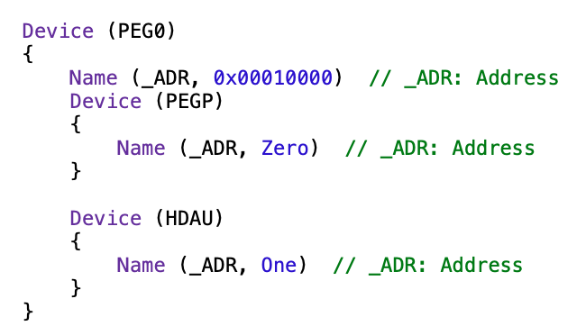

FirstCustomac Posted January 23, 2025 Share Posted January 23, 2025 (edited) @kaoskinkae What I needed to disable HDMI audio. Combination of SSDT and "DeviceProperty" mentioned by @miliuco RX 580 Spoiler RX 6600XT Spoiler From my testings for RX 6600XT, either of nullifying "device-id" or "class-code" will disable HDMI audio, but for my RX 580, device-id must be altered. One thing for sure though that using "DeviceProperty" method requires ACPI device for external dGPU's HDMI audio to be present or defined in order to achieve this specific goal. This can be done by simply creating HDAU device under ACPI path of a GPU namely PEG0 or PEG1 for Polaris GPUs. Edited January 23, 2025 by FirstTimeCustomac 1 Link to comment https://www.insanelymac.com/forum/topic/360473-how-can-i-disable-audio-output-from-gpu-polaris-rx560-aa/page/2/#findComment-2829869 Share on other sites More sharing options...
kaoskinkae Posted January 23, 2025 Author Share Posted January 23, 2025 6 hours ago, FirstTimeCustomac said: @kaoskinkae Lo que necesitaba para desactivar el audio HDMI. Combinación de SSDT y "DeviceProperty" mencionada por@miliuco RX 580 Revelar contenidos ocultos RX6600XT Revelar contenidos ocultos Según mis pruebas para RX 6600XT, anular "device-id" o "class-code" deshabilitará el audio HDMI, pero para mi RX 580, se debe alterar el device-id. Sin embargo, una cosa es segura: el uso del método "DeviceProperty" requiere que el dispositivo ACPI para el audio HDMI de la dGPU externa esté presente o definido para lograr este objetivo específico. Esto se puede hacer simplemente creando un dispositivo HDAU en la ruta ACPI de una GPU, es decir, PEG0 o PEG1 para las GPU Polaris. Now I understand why the combination of my SSD only with the "HDAU" section. Combined with the deviceproperties, it works, it needs to create the device to be able to be canceled in my case when a fake HDMI audio device from the RX560 is created by using a VGA-HDMI converter. that includes USB audio power connector creates said fake audio device Link to comment https://www.insanelymac.com/forum/topic/360473-how-can-i-disable-audio-output-from-gpu-polaris-rx560-aa/page/2/#findComment-2829878 Share on other sites More sharing options...
