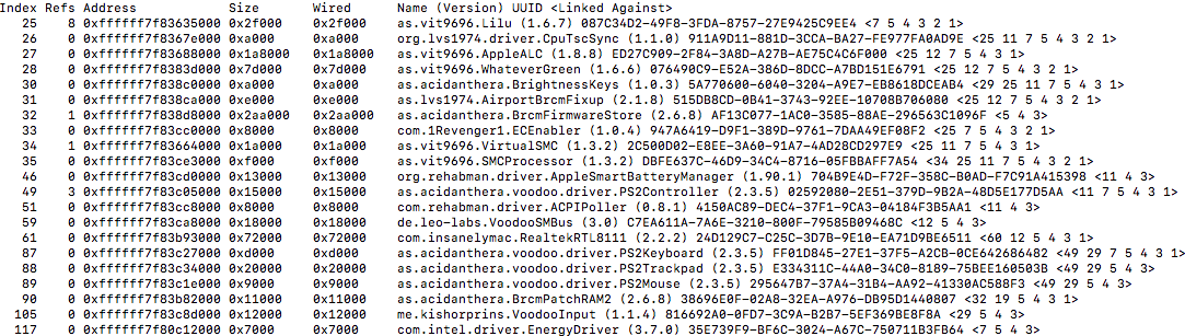

Fortitude Posted October 3, 2024 Author Share Posted October 3, 2024 (edited) Hi @1Revenger1, thanks for taking the time to do this! I apologize for getting back this late, I only saw your message today. I tested the zip file that you sent, and it seems to fix the prelinking issue. However, I’m still encountering the same problem with VoodooRMI/RMISMBus not loading or appearing in IOReg. I've tried it on macOS Sierra, High Sierra, Catalina, and Big Sur, but unfortunately, it hasn’t worked on any of those versions. Thank you once again for your help! I really appreciate the effort you’ve put into reworking everything based on the pull requests. I noticed they’re still open, and I have a GitHub account if you’d prefer me to reach out there. Edited October 3, 2024 by Fortitude Link to comment https://www.insanelymac.com/forum/topic/359963-rmismbuskext-not-being-loaded/#findComment-2826143 Share on other sites More sharing options...

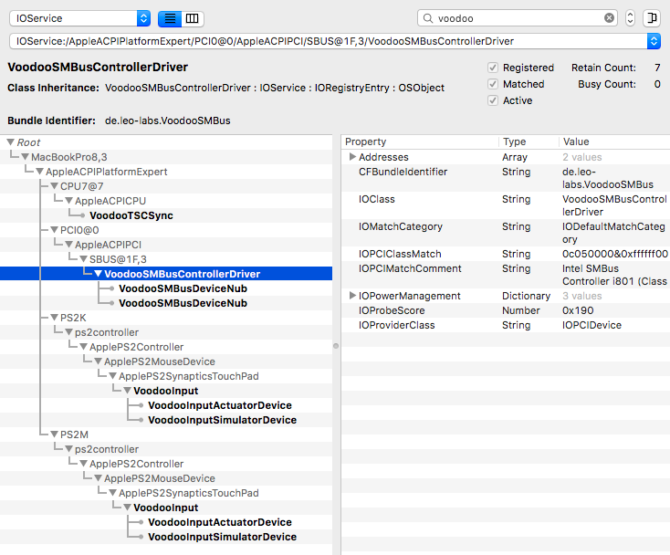

Avery B Posted October 4, 2024 Share Posted October 4, 2024 Do you have a copy of your Io registry you can send? Should see ApplePS2SMBusDevice on the PS2 controller. Link to comment https://www.insanelymac.com/forum/topic/359963-rmismbuskext-not-being-loaded/#findComment-2826146 Share on other sites More sharing options...

Fortitude Posted October 4, 2024 Author Share Posted October 4, 2024 Attached is my IOReg file along with other relevant files for macOS Sierra. I can provide files for Big Sur as well, but 10.12.6 is literally the only version of macOS that runs properly on my laptop. (This is because the Fermi graphics card that the laptop comes with is an absolute pain, but it's an MXM card so I'm hoping I'll be able to upgrade it in the future.) Fortitudes-MBP.lan.ioreg KernelLog.txt KextloadLog.txt KextstatFull.txt KextstatLog.txt opencore-2024-10-04-030158.txt Link to comment https://www.insanelymac.com/forum/topic/359963-rmismbuskext-not-being-loaded/#findComment-2826149 Share on other sites More sharing options...
Avery B Posted October 4, 2024 Share Posted October 4, 2024 (edited) Looks like the touchpad does not report that the SMBus interface is supported. Do you mind giving this copy of VoodooPS2 a try in addition to the kexts I gave above? It just forces VoodooPS2 to follow the path it would take if it detected an SMBus capable touchpad. VoodooPS2Controller-2.3.6-DEBUG.zip diff --git a/VoodooPS2Trackpad/VoodooPS2SynapticsTouchPad.cpp b/VoodooPS2Trackpad/VoodooPS2SynapticsTouchPad.cpp index f8cdf8e..be8fb61 100644 --- a/VoodooPS2Trackpad/VoodooPS2SynapticsTouchPad.cpp +++ b/VoodooPS2Trackpad/VoodooPS2SynapticsTouchPad.cpp @@ -205,7 +205,7 @@ IOService* ApplePS2SynapticsTouchPad::probe(IOService * provider, SInt32 * score // Attempt to start SMBus Companion. If succesful, attach a stub PS/2 driver. // IOService *resources = getResourceService(); - if (_cont_caps.intertouch && resources && resources->getProperty(_smbusCompanion)) { + if (/*_cont_caps.intertouch && */ resources && resources->getProperty(_smbusCompanion)) { // Helpful information for SMBus drivers OSDictionary *dictionary = OSDictionary::withCapacity(2); dictionary->setObject("TrackstickButtons", _securepad.trackstick_btns ? Edited October 4, 2024 by 1Revenger1 Link to comment https://www.insanelymac.com/forum/topic/359963-rmismbuskext-not-being-loaded/#findComment-2826150 Share on other sites More sharing options...
Fortitude Posted October 4, 2024 Author Share Posted October 4, 2024 (edited) According to the kernel log, VoodooRMI and RMISMBus are now loading, but there’s an error when attempting to read the SMBus version. I thought my trackpad would support SMBus, but I'm starting to wonder if I could be wrong about this? Unless there's a method to the madness, I'm baffled because VoodooSMBus seems to load. Fortitudes-MBP.lan.ioreg KernelLog.txt KextloadLog.txt KextstatFull.txt KextstatLog.txt opencore-2024-10-04-061352.txt Edited October 4, 2024 by Fortitude Link to comment https://www.insanelymac.com/forum/topic/359963-rmismbuskext-not-being-loaded/#findComment-2826152 Share on other sites More sharing options...
Avery B Posted October 4, 2024 Share Posted October 4, 2024 VoodooSMBus is just for the i801 SMBus controller in the PCH and won't talk to the touchpad on its own, so I'm not surprised that it is attaching. I am surprised that the version can't be found though. I am guessing it might be an older device which is not supported by the driver unfortunately. I don't have a good way to test that though. Link to comment https://www.insanelymac.com/forum/topic/359963-rmismbuskext-not-being-loaded/#findComment-2826162 Share on other sites More sharing options...

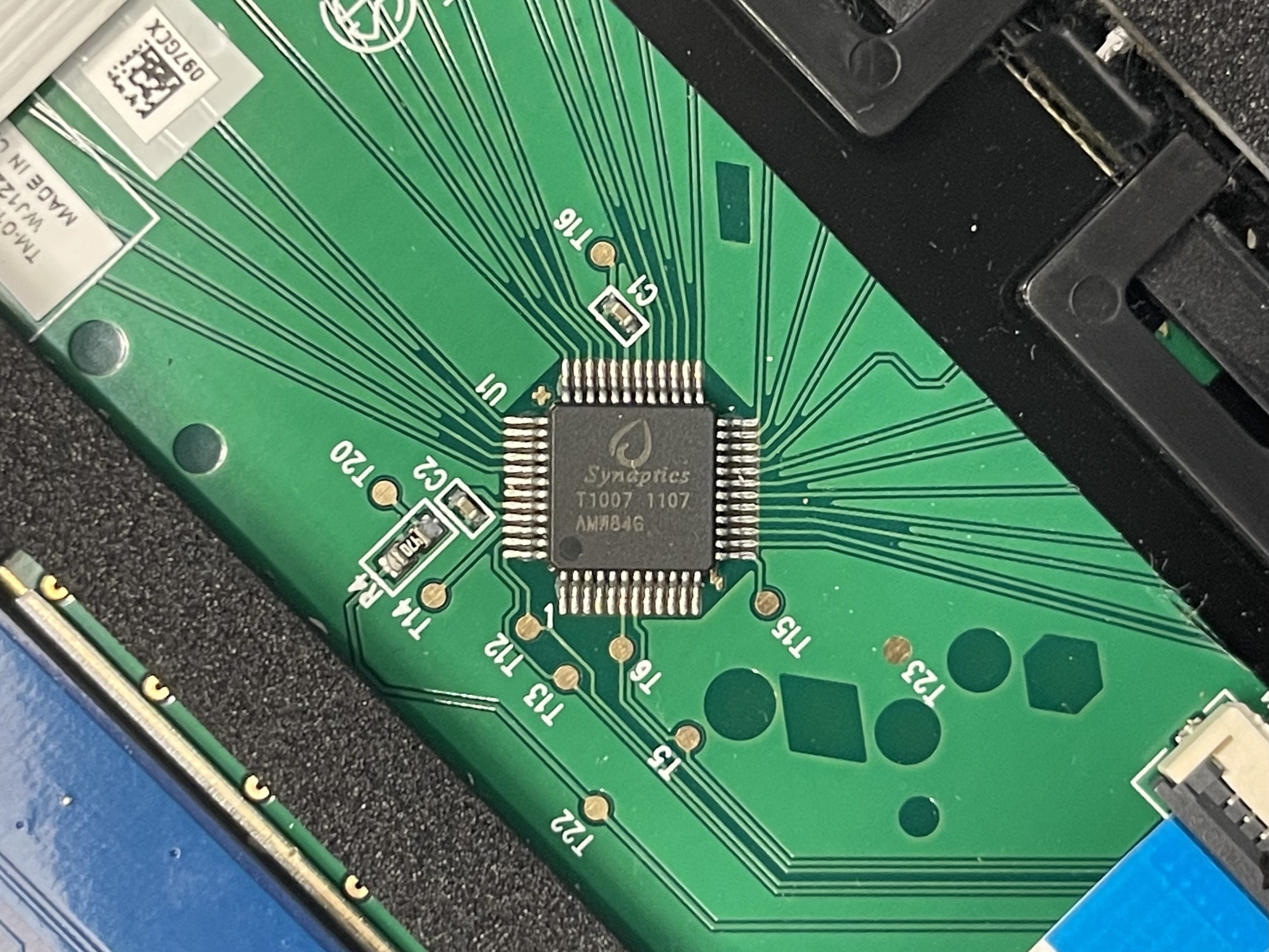

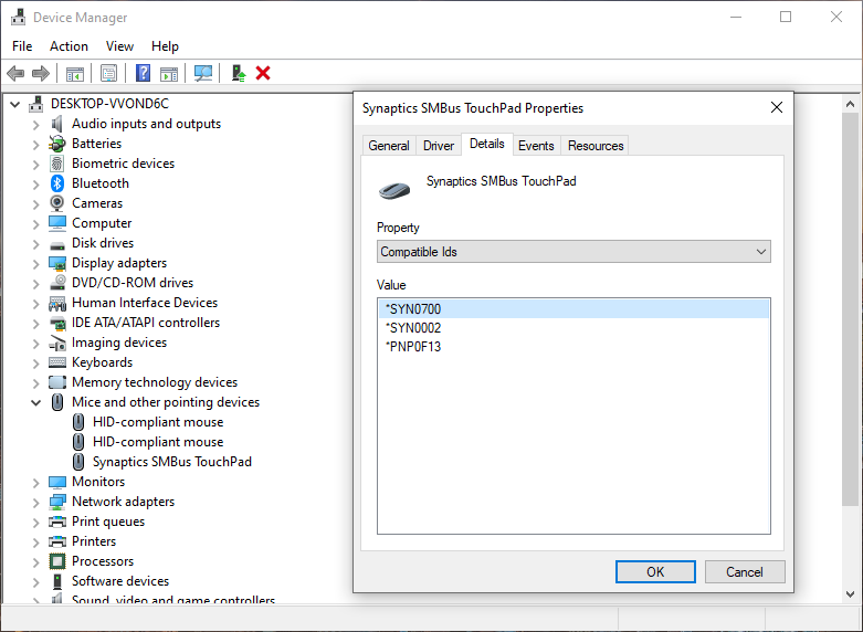

Fortitude Posted October 4, 2024 Author Share Posted October 4, 2024 I’m starting to think that my trackpad might honestly just be PS/2. I apologize if I’ve wasted your time with this—I'm not sure why it shows up as an SMBus touchpad in Device Manager on Windows. Would it be okay if I tested the zip file you sent on my Alienware laptop? I know your kext is compatible with it. Link to comment https://www.insanelymac.com/forum/topic/359963-rmismbuskext-not-being-loaded/#findComment-2826163 Share on other sites More sharing options...

Fortitude Posted October 7, 2024 Author Share Posted October 7, 2024 I’ll see what I can do, though I might need some time to get familiar with your code. Regarding the Qosmio’s trackpad, it’s PS/2. I found a manual over the weekend for my laptop (which should’ve been on Dynabook’s website) that confirms it uses PS/2. I then downloaded a program from Synaptics to configure the trackpad on Windows, which verifies this. According to the Synaptics website, ClickPads can connect through PS/2, Intertouch, I2C, and USB (but not SMBus). It seems my SMBus driver in Windows contains the PS/2 protocol code. I’m not sure if there’s an exclusive PS/2 driver for my trackpad, but I’ve finally made sense of this confusing situation. Link to comment https://www.insanelymac.com/forum/topic/359963-rmismbuskext-not-being-loaded/#findComment-2826274 Share on other sites More sharing options...
