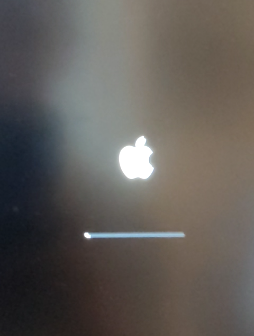

Guys I'm literally crying right now... It booted!
There are some problems tho..
  • The trackpad doesn't work (But the keyboard does, yay!)
  • The wifi card doesn't work (Probably because I'm booting Ventura with the wrong Airportitlwm next, will try on Sonoma, by the way it's a Killer Wi-Fi 6 AX1650i)  -fixed on sonoma

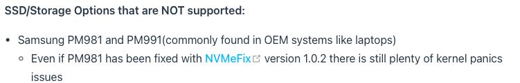

  • The internal NVMe isn't showing up in disk utility (i used nvmefix but it still won't show up. The disk is part of the pm981a family, so it was kinda to-be-expected, but can i fix it? Some people on reddit managed to fix it following a chinese guide but i dont speak chinese and google translate from chinese to italian is very bad...)
You can install it on a different disk and then clone it. However, it will most likely not work stably.

@strangeron I was hoping to use this guide to fix my problem: https://mrmad.com.tw/fix-hackintosh-liteon-plextor-skhynix-m2-ssd

1 hour ago, ArtikDiamond said:
Edit: it's a Clover patch :,(
Doesn't matter Clover or Opencore. What is done is to install on a different disk and then prepare the Samsung PM981 disk and clone the system to this disk.
The job done on the page is to make the Samsung PM981 ready for cloning with two kexts and an SSDT showing the SSD path.
SSDT and kexts can also be used with OpenCore. However, I do not know if it will be a stable system.
