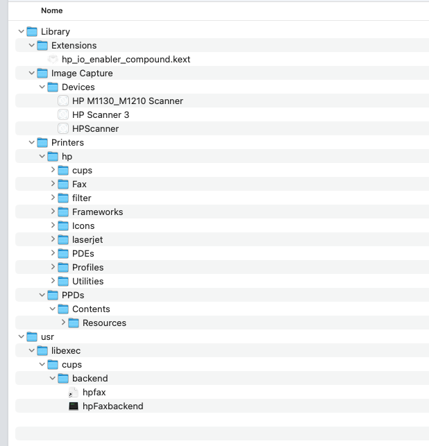

Max.1974 Posted July 7, 2024 Share Posted July 7, 2024 A long time ago I find a solution to back up my drivers folder, and I never had issues. To me always work backup this folders from last compatible macOs. BTW your drivers is in folder 2 Link to comment https://www.insanelymac.com/forum/topic/359650-hp-laserjet-2100-pcl-printer-jetdirect-installation-in-macos-sequoia/#findComment-2822386 Share on other sites More sharing options...

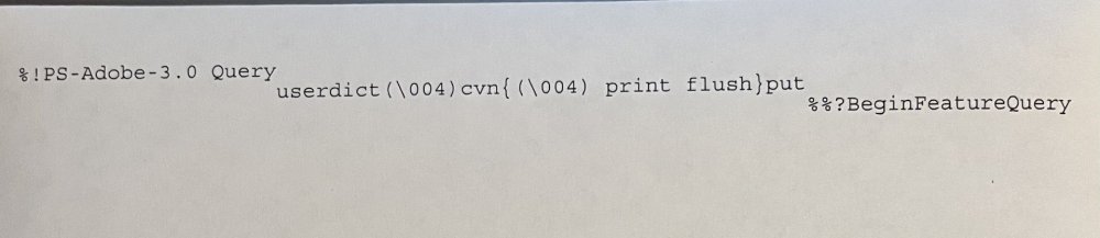

deeveedee Posted July 7, 2024 Author Share Posted July 7, 2024 (edited) @Max.1974 I appreciate your persistence. I did test the LaserJet 2100 Driver. It is a PostScript driver that does not work with my printer. EDIT: This is the text that appears at the top of one of the pages when I attempt to print to my LaserJet 2100 with the driver you referenced. This clearly shows that the driver is attempting to issue a PostScript command to my printer. I'm not concerned about the PostScript incompatibility, because the Generic PCL driver works very well. EDIT2: I found this option in a LaserJet 2100 Service Manual: PostScript™ Level 2 Emulation (PS) DIMM. Factory installed on the 2100 M and 2100 TN. Apparently, the LaserJet 2100 offers a PostScript Emulation option that my LaserJet 2100 does not have. Since my printer was originally used only in a Windows environment, this does not surprise me. Edited July 8, 2024 by deeveedee 2 Link to comment https://www.insanelymac.com/forum/topic/359650-hp-laserjet-2100-pcl-printer-jetdirect-installation-in-macos-sequoia/#findComment-2822388 Share on other sites More sharing options...
