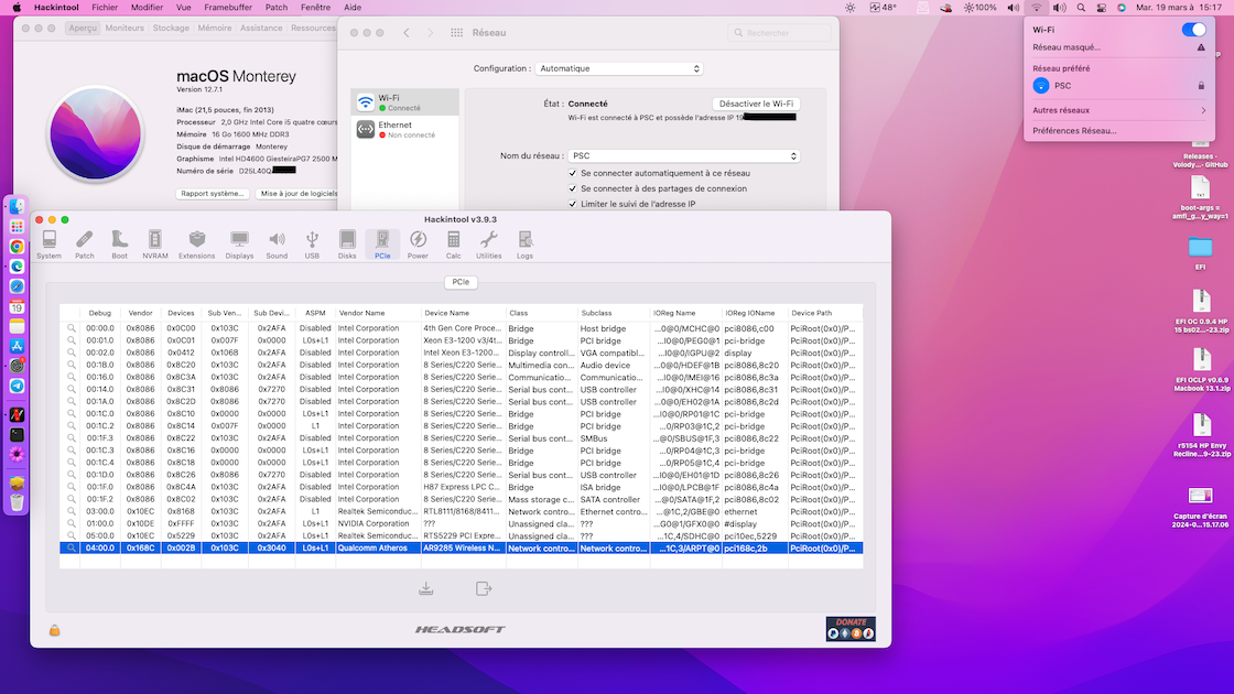

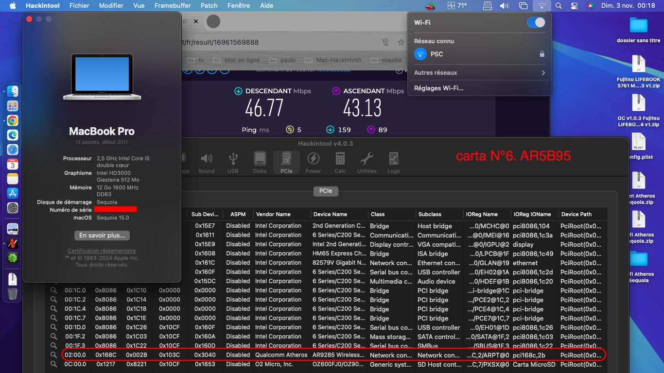

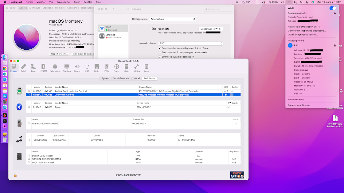

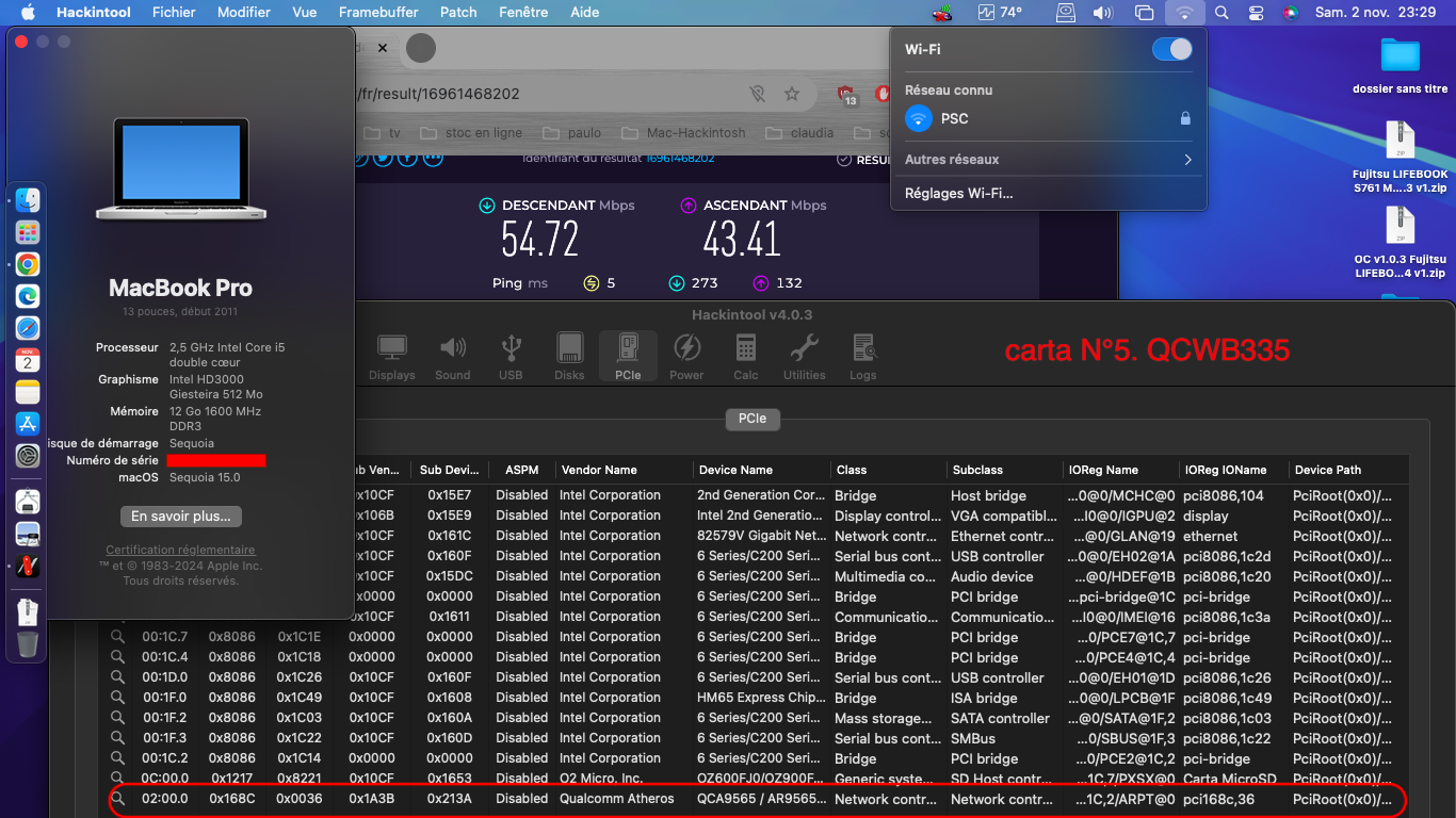

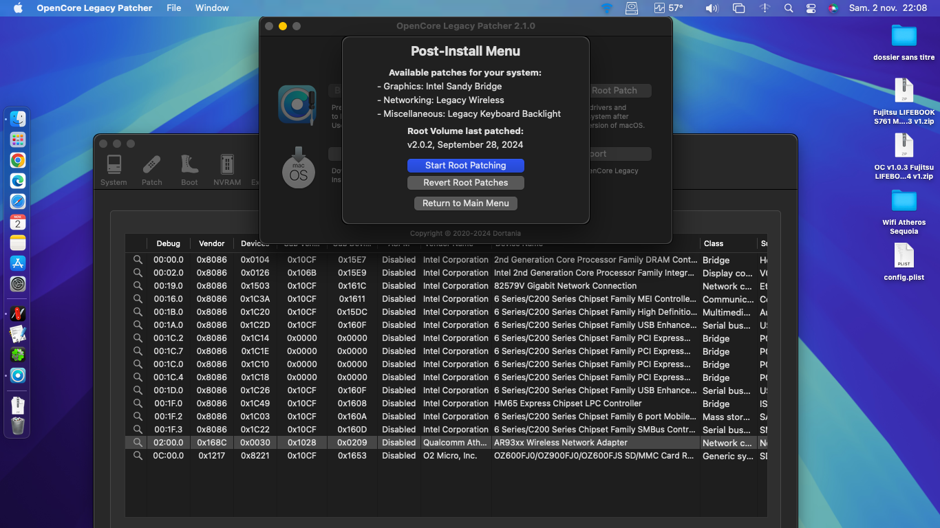

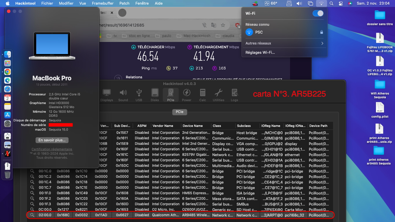

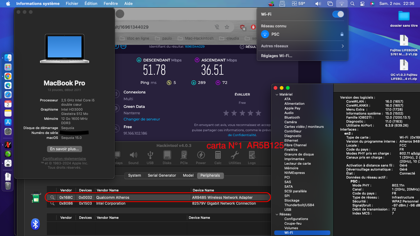

PG7 Posted March 19, 2024 Share Posted March 19, 2024 (edited) "toturial to come" OCLP patch Kext ElCapitan - used here 5T33Z0 - Change PlugIns AirPortAtheros40.kext version ElCaptian chunnann exchange info.plist : com.apple.iokit.IO80211Family com.apple.iokit.IO80211ElCap Delete: _CodeSignature + Version.plist (Thanks Jonas Wander) BootLoader Clover r5157 Update Sequoia Metode Update Video Youtube Spoiler Edited November 26, 2024 by PG7 2 Link to comment https://www.insanelymac.com/forum/topic/359007-wifi-atheros-monterey-ventura-sonoma-sequoia-work/ Share on other sites More sharing options...
PG7 Posted March 19, 2024 Author Share Posted March 19, 2024 (edited) Video Sequoia Metode 2 Edited November 26, 2024 by PG7 4 Link to comment https://www.insanelymac.com/forum/topic/359007-wifi-atheros-monterey-ventura-sonoma-sequoia-work/#findComment-2818340 Share on other sites More sharing options...

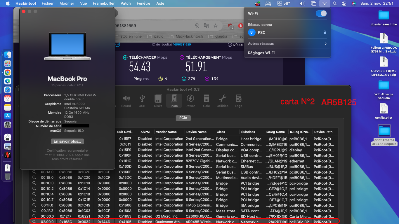

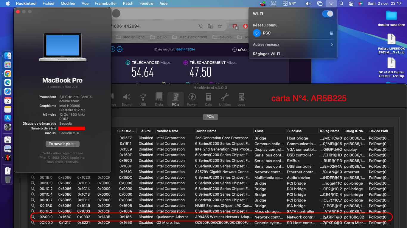

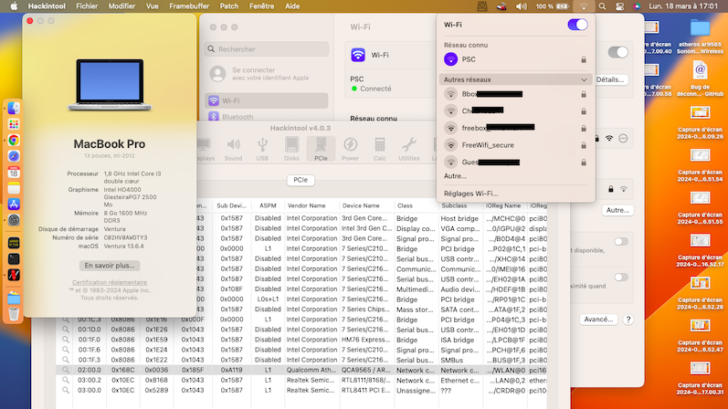

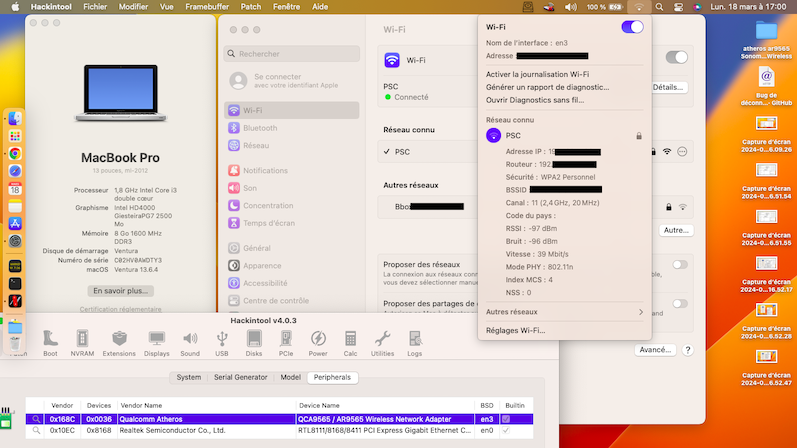

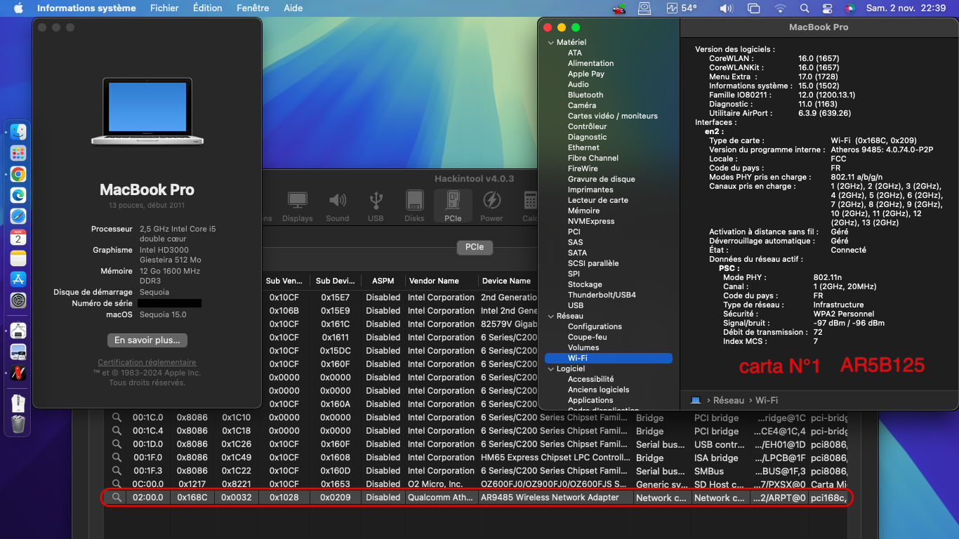

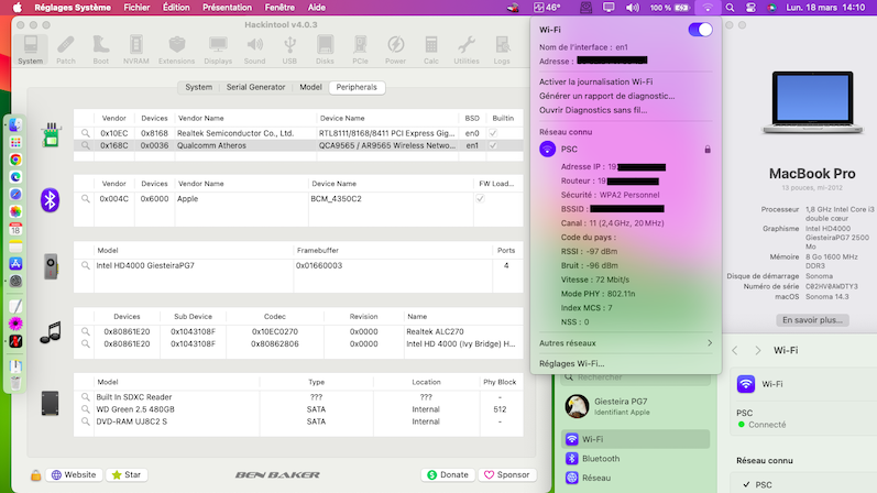

hoaug Posted November 26, 2024 Share Posted November 26, 2024 (edited) That's wonderful. I have a question about whether the AR9565,... is limited to 10Mbps like in previous versions. I have tried installing it with Monterey for quite a while now, but the speed of the AR9565 is really terrible and slow, hovering around 9-10Mbps with my 180Mbps network package Edited November 26, 2024 by kinhhoang161 Link to comment https://www.insanelymac.com/forum/topic/359007-wifi-atheros-monterey-ventura-sonoma-sequoia-work/#findComment-2828412 Share on other sites More sharing options...

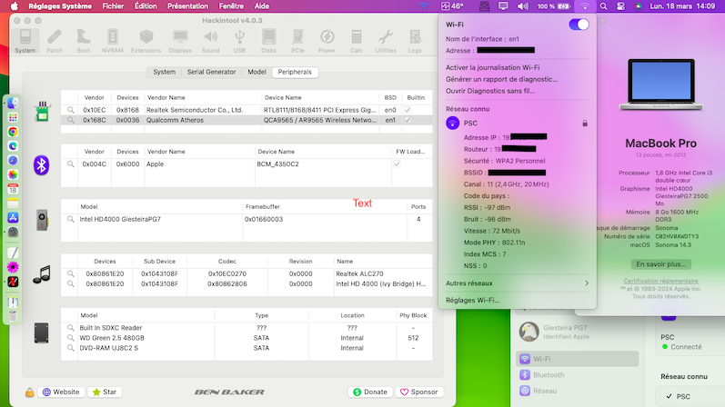

PG7 Posted November 26, 2024 Author Share Posted November 26, 2024 (edited) 37 minutes ago, kinhhoang161 said: That's wonderful. I have a question about whether the AR9565,... is limited to 10Mbps like in previous versions. I have tried installing it with Monterey for quite a while now, but the speed of the AR9565 is really terrible and slow, hovering around 9-10Mbps with my 180Mbps network package Hello, certain versions of the AR9565 have different subsells and there are even certain ones that don't even find a network in my case they have correct speeds but it depends on which card and which bios it goes to as there are certain firmware that have these dependencies but I don't know the reason As in the prints, mine has an acceptable speed Google Translat ! Edited November 26, 2024 by PG7 1 Link to comment https://www.insanelymac.com/forum/topic/359007-wifi-atheros-monterey-ventura-sonoma-sequoia-work/#findComment-2828414 Share on other sites More sharing options...

Thebes Knossos Posted January 2 Share Posted January 2 (edited) Method described above is a little bit out of date. You need the 3 kexts,+ SSDT-ARPT.dsl, then apply OCLP-mod for legacy wireless but it is in chineese language. You can also use OCLP by spoofing IOName in device registry: Edited January 2 by Thebes Knossos Link to comment https://www.insanelymac.com/forum/topic/359007-wifi-atheros-monterey-ventura-sonoma-sequoia-work/#findComment-2845748 Share on other sites More sharing options...
