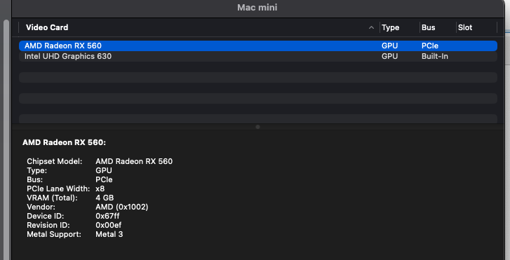

rcurley55 Posted February 18 Share Posted February 18 Hi All- This is a great community. Using the amazing work on this thread below, I was able to get my EliteDesk 800 G5 running with Ventura. The only issue is that I have a Dell u4919dw monitor, and I can't for the life of me get the integrated UHD630 to run the display at 5120 x 1440 (I'm stuck at 3840 x 1080). I have added the rx560 to the machine, and it recognizes that the card is there (see screenshot) but when I try to boot it using the tonymacx86 instructions to run the UHD630 headless and as a Mac19,1, the screen goes black midway through boot up. If anyone has any suggestions on what to do, I would greatly appreciate it! Quote Link to comment Share on other sites More sharing options...

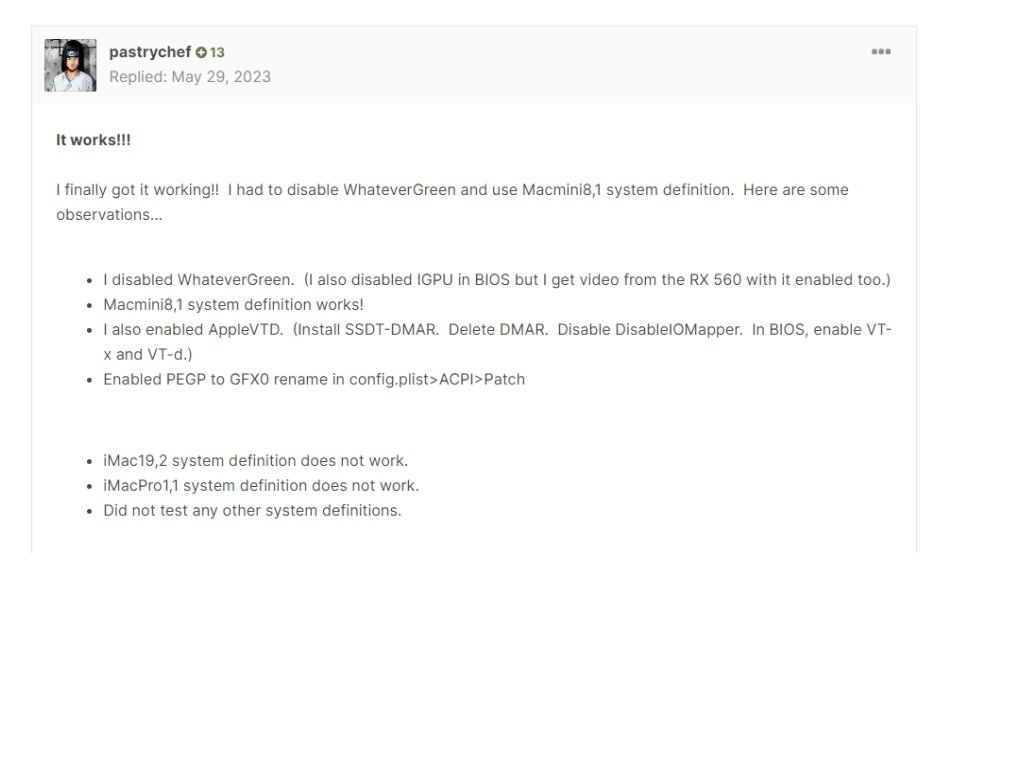

deeveedee Posted February 21 Share Posted February 21 (edited) And don't mention tonymacx86 when you tell people not to mention tonymacx86. LOL EDIT: @rcurley55 I see that pastrychef hasn't visited for a while. I hope he doesn't mind that I'm sharing what he sent me via PM: Spoiler Edited February 21 by deeveedee 1 Quote Link to comment Share on other sites More sharing options...
rcurley55 Posted February 22 Author Share Posted February 22 (edited) I'm so sorry to mention the forum that should not be named!!! I didn't know. Here are the headless UHD630 instructions that I followed on this board: @deeveedee I had reached out to @pastrychef by PM but never heard back. Thank you for posting that information! I'll at least give that a try and am happy I can stick with MacMini8,1. And @deeveedee Thank you SOOO much for all of your hard work on the EFI for the EliteDesk - I have learned so much from your tests and guidance! Edited February 22 by rcurley55 1 Quote Link to comment Share on other sites More sharing options...

rcurley55 Posted March 16 Author Share Posted March 16 So I have a partial success to report! I disabled Whatevergreen, added my modified DMAR.aml, disabled IO mapper, and updated the settings in the bios. I wasn't able to figure out the PEGP -> GFX0 rename, BUT the card does boot and runs. When I first set it up, it even picked up my 5120 x 1440 resolution! On reboot; however, things get strange: the UI at the login screen gets huge and it defaults back to some tiny resolution once logged in. When logged in, I can set it to 3840 x 1080 @ 60 Hz through the Settings app With SwitchResX, I can get to 5120 x 1440 but only at 30 Hz. If I move the monitor back to the PBP mode, let MacOS go to 2560 x 1440, then turn off PBP mode, MacOS will allow 5120 x 1440 @ 60 Hz in the Settings app Very strange, but I guess I'm happy with that for now as a workaround. If anyone can point me in the right direction for solving the rename and/or the changing resolution I would appreciate it. Quote Link to comment Share on other sites More sharing options...
