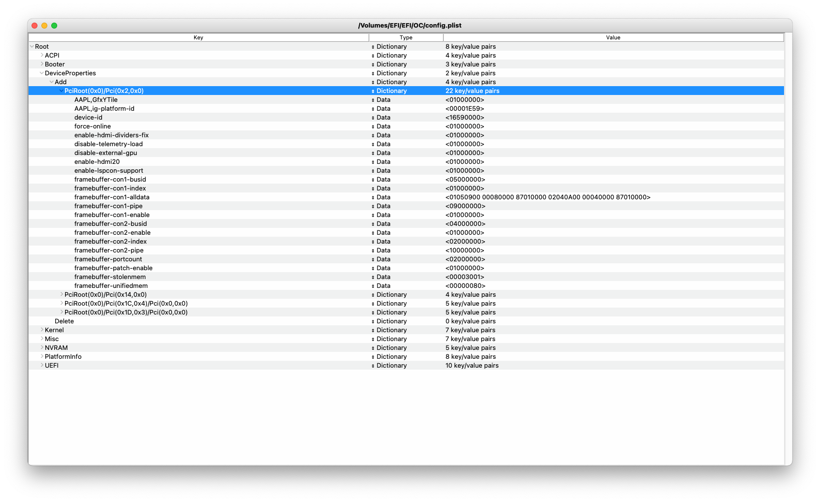

Attach config.plist and Mac specs.

config.plist

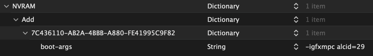

¡Al fin! igfxmpc is a WhateverGreen boot arg that increases max pixel clock (as an alternative to patching CoreDisplay.framework).
I don’t see the exact relationship with your issue but looking for a fix I found posts from users whose laptop screen was black (external screen working) due to something related to the refresh rate and this boot arg had fixed the problem.
Enjoy!

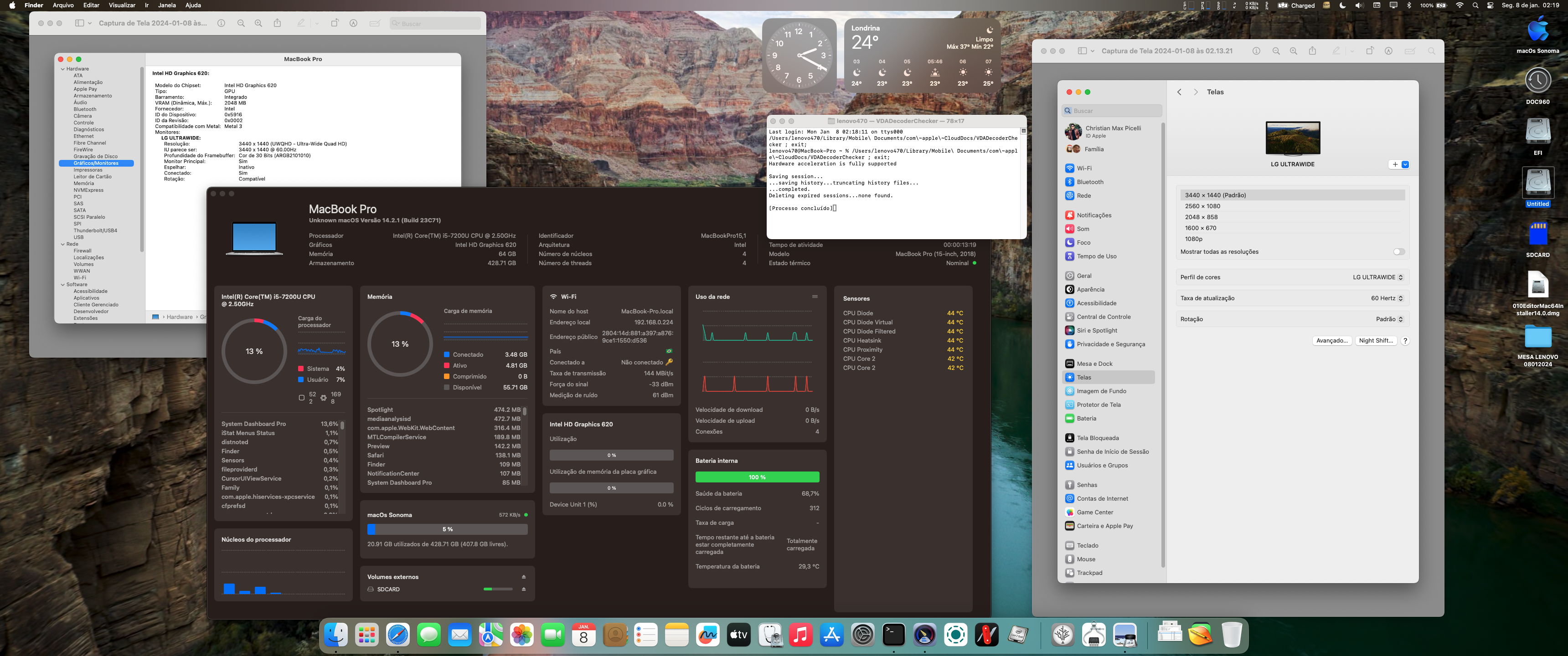

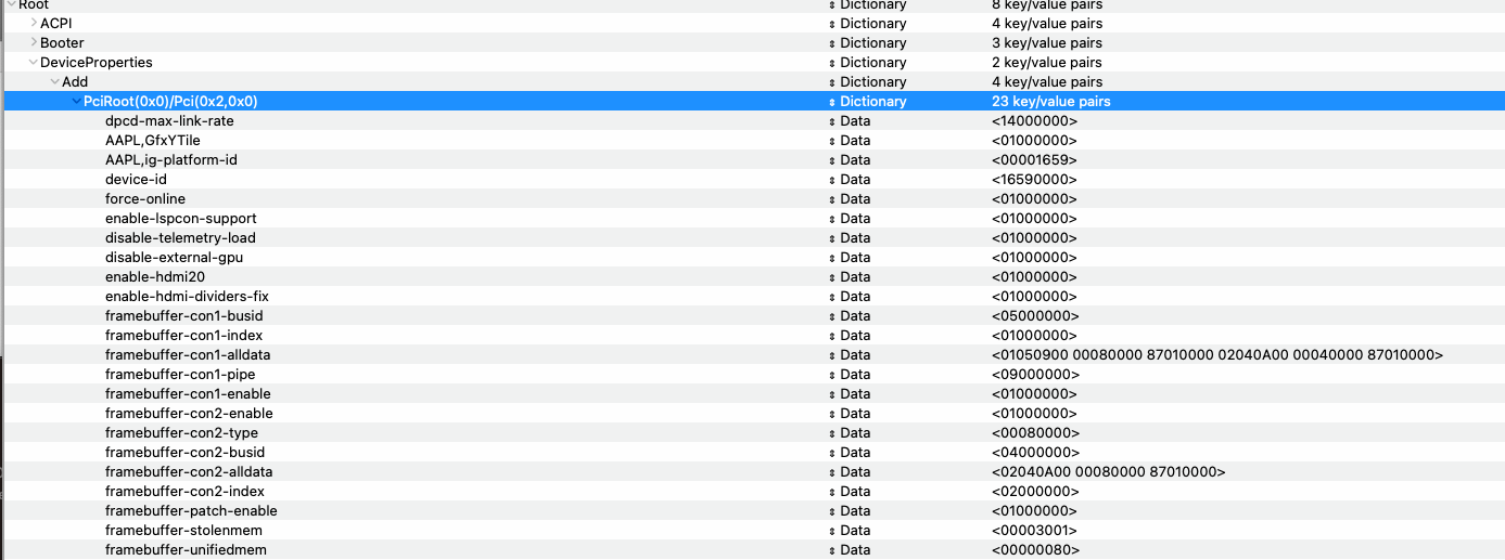

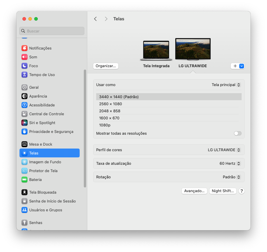

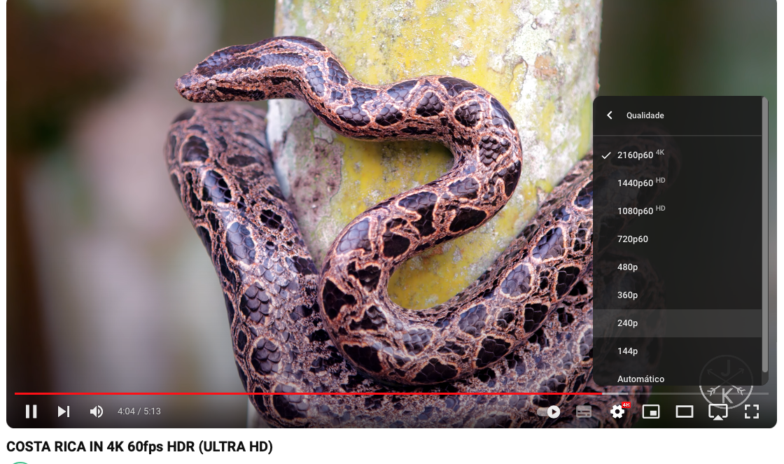

Hello everyone, taking advantage of some finer adjustments, I got HDMI recognized and two screens, with the lid open and the best, 4K on Youtube 2160p60 without glitches or freezing. Very interesting that -igfxmlr gave me a problem, not boot on LCD normally, and without this boot-arg it natively gave 4K, like Ultrawide Monitor 3440x1440 and 60Hz. Both screens works together.

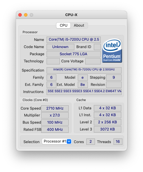

Intel UHD 620 16590000 Kaby Lake i5-7200-U
Device Properties
Spoiler
Spoiler
