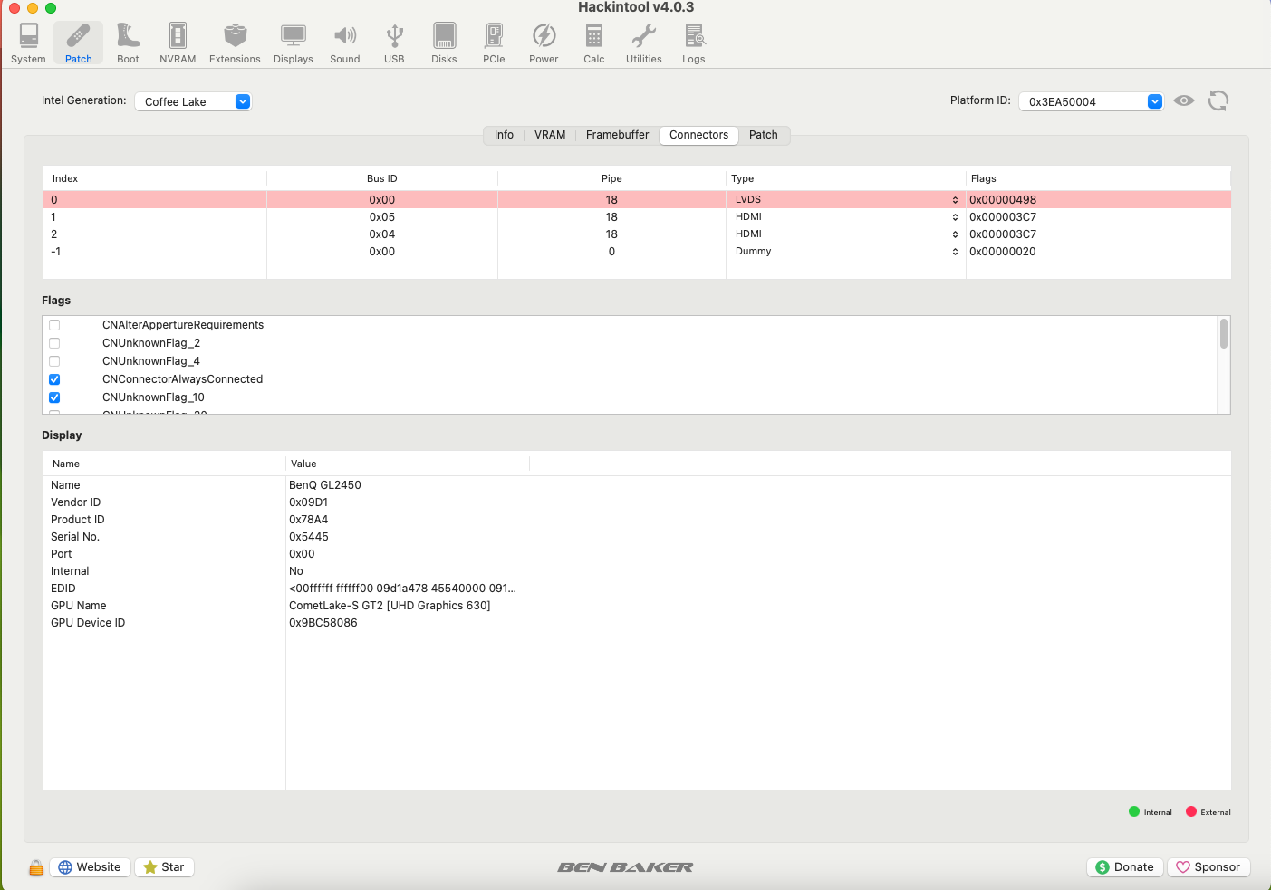

onibla Posted January 5, 2024 Share Posted January 5, 2024 Dear all, I have installed Monterey and Sonoma on my new NUC Magic Mini pc but I have a big problem. The only mode to view the screen accelerating the iGPU is to use the VGA connector. My NUC have also 2 HDMI which give me a Black Screen after verbose. I have tried several procedure to fix it with insuccess. I have generated framebuffer-con0-alldata: 00001200 02000000 98040000 01050900 00080000 C7030000 02040A00 00080000 C7030000 but HDMI don't want to GO! Someone can Help me to fix this problem? Thanks in advance. I attached also my config.plist config.plist Link to comment https://www.insanelymac.com/forum/topic/358422-comet-lake-10710u-intel-hd-630-only-vga-problem/ Share on other sites More sharing options...

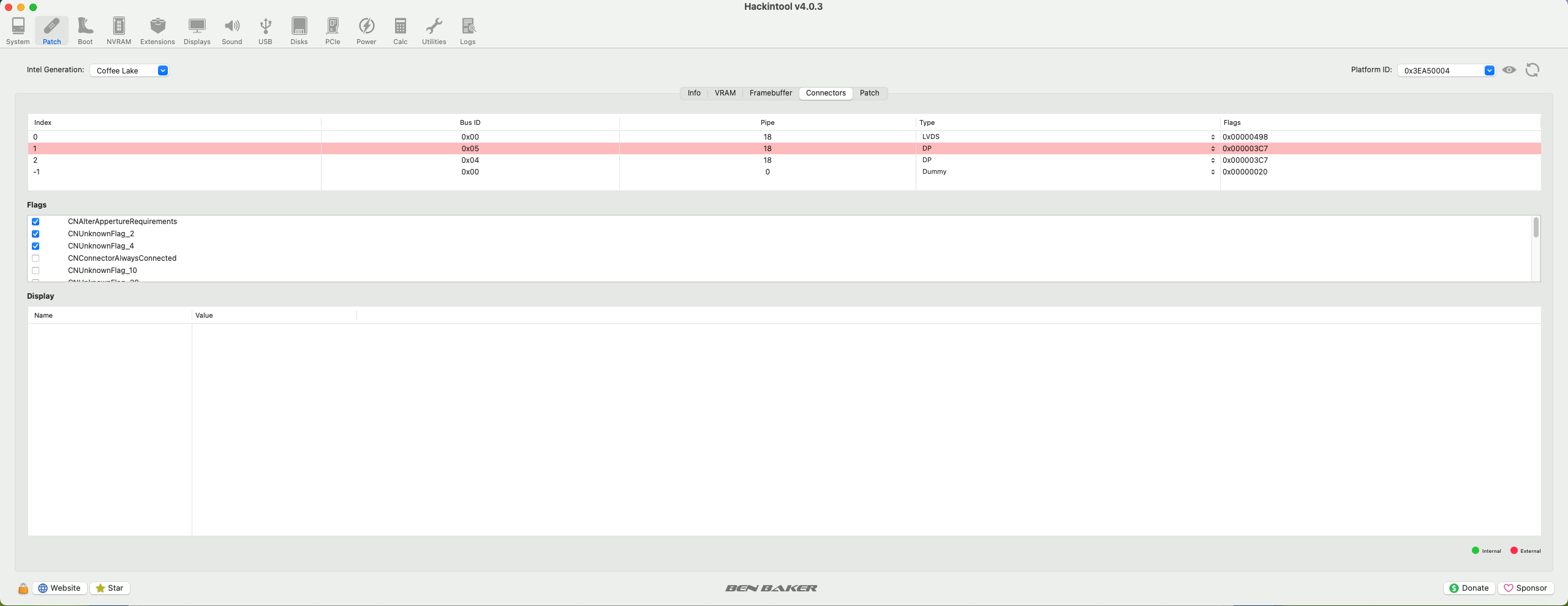

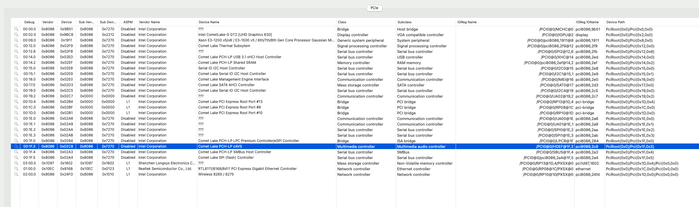

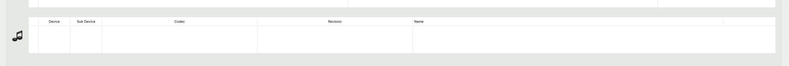

onibla Posted January 8, 2024 Author Share Posted January 8, 2024 Dear @niknod thanks. I would be very grateful if you would share your EFI with me. I have solved the video problem but I have an Audio problem. It is not detected in peripherals. This should be Thanks again Link to comment https://www.insanelymac.com/forum/topic/358422-comet-lake-10710u-intel-hd-630-only-vga-problem/#findComment-2815304 Share on other sites More sharing options...
