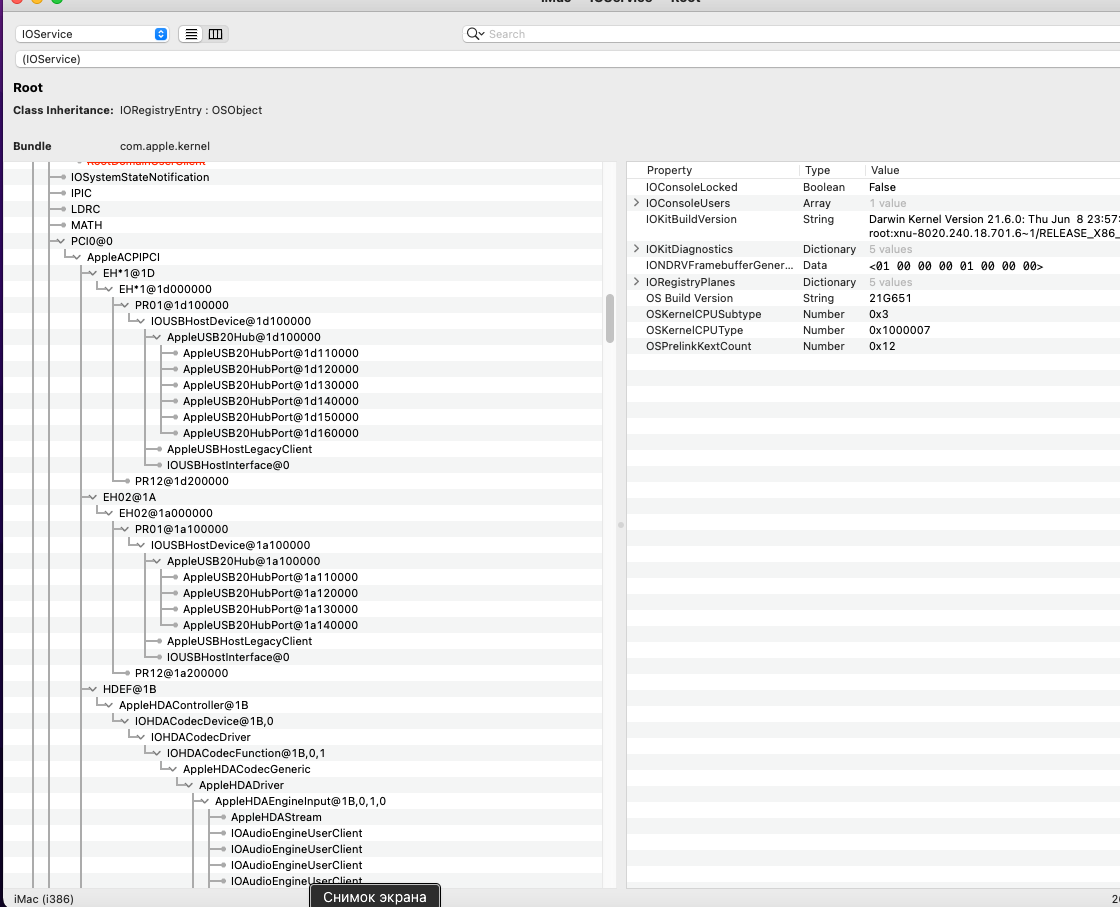

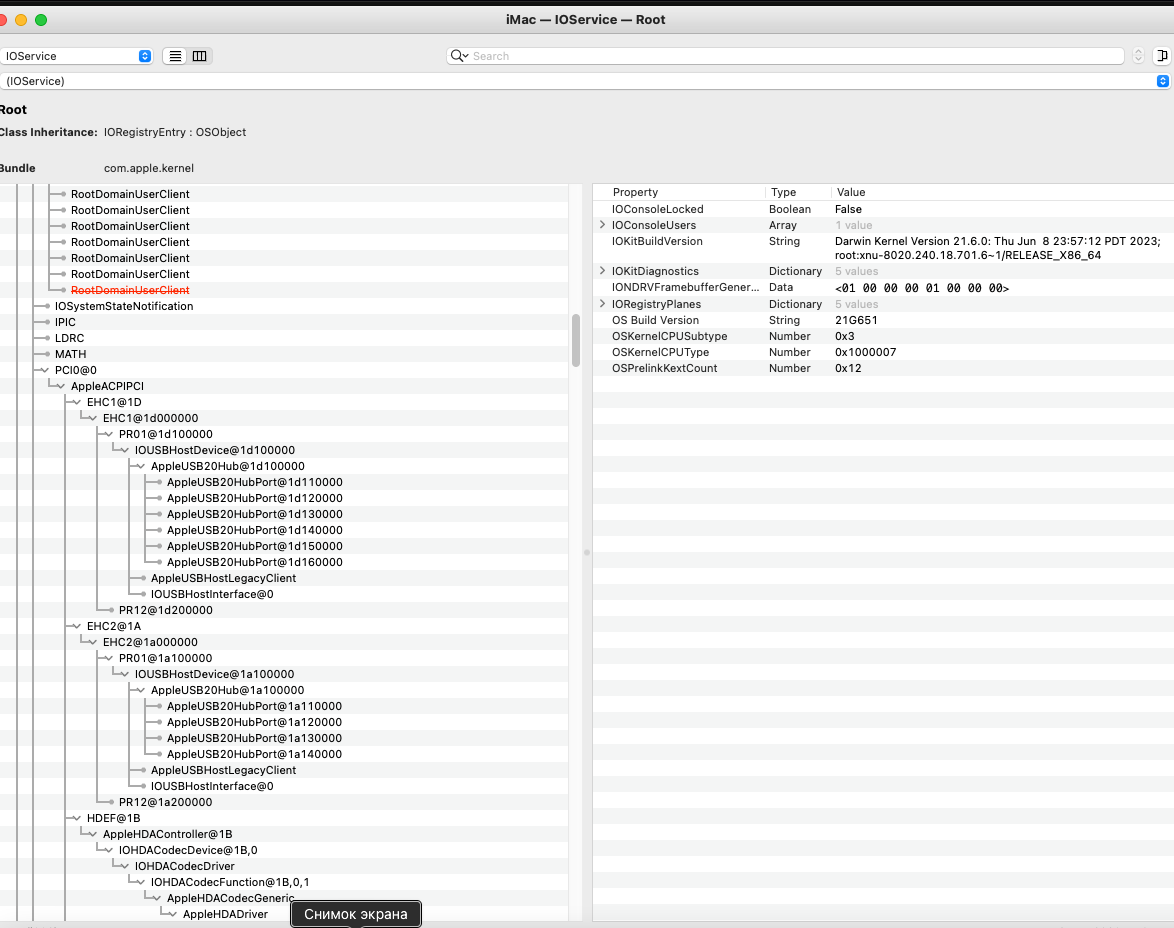

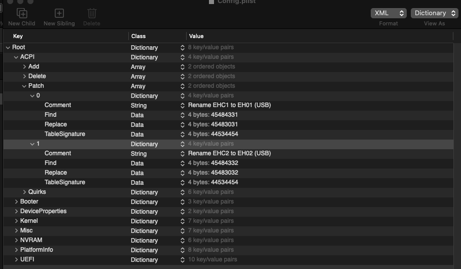

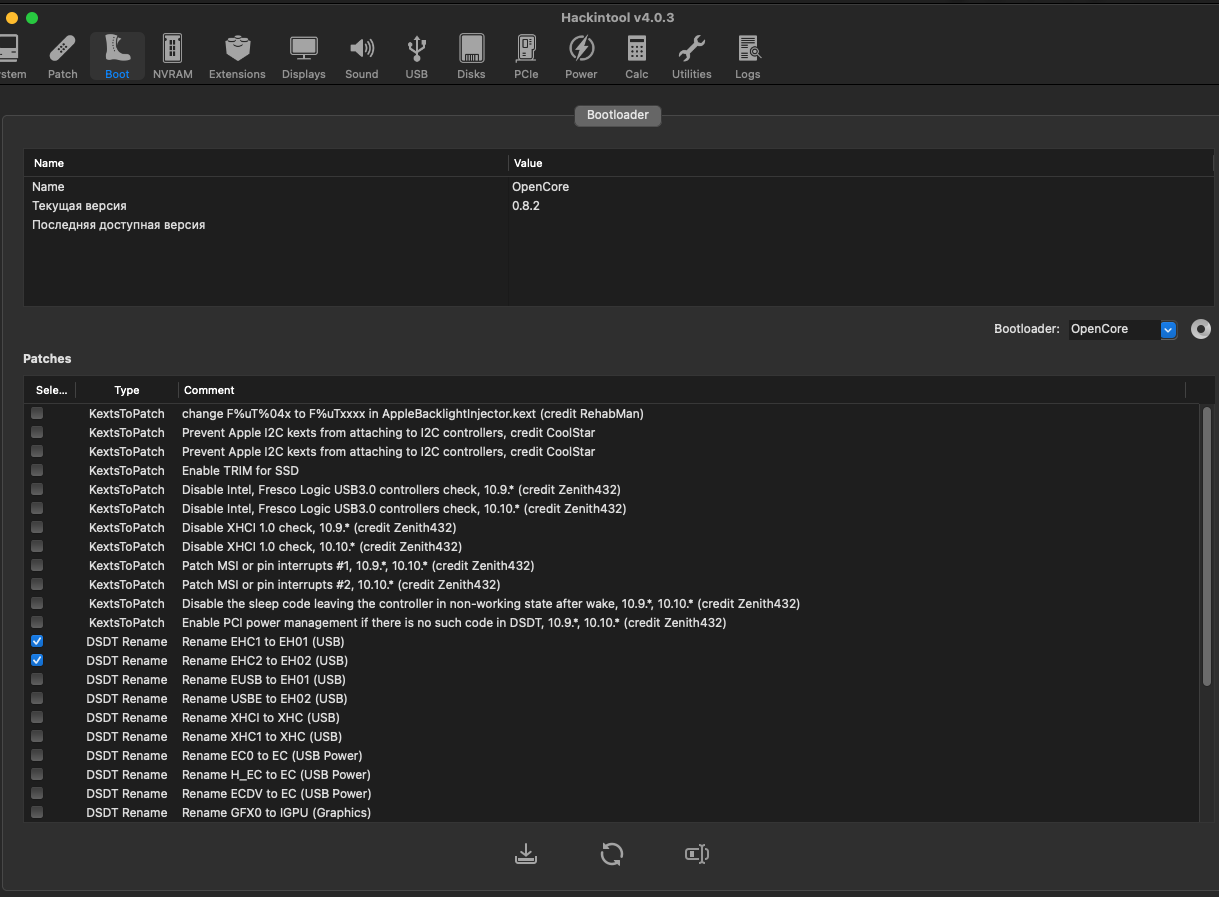

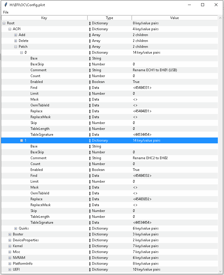

sashacot1 Posted November 24, 2023 Share Posted November 24, 2023 Hello My computer :MSI H81I (MS-7851) :DualCore Intel Core i3-4130 Haswell :AMD HD 5570 Opencore 0.9.6 Help me please , I have registered two patches via Hackintool in config.plist. But when I go to IOreg , ECH1-2 does not change to ECH01-2 ProperTree-master snapshot ok Thx Quote Link to comment https://www.insanelymac.com/forum/topic/358121-msi-h81i-i3-4130-haswell-amd-hd-5570-i-cant-change-ech1-2-ech01-2/ Share on other sites More sharing options...

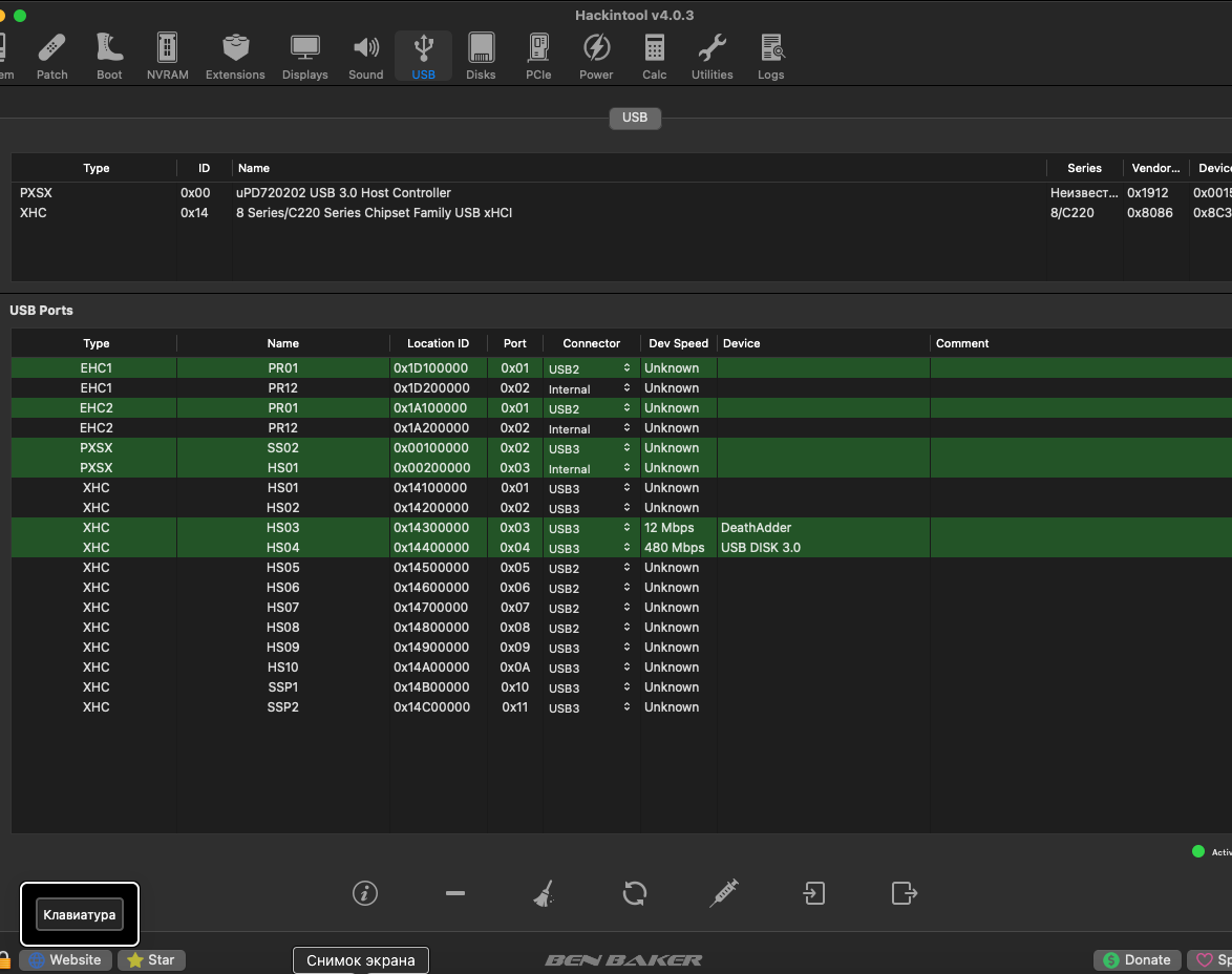

MaLd0n Posted November 24, 2023 Share Posted November 24, 2023 U don't need rename these devices. The best in this case is disable these devices. Ur hardware need only XHC device. In old time we injected _dsm to disable these devices. Now u can use one patch created by ACDT Quote Scope (\) { OperationRegion (RCRG, SystemMemory, 0xFED1F418, One) Field (RCRG, DWordAcc, Lock, Preserve) { , 13, EH2D, 1, , 1, EH1D, 1 } Method (_INI, 0, NotSerialized) // _INI: Initialize { If (_OSI ("Darwin")) { EH1D = One EH2D = One } } } Quote Link to comment https://www.insanelymac.com/forum/topic/358121-msi-h81i-i3-4130-haswell-amd-hd-5570-i-cant-change-ech1-2-ech01-2/#findComment-2813837 Share on other sites More sharing options...
sashacot1 Posted November 24, 2023 Author Share Posted November 24, 2023 23 minutes ago, MaLd0n said: U don't need rename these devices. The best in this case is disable these devices. Ur hardware need only XHC device. In old time we injected _dsm to disable these devices. Now u can use one patch created by ACDT Thanks , I 'll try and come back ) Quote Link to comment https://www.insanelymac.com/forum/topic/358121-msi-h81i-i3-4130-haswell-amd-hd-5570-i-cant-change-ech1-2-ech01-2/#findComment-2813838 Share on other sites More sharing options...

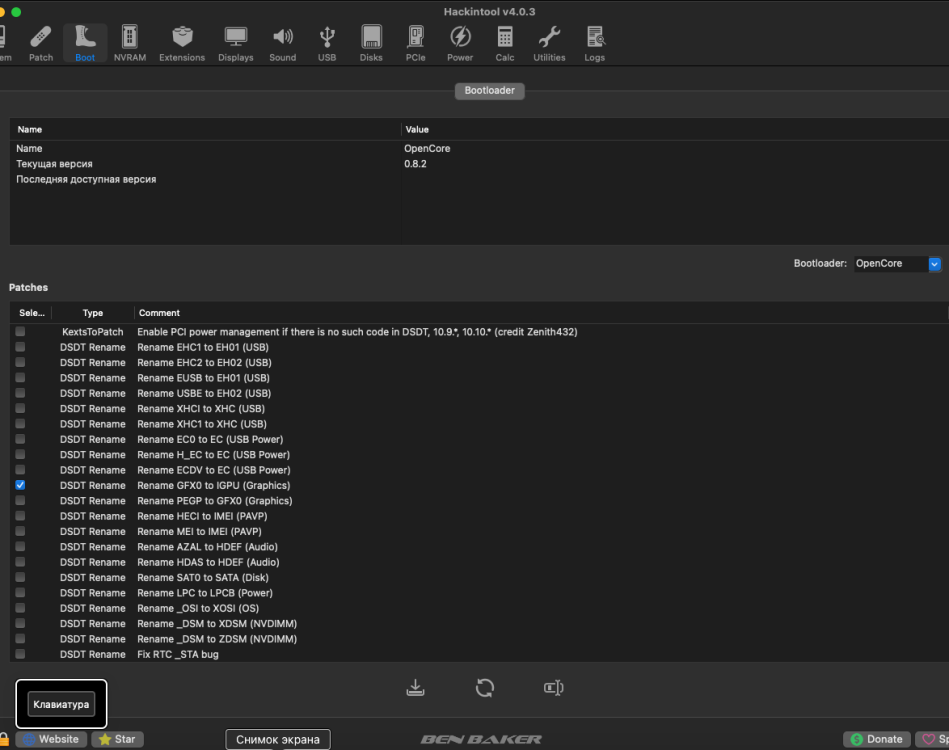

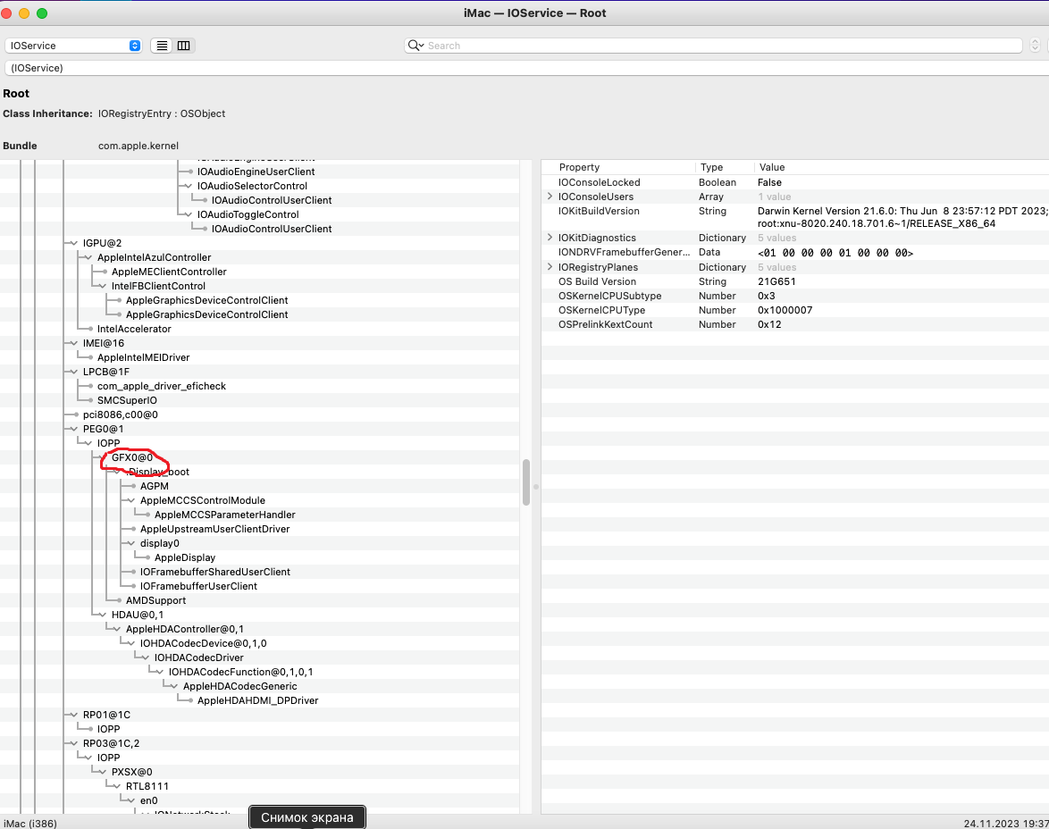

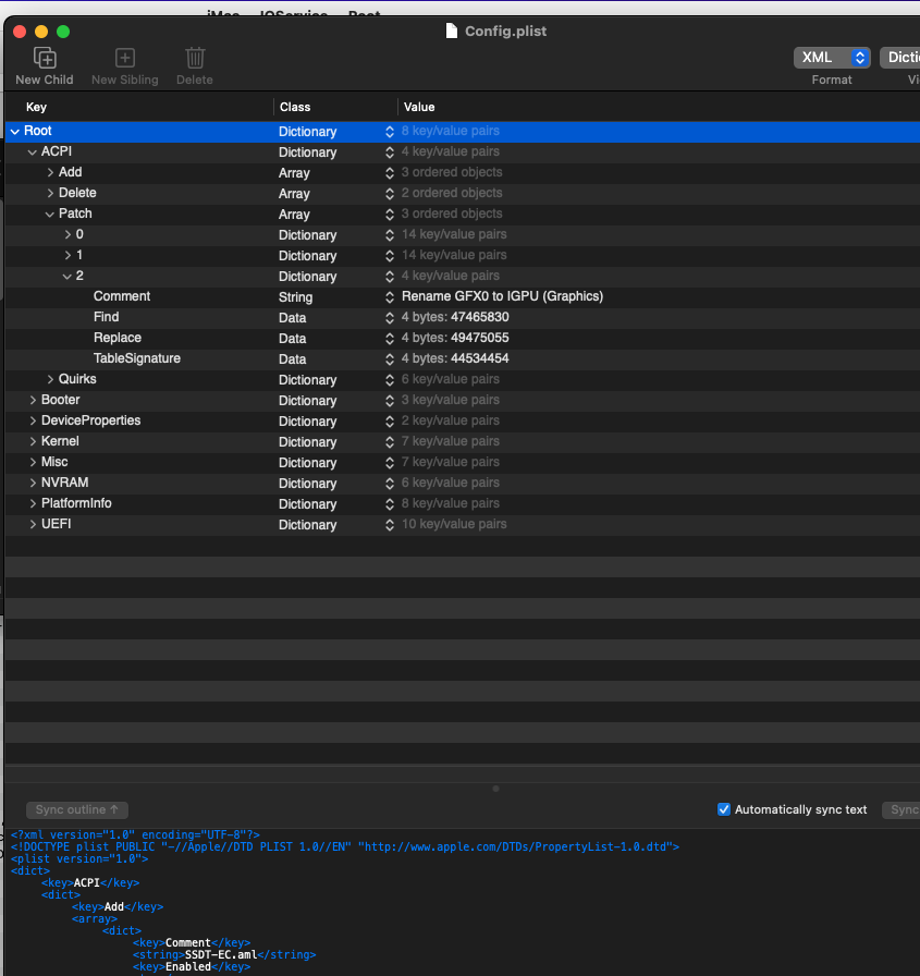

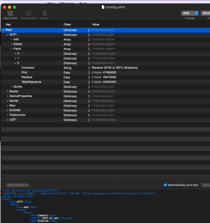

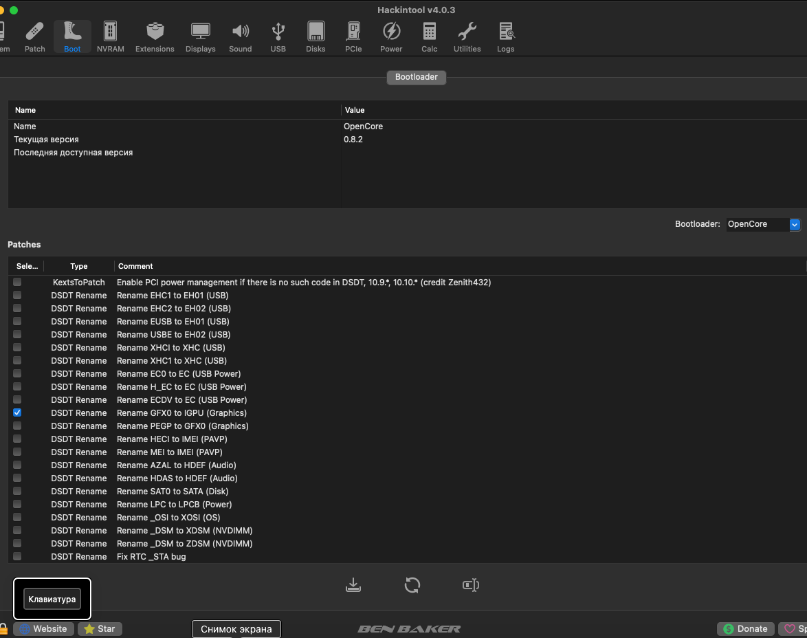

sashacot1 Posted November 24, 2023 Author Share Posted November 24, 2023 (edited) 1 hour ago, MaLd0n said: U don't need rename these devices. The best in this case is disable these devices. Ur hardware need only XHC device. In old time we injected _dsm to disable these devices. Now u can use one patch created by ACDT config.rar Edited November 24, 2023 by sashacot1 Ok. SSDT-Ecx-DISABLE turned off unnecessary USB (snapshot 1) there were fewer of them and ehc12 disappeared. While we close the question about USB, The same situation is with GFX0 to IGPU . HACK TOOL path (Figure 2) in Config .plist (Figure 3). but it d Quote Link to comment https://www.insanelymac.com/forum/topic/358121-msi-h81i-i3-4130-haswell-amd-hd-5570-i-cant-change-ech1-2-ech01-2/#findComment-2813840 Share on other sites More sharing options...
sashacot1 Posted November 24, 2023 Author Share Posted November 24, 2023 Sory some trubl FOTO IN UP POST Ok. SSDT-Ecx-DISABLE turned off unnecessary USB (snapshot 1) there were fewer of them and ehc12 disappeared. While we close the question about USB, The same situation is with GFX0 to IGPU . HACK TOOL path (Figure 2) in Config .plist (Figure 3). but it doesn't change in IOreg (Figure 4) Thanks Quote Link to comment https://www.insanelymac.com/forum/topic/358121-msi-h81i-i3-4130-haswell-amd-hd-5570-i-cant-change-ech1-2-ech01-2/#findComment-2813841 Share on other sites More sharing options...
MaLd0n Posted November 24, 2023 Share Posted November 24, 2023 U don't need renames(GFX0, IMEI). Whatevergreen work on this on the fly. 1 Quote Link to comment https://www.insanelymac.com/forum/topic/358121-msi-h81i-i3-4130-haswell-amd-hd-5570-i-cant-change-ech1-2-ech01-2/#findComment-2813845 Share on other sites More sharing options...
sashacot1 Posted November 25, 2023 Author Share Posted November 25, 2023 8 hours ago, MaLd0n said: U don't need renames(GFX0, IMEI). Whatevergreen work on this on the fly. Wait! What about IOreg ,? shouldn't it be showing correctly? Thanks Quote Link to comment https://www.insanelymac.com/forum/topic/358121-msi-h81i-i3-4130-haswell-amd-hd-5570-i-cant-change-ech1-2-ech01-2/#findComment-2813856 Share on other sites More sharing options...
sashacot1 Posted November 25, 2023 Author Share Posted November 25, 2023 On another forum, they told me how to change it, but another problem appeared EC*1 Config.rar Quote Link to comment https://www.insanelymac.com/forum/topic/358121-msi-h81i-i3-4130-haswell-amd-hd-5570-i-cant-change-ech1-2-ech01-2/#findComment-2813891 Share on other sites More sharing options...
