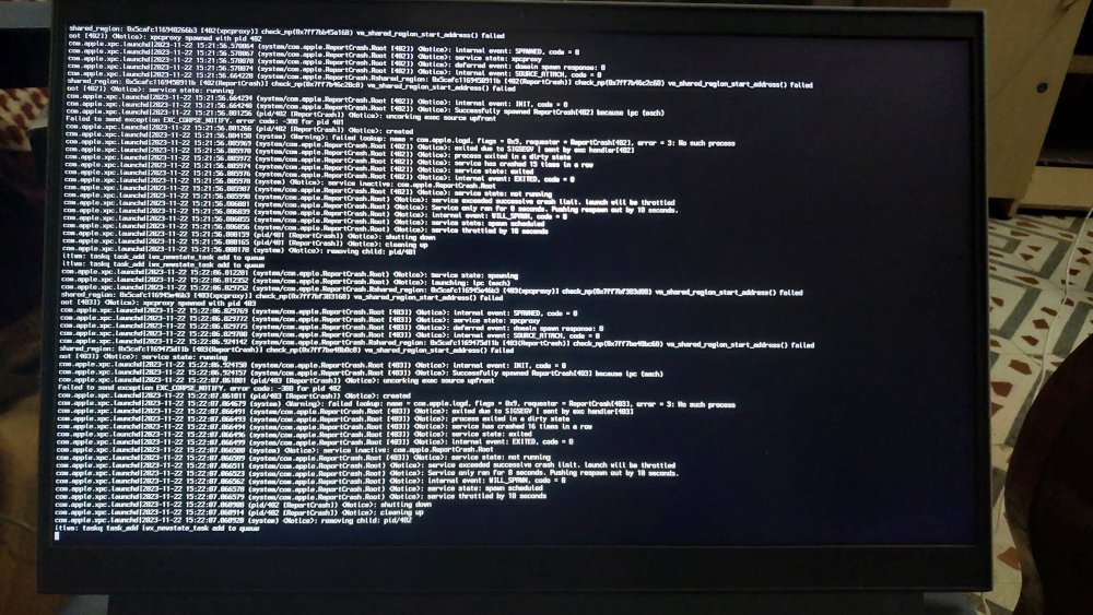

Siddharth Manthan Posted November 22, 2023 Share Posted November 22, 2023 Cannot boot to installer. Hardware : Dell G15 5515 Ryzen Edition Ryzen 5 5600H Vega igpu + RTX 3050 Laptop Trying to get iGPU working using nootedred config - Panic - Add Patches.plist Quote Link to comment https://www.insanelymac.com/forum/topic/358113-cannot-boot-to-installer/ Share on other sites More sharing options...
Siddharth Manthan Posted November 22, 2023 Author Share Posted November 22, 2023 It seems there was an error in my usbmap install. After correcting it I am stuck with new issue : https://drive.google.com/file/d/1g_0DFO_qsloo5DJVpR7Iz_0CPz55LypD/view?usp=sharingNew Config : https://pastebin.com/ZXVmP6Kq Quote Link to comment https://www.insanelymac.com/forum/topic/358113-cannot-boot-to-installer/#findComment-2813790 Share on other sites More sharing options...
Siddharth Manthan Posted November 23, 2023 Author Share Posted November 23, 2023 Fixed. For future readers use the following instead of the one recommended by dortania guide for usb.RattletraPM/GUX-RyzenXHCIFix: A fork of GenericUSBXHCI aimed at analyzing and fixing the USB3 issue on some Ryzen APU-based 11.0+ hackintoshes (github.com) Quote Link to comment https://www.insanelymac.com/forum/topic/358113-cannot-boot-to-installer/#findComment-2813803 Share on other sites More sharing options...
