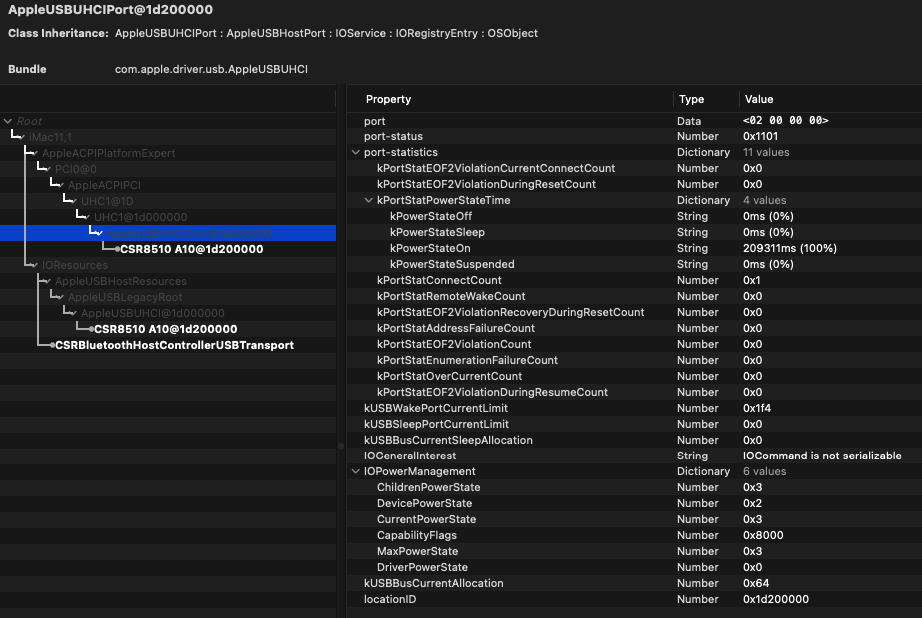

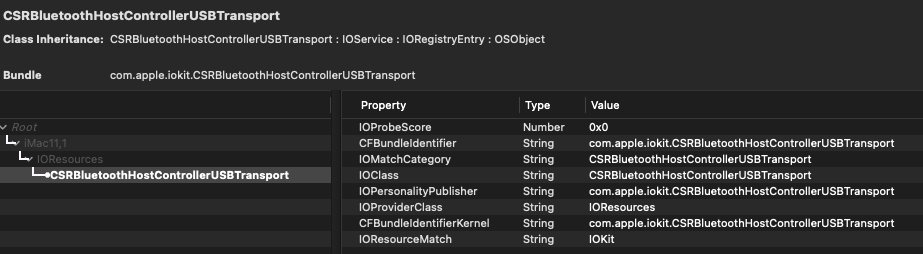

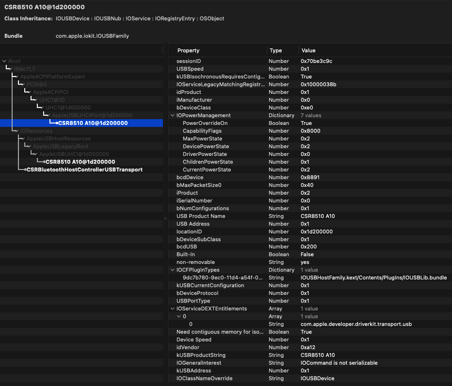

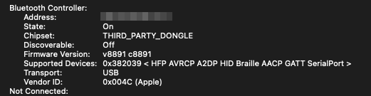

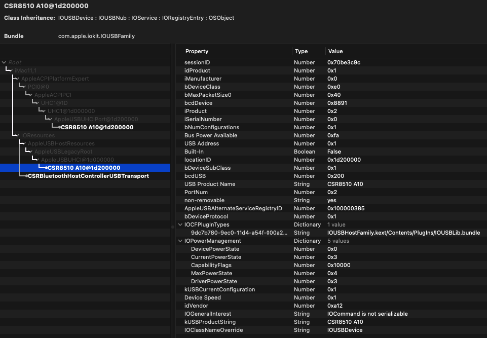

mrmacdi2 Posted October 31, 2023 Share Posted October 31, 2023 (edited) Hello, I'm using 3rd party CSR8510 Bluetooth 4.0 USB 1.1 dongle and it stops working after waking from sleep: unplugging, turning on/off, plugging back makes no difference: Bluetooth not available. I see that USB power is supplied after wake to the Bluetooth dongle - led is on, so it has power. Only reboot fixes the issue. macOS Ventura 13.6 OCLP Root patch for USB 1.1 AppleUSBUHCI.kext and AppleUSBUHCIPCI.kext are injected via OC to add USB 1.1 back. BlueToolFixup.kext (2.6.8) is injected via OC USB ports are mapped via USBTool Suspend S3 works fine I think the issue with CSR8510 can be related to BlueToolFixup System info: IOReg: When Bluetooth stops working: When Bluetooth dongle works: Edited November 4, 2023 by mrmacdi2 Link to comment https://www.insanelymac.com/forum/topic/357956-solved-csr8510-usb-bluetooth-not-working-after-wake-from-sleep-in-ventura/ Share on other sites More sharing options...
