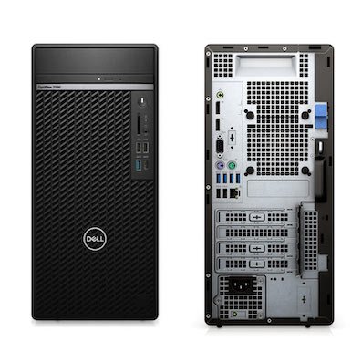

idle0502 Posted September 6, 2023 Share Posted September 6, 2023 Dell Optiplex 7090 MT, Core i9-10900, 16Gb DDR4-2933, Intel UHD630, AMD Radeon RX 560, Ventura 13.5, LG 4K Spoiler I made an EFI folder for the system on a Comet Lake processor, removed the CFG Lock, connected the disk with Mac OS Ventura installed from my old Dell Optiplex 3040 and I was able to boot, but with one very annoying problem that makes using my new hackintosh impossible, it does not work USB ports. I formed my own USBmap.kext, but it did not help, I tried to boot using USBInjectAll.kext but also without success... Neither here on the forum, nor on the Internet, I could not find information on enabling USB ports on the Optiplex 7090. Please help to get the USB ports working. EFI_optiplex_7090.zip Link to comment https://www.insanelymac.com/forum/topic/357583-dell-optiplex-7090-mt-usb-ports-not-working/ Share on other sites More sharing options...
idle0502 Posted September 7, 2023 Author Share Posted September 7, 2023 I got an answer on Osxlatitude https://osxlatitude.com/forums/topic/19507-dell-optiplex-7090-mt-usb-ports-not-working-ventura/ It was necessary to add USBToolBox.kext, remove XHCI-unsupported.kext and clean up renaming EH01, EH02... Thanks to Jake Lo for the help! Link to comment https://www.insanelymac.com/forum/topic/357583-dell-optiplex-7090-mt-usb-ports-not-working/#findComment-2810900 Share on other sites More sharing options...
