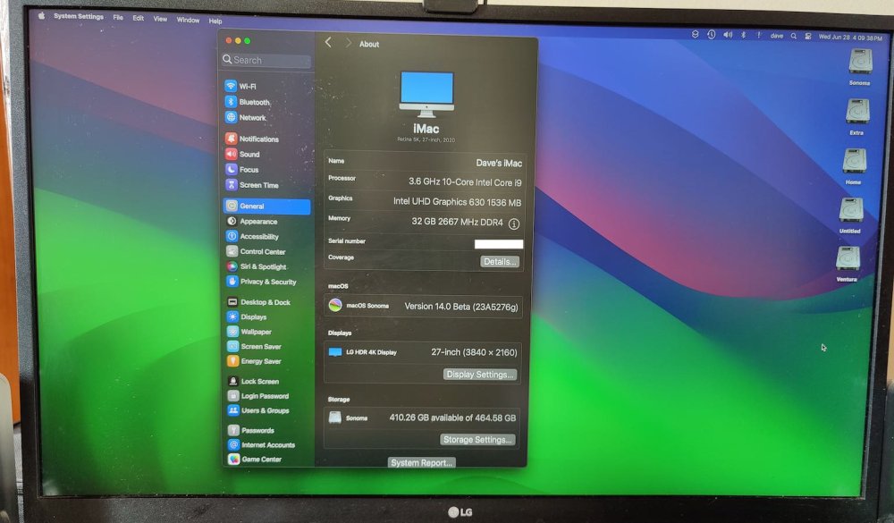

AmigaOS Posted June 28, 2023 Share Posted June 28, 2023 (edited) Updated from Sonoma Beta to Beta 2 with no issues. Everything works except wifi only works with Heliport and itlwm and doesn't get full speed just sorta works. Still has the stock intel AX200, Bluetooth works great. Opencore 0.9.3 and latest kexts. Also running Ventura 13.41 as my daily driver. Win 11 and opensuse Tumbleweed also. Using the 630 gpu as I needed the graphics port for a NVME M2 adapter so I could run 4 M2 drives total. 32 gb DDR4 ram. Thermaltake cube ITX case. Update: Beta 3 installed successfully. Disk Utility no longer hangs at the end of running First Aid. Seems pretty stable otherwise so far. Edited July 6, 2023 by AmigaOS fix auto-correct mess ups 2 Link to comment https://www.insanelymac.com/forum/topic/357079-success-sonoma-beta-3-asrock-z490m-itxac-i9-10900/ Share on other sites More sharing options...
