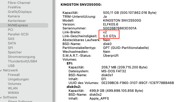

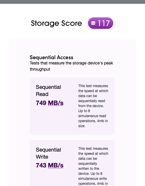

PoMpIs Posted May 29, 2023 Share Posted May 29, 2023 You have the NVME running in PCIe x2 PCIe 2.0 mode That slows down the NVME a lot... But your motherboard does not give for more, it puts it in the manual. The maximum bandwidth of a PCIe X2 - 2.0 is little for a modern NVMe In that port you have 500MB/s per lane... since they are two lanes, it gives you 1000MB/s. and you are not very far on the bench that you show 3 1 Quote Link to comment https://www.insanelymac.com/forum/topic/356837-successful-build-but-nvme-performance-potentially-too-low/#findComment-2805263 Share on other sites More sharing options...
anfas Posted May 30, 2023 Author Share Posted May 30, 2023 Ok, thanks a lot for the quick reply. understood - works as designed. In that case I've to look for a mainboard with higher throughput. Best regards Andreas 1 Quote Link to comment https://www.insanelymac.com/forum/topic/356837-successful-build-but-nvme-performance-potentially-too-low/#findComment-2805283 Share on other sites More sharing options...
