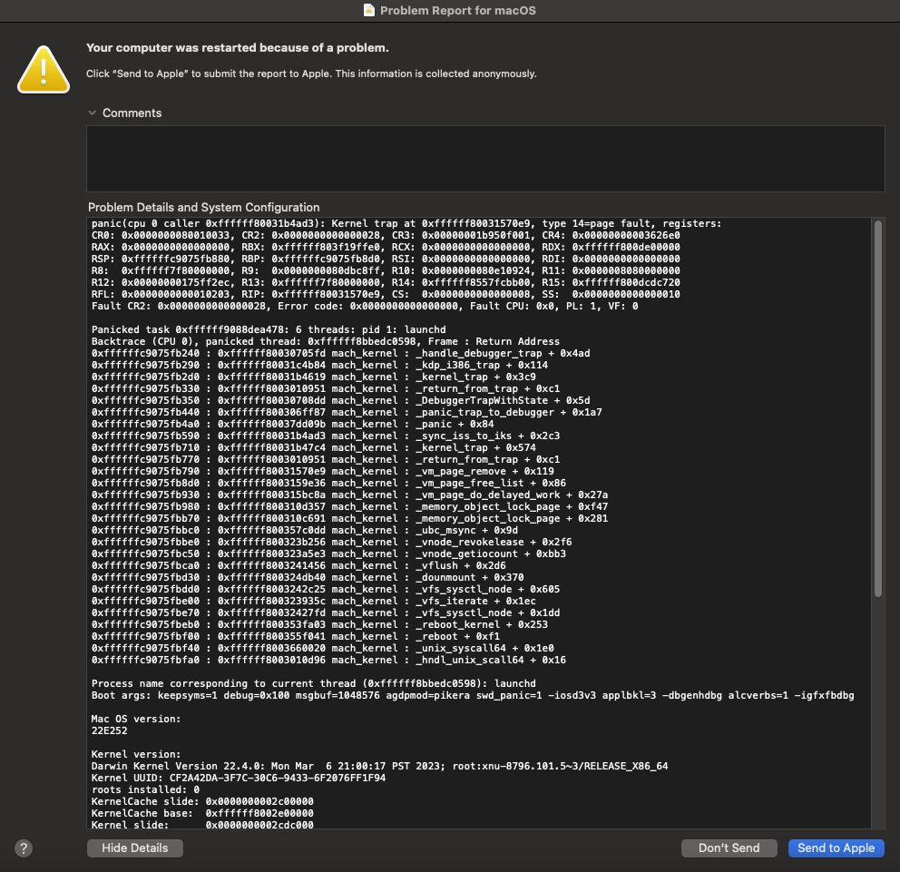

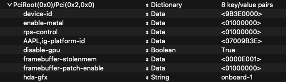

Fortitude Posted May 4, 2023 Share Posted May 4, 2023 (edited) I’ve got an Intel 10900K CPU with a UHD 630 on my Alienware Area 51m-R2 laptop, and have to disable the iGPU for now because of this freezing problem. Essentially what happens is that I could be doing anything regardless of whether an external display is connected, and the OS will eventually kernel panic freezing my entire screen. The computer has to then be forced off afterwards... Once the computer is turned back on again, it pops up with a page fault kernel panic. I’m not sure what the root cause of this issue is, and was wondering if anyone here has solved this problem lately? I’m running macOS 13.3 currently, and this is how my iGPU is configured as of now. Before anyone asks, the stolenmem is set to 30MB for a reason: I couldn’t find a DVMT setting in my BIOS and I wasn’t sure how or where to find the DVMT setting from the .rom file (you have to run the writeromfile command in the Windows command prompt). After a lot of trial and error, I discovered that the Intel framebuffer doesn’t kernel panic if this key is set to a value less than or equal to 30MB. Regarding the iGPU, it only has one connection. It connects to a single Thunderbolt 3 port on the side of my computer and nowhere else. My internal display is only driven by a direct connection (no mux, just a single eDP cable) to an AMD Radeon RX 5700M GPU. Edited May 4, 2023 by Fortitude Link to comment https://www.insanelymac.com/forum/topic/356609-igpu-freezes-my-computer-when-enabled/ Share on other sites More sharing options...
miliuco Posted May 4, 2023 Share Posted May 4, 2023 (edited) @Fortitude What is the purpose of disabling the iGPU when at the same time you are loading properties for that same iGPU? Edited May 4, 2023 by miliuco Link to comment https://www.insanelymac.com/forum/topic/356609-igpu-freezes-my-computer-when-enabled/#findComment-2804312 Share on other sites More sharing options...
Fortitude Posted May 4, 2023 Author Share Posted May 4, 2023 (edited) @miliuco The iGPU is disabled as of right now, but I usually comment that key out when testing the iGPU. Edited May 4, 2023 by Fortitude Link to comment https://www.insanelymac.com/forum/topic/356609-igpu-freezes-my-computer-when-enabled/#findComment-2804314 Share on other sites More sharing options...

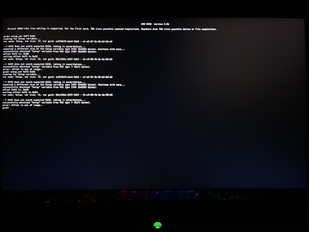

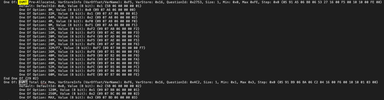

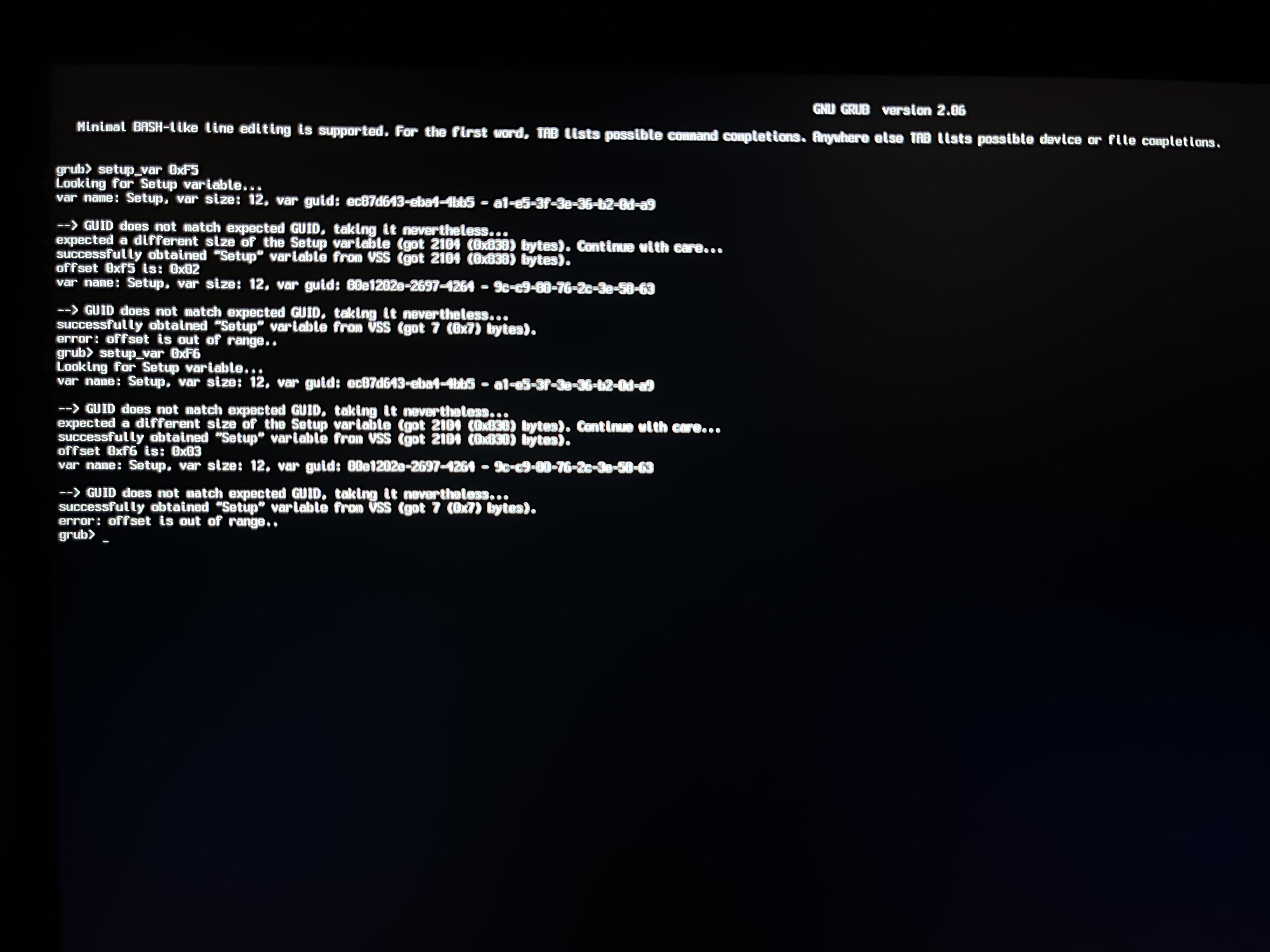

Fortitude Posted May 10, 2023 Author Share Posted May 10, 2023 Hey everyone, I've got quite a bit of an update as I'm now both completely confused and frustrated: I managed to extract the DVMT settings from my own personal ROM file, but when I attempt to modify them with modGRUBShell the offset value appears to change, but the system seems to still be locked to a maximum of 30MB and I require the stolenmem patch in order to boot. I tried both the 60MB and 64MB settings, and even tried setting the DVMT lower than 32MB which didn't affect the iGPU behavior. Does anyone here see the problem, and/or have dealt with similar issues? (It looks like the DVMT preallocated memory was originally set to 0MB which makes me wonder why I'm even able to boot in the first place with the stolenmem patch.) 1 Link to comment https://www.insanelymac.com/forum/topic/356609-igpu-freezes-my-computer-when-enabled/#findComment-2804492 Share on other sites More sharing options...
deeveedee Posted May 13, 2023 Share Posted May 13, 2023 (edited) On 5/9/2023 at 8:00 PM, Fortitude said: It looks like the DVMT preallocated memory was originally set to 0MB Which makes sense if your laptop doesn't use the iGPU for any displays. I'll ask again... why are you trying to patch your iGPU with anything but a connectorless framebuffer if your iGPU is connected only to one Thunderbolt port? Are you trying to patch iGPU for a display connected to the Thunderbolt port? Edited May 13, 2023 by deeveedee 1 Link to comment https://www.insanelymac.com/forum/topic/356609-igpu-freezes-my-computer-when-enabled/#findComment-2804598 Share on other sites More sharing options...
