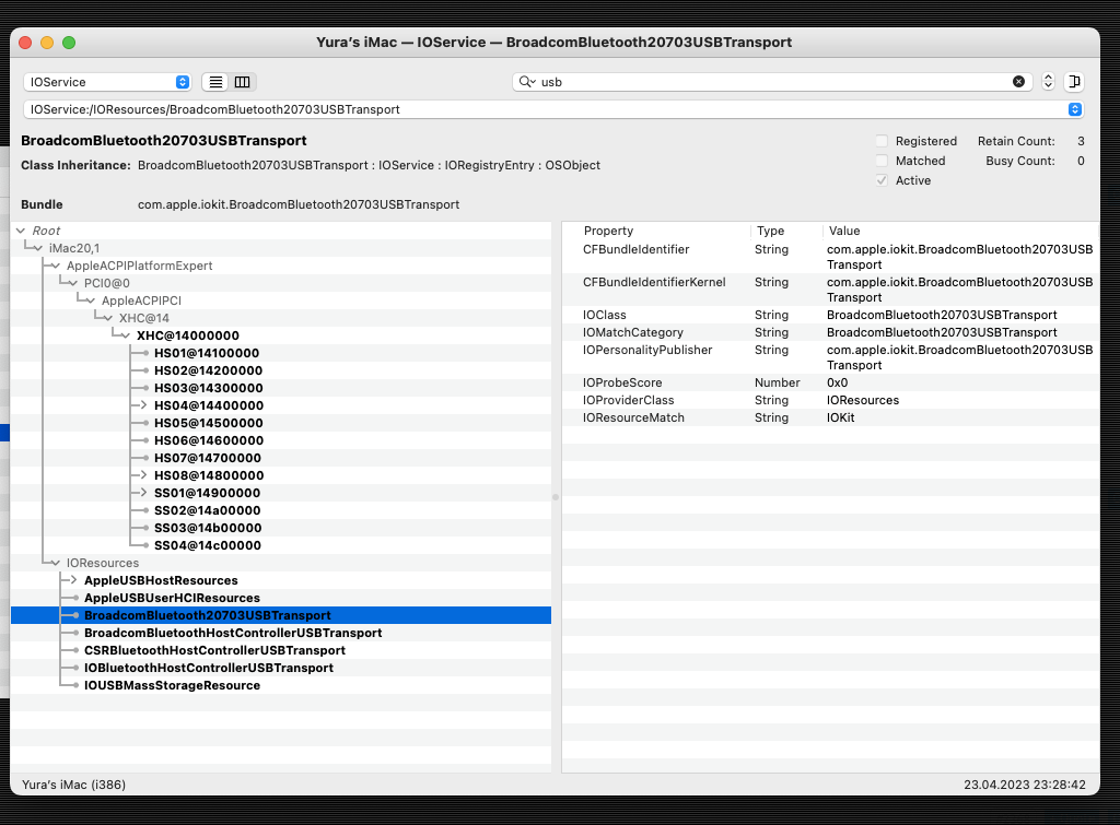

sphinx84 Posted May 6, 2023 Author Share Posted May 6, 2023 14 hours ago, aben said: Have an Apple BCM94360CS2 AirPort card myself (adapted to M.2/NGFF slot) - Continuity features incl. other macOS' BT functions continue to perform phenomenally with no issues in Ventura (tested on a SKL machine running Ventura 13.4 beta 4 - 22F5059b) If you've just installed/replaced the wifi module, then you will most likely need to re-map USB ports (Note: macOS expects BT devices to be connected over USB on an internal header (type 255)). More info on USB mapping here: https://dortania.github.io/OpenCore-Post-Install/usb/manual/manual.html#finding-your-usb-ports I haven't the BT in XHC (ioreg). How to prescribe it? Do you have an example? Link to comment https://www.insanelymac.com/forum/topic/356602-bluetooth-dont-work-on-latest-ventura-beta/#findComment-2804402 Share on other sites More sharing options...

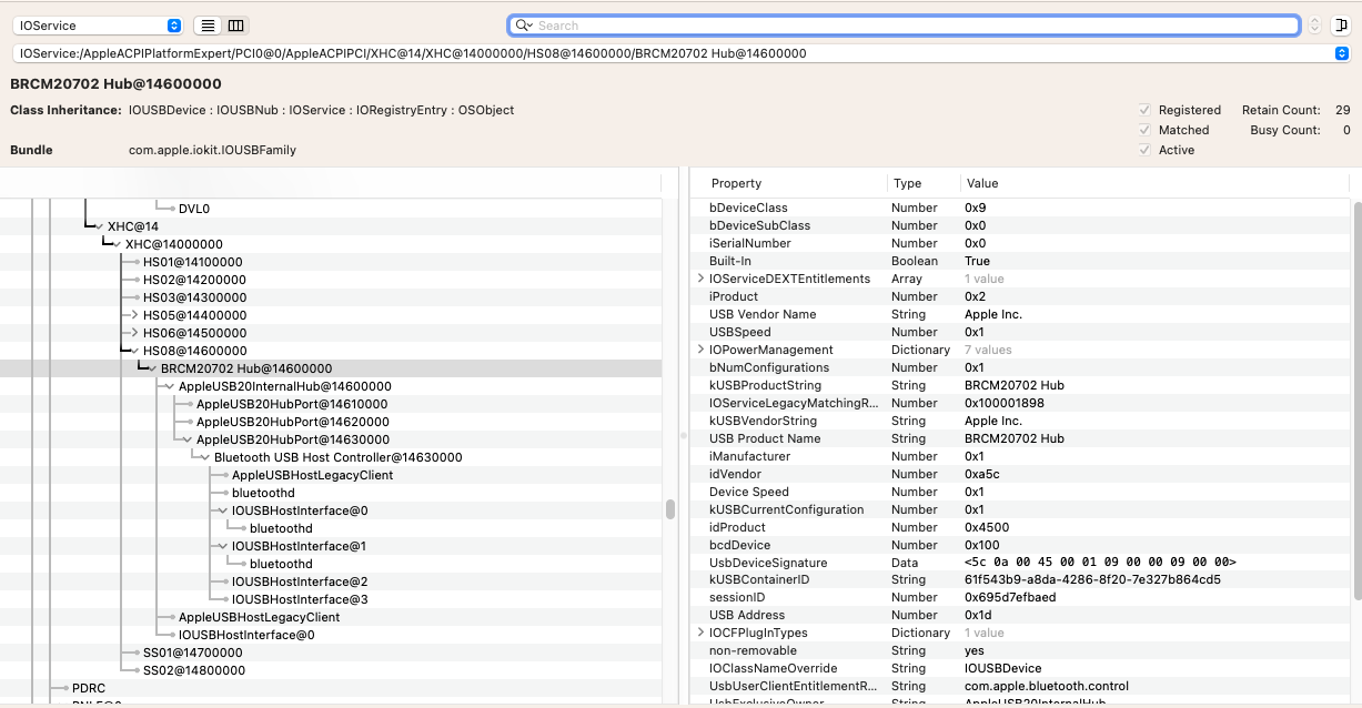

aben Posted May 7, 2023 Share Posted May 7, 2023 6 hours ago, sphinx84 said: I haven't the BT in XHC (ioreg). How to prescribe it? Do you have an example? Native Apple BT in ioreg should look like below (here BT device is seen attaching to port 08). Your screenshot shows no devices populating under USB controller, which explains why BT will remain non-functional until you fix/map BT port: There are two approaches for mapping USB: 1. Kext (tools exists for mapping from Windows as well) 2. ACPI (OS-agnostic) Suggest you follow this guide for fixing/mapping USB: https://github.com/5T33Z0/OC-Little-Translated/tree/main/03_USB_Fixes 1 Link to comment https://www.insanelymac.com/forum/topic/356602-bluetooth-dont-work-on-latest-ventura-beta/#findComment-2804410 Share on other sites More sharing options...
