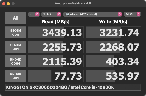

draylax Posted April 6, 2023 Share Posted April 6, 2023 No slow booting as is detailed on every other slow NVMe thread. These NVMe SSDs are connected on a Z490 board as PCIe 3.0 x 4 AmorphousDiskMark showing sustained about 3,400 3,200 M bytes/sec for R/W Copying loads of mp4 video files from GoPro, mixed sizes of video files around 1GB to about 4.5GB terminal rsync for the copying rsync -a --progress --stats --human-readable Real world, is not even close to 3,200 M bytes/sec that AmorphousDiskMark results show, slower that SATA theoretical max sustained. What i'm seeing in real life copying: Kingston KC3000 2TB SATA to SATA 220.76M bytes/sec HFS+ to HFS+ NVMe to SATA 226.58M bytes/sec HFS+ to HFS+ SATA to NVMe 232.44M bytes/sec HFS+ to HFS+ NVMe to NVMe 421.05M bytes/sec APFS to HFS+ NVMe to NVMe 412.64M bytes/sec HFS+ to APFS NVMe to NVMe 417.64M bytes/sec APFS to APFS WD SN850X 2TB NVMe to NVMe APFS to APFS (KC3000 to SN850X) 410.18M bytes/sec I'm expecting much higher. Similar for others? Any ideas why so slow? Link to comment Share on other sites More sharing options...
