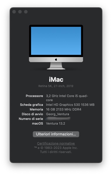

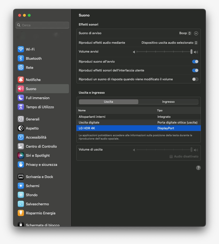

hoenstaufen Posted February 16, 2023 Share Posted February 16, 2023 (edited) Succeded in installing macOS Ventura (13.1 updated to 13.2) on old Lenovo M710s ThinkCentre (Skylake cpu) using Dortania OpenCore Install Guide. After many years and many Macs, I decided to try this guide, which has revealed itself as excellent. The whole installation process was really very easy, on my old system, and I could rapidly reach the post-installation phase. I DID NOT use configurators, as suggested by the guide. Difficulties arose by the need of spoofing my skylake cpu as "the closest kabylake model". Eventually, I got everything properly functioning, graphics, ethernet, sound, screen saver. Only marginal Wifi (works only on safe mode), but I'm going, probably, to buy a compatible BCM94360CD wifi/Bluetooth adapter. A last lesser issue remains. The ONLY tools I used were those suggested by the Guide: MountEFI command ProperTree command USBMap command IORegistryExplorer command Lenovo M710s info_dump.txt Edited February 17, 2023 by hoenstaufen reserved info were showing 1 Link to comment https://www.insanelymac.com/forum/topic/355707-macos-ventura-131-install-on-lenovo-m710s-thinkcentre-desktop-i5-6500/ Share on other sites More sharing options...
