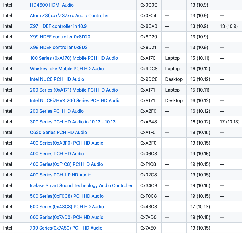

This is resolved by adding the device-id = C8340000 (Data) property to the PciRoot(0x0)/Pci(0x1F,0x3) entry in Config.plist - DeviceProperties.
The Device ID (0x34C8) of the Ice Lake-LP Smart Sound Technology Audio Controller is applied to HDEF, which is recognized and operated by AppleALC.

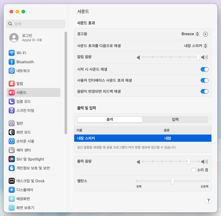

The Samsung Galaxy Book (NT750XDA-KF59U) model is a Realtek ALC 256 codec, so I use layout-id = 70.
I could see that the built-in speaker was activated and the sound output was good in the system settings of macOS.
