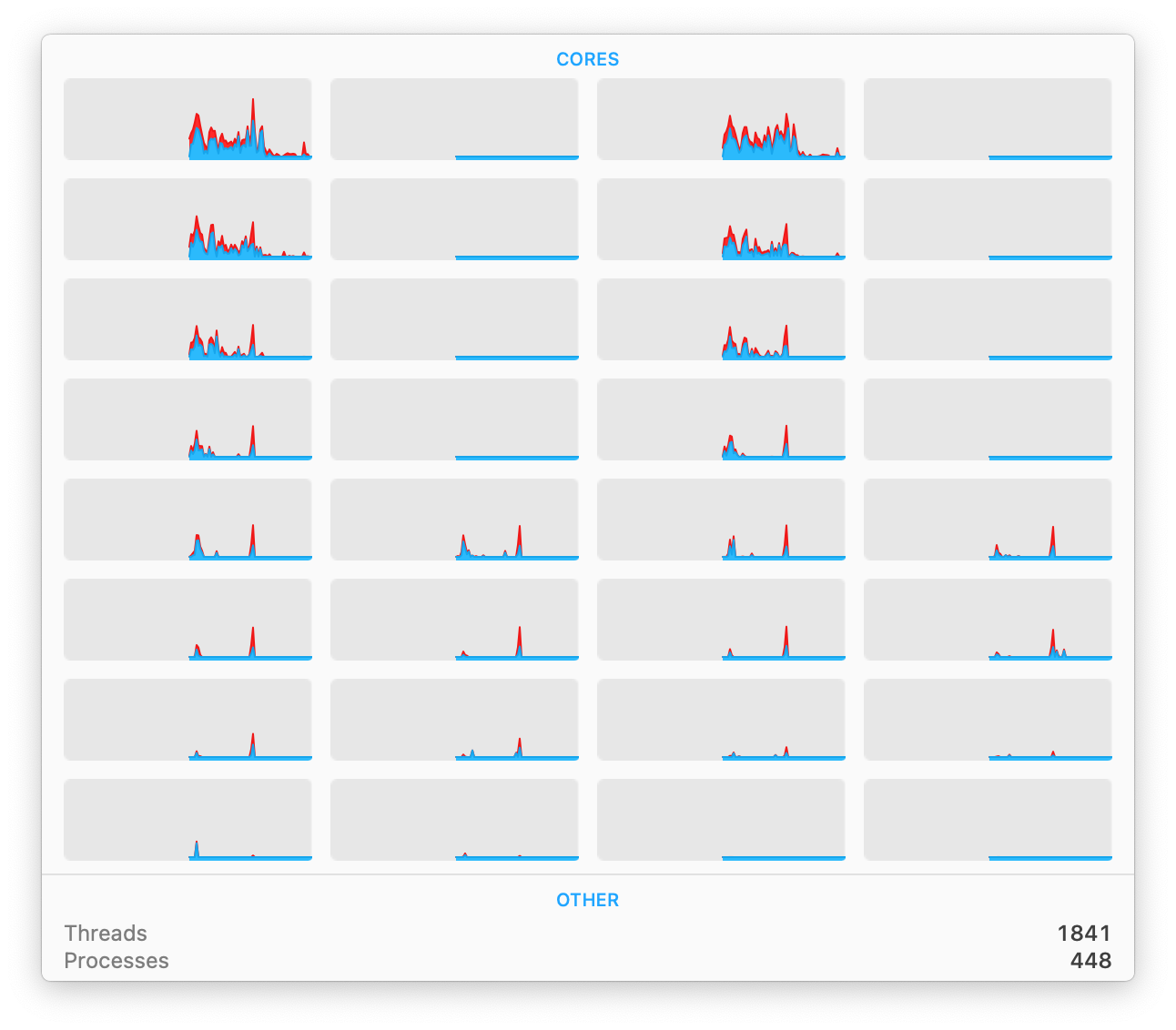

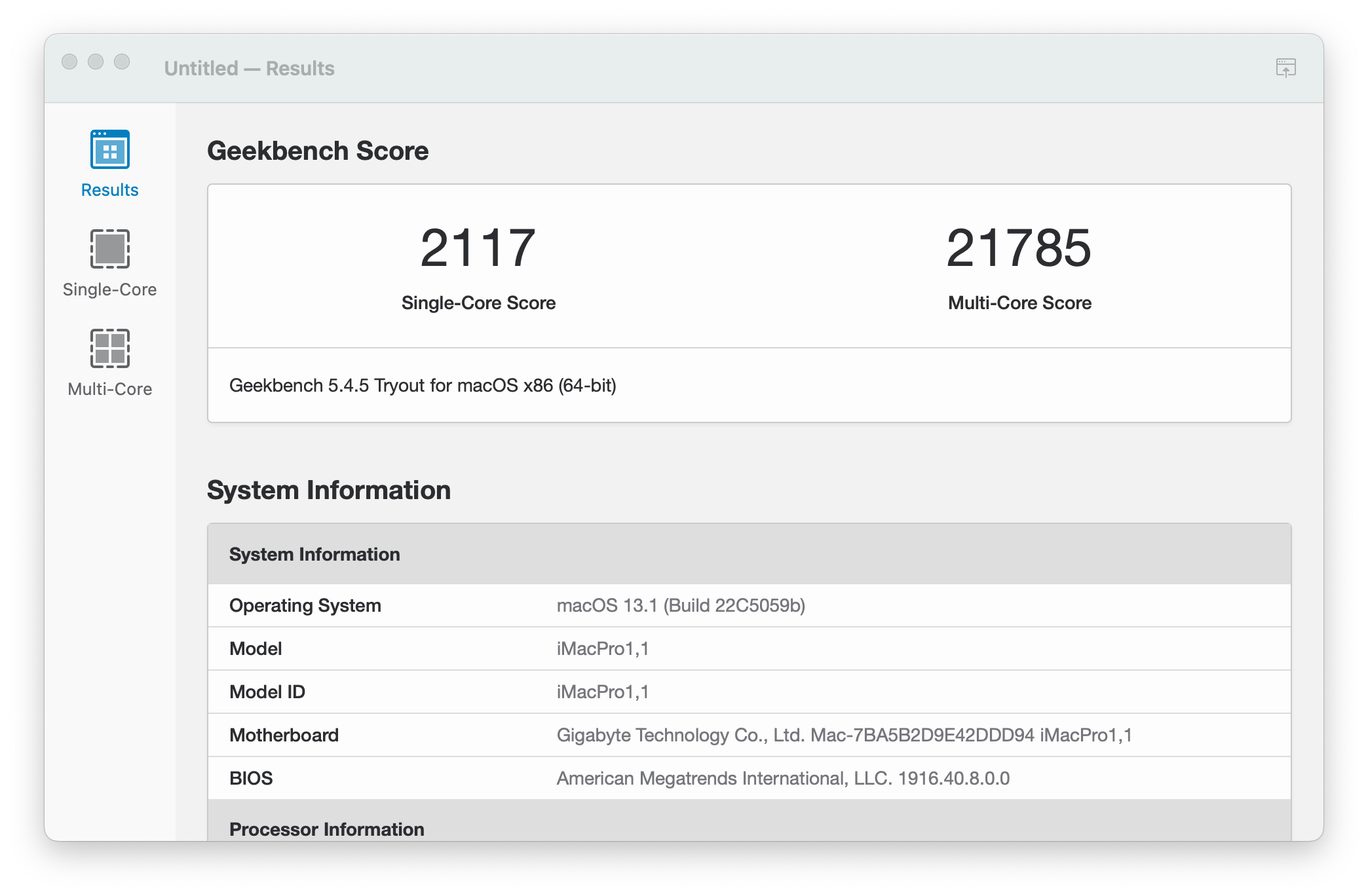

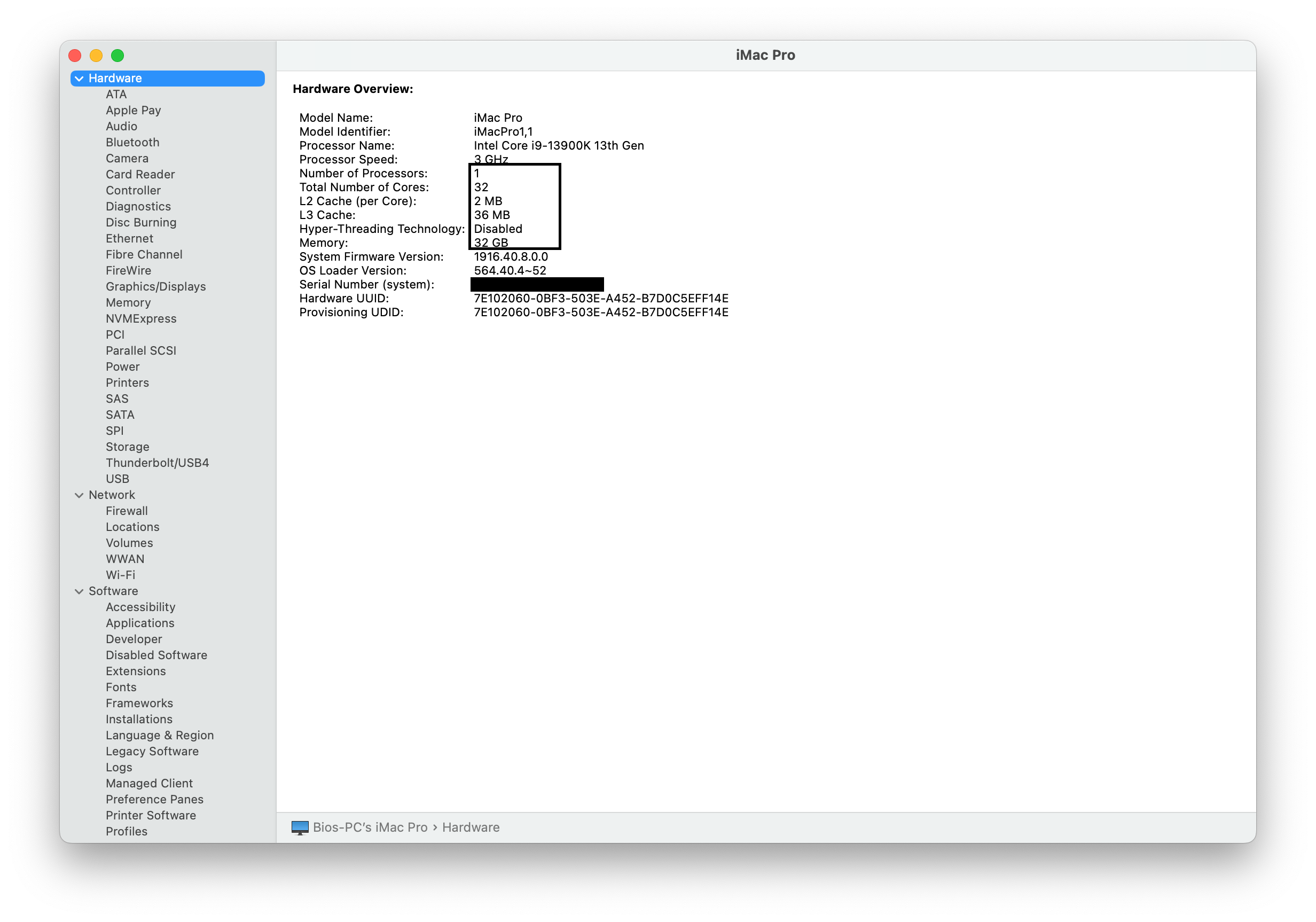

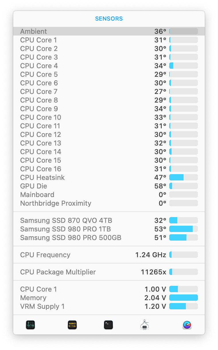

Bios-PC Posted December 3, 2022 Share Posted December 3, 2022 Hello everyone After one month with this hardware checking every single option in the bios for stability, First of all big thanks to @MaLd0n , make custom ssdt for my motherboard. I can use general ssdt from opencore but still feel not stable and laggy. so for those who have the same hardware I share my results. with hyperthreding disabled and don't use cputopologyrebuild.kext the system sable but laggy sometime and benchmark for single core little bit higher but multicore so bad result. when hyperthreding enabled with vmx full support , with cputopologyrebuild.kext the system stable and the benchmark put every apple cpu down in the list. still have one problem trying to fix sleep/wake . but for now I'm so glad not buying apple studio and still believe on intel hardware. 4 1 Link to comment https://www.insanelymac.com/forum/topic/354975-ventura-on-z790-aero-g-i9-13900k-amd-6900xt/ Share on other sites More sharing options...
