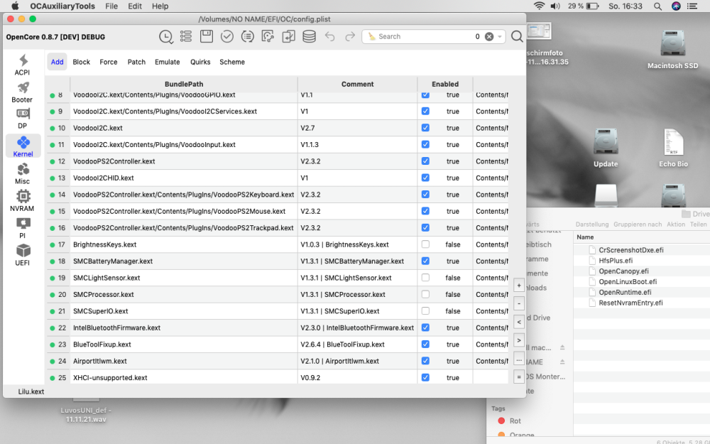

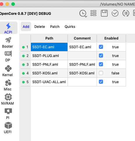

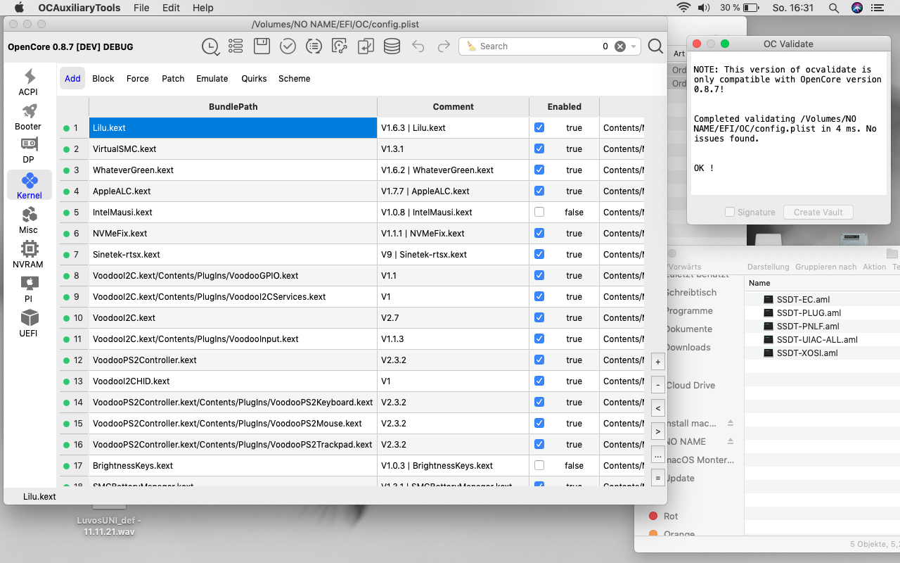

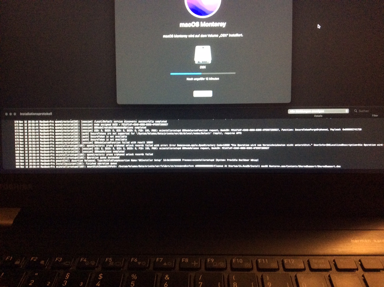

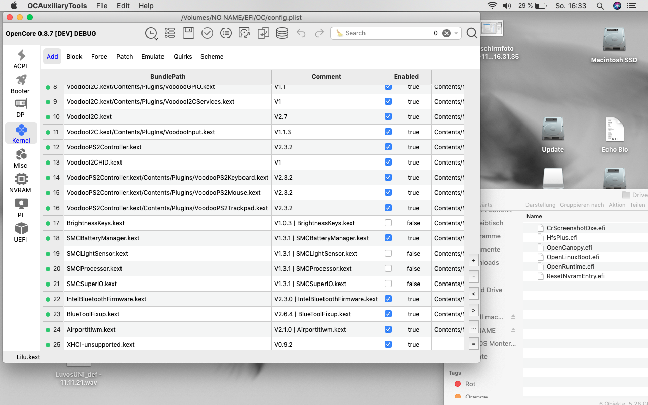

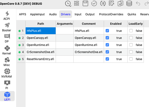

I made with the help of the German Hackintosh Forum a OC 7.8 install stick, which boots nice, I can start the installer, but it stops always on the same point - 12 min to finish - see picture - here the text from the picture as fare I can read it....
osinstallersetupd: opendirectory: prune orphaned unlock records failed
Installassistant: Finished operation queue
osinstallersetupd: mountDiskImageWithPath: /Sytem/Volumes/Data/private//var/folders/zz/zvxyvs????csfxvn n000000000/Cleanup At Sturtup/IA???? macOS Montery.as?/Contents/SharedSupport/SharedSupport.dmg
We thought, that this is a problem of the built in NVME Samsung PM961 MZVLW256HEHP - so I changed it to a Kingston NV2 NVME, which has a Phison E21T controller, Phison controllers are recommended by Dortania. But it stops at the same point.
The funny thing - the installer recognizes both disks, I can format both, it copies the files to the disk (I can read them), but very short time, bevor the first reboot, it stops.
Maybe you have an idea what is the reason? The Kingston NV2 is known to work in a small desktop Hackintosh.
