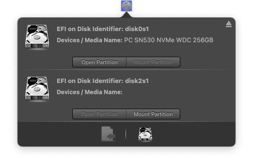

marsuss Posted October 7, 2022 Share Posted October 7, 2022 (edited) Hi, I bought this Toshiba KXG60ZNV1T02 some time ago but I don't know what to do to make this ssd work on Monterey. I have NvmeFix.kext in OC folder but unfortunately won't work. Can someone help me please? Thank you for any help. Edited October 7, 2022 by marsuss Link to comment https://www.insanelymac.com/forum/topic/354254-toshiba-kxg60znv1t02/ Share on other sites More sharing options...

marsuss Posted October 7, 2022 Author Share Posted October 7, 2022 (edited) Is exactly the same. I can't install macOS if I plug ssd in to the laptop slot. Only works when is plugged in to the enclosure but for some reason I can't do an update to newest macOS version no matter if it's eg. 12.6 or 13 its just hangs after 1 stage. I can't even see drive name in OCC. Edited October 7, 2022 by marsuss Link to comment https://www.insanelymac.com/forum/topic/354254-toshiba-kxg60znv1t02/#findComment-2794594 Share on other sites More sharing options...
