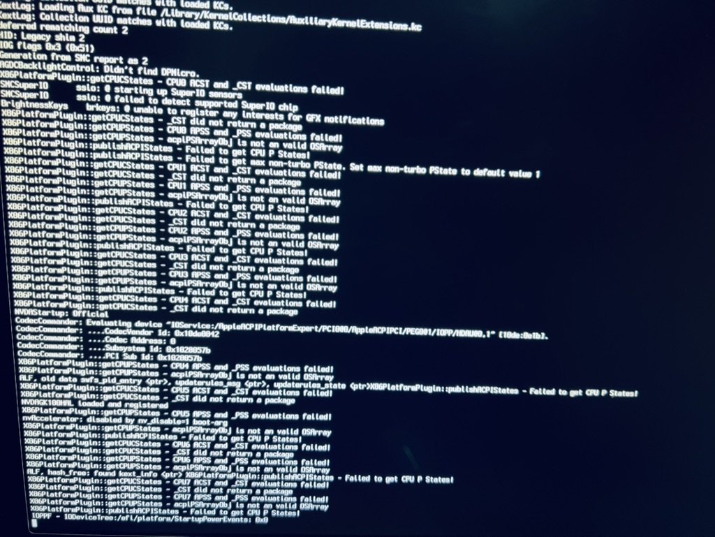

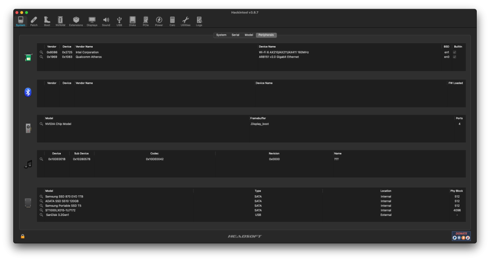

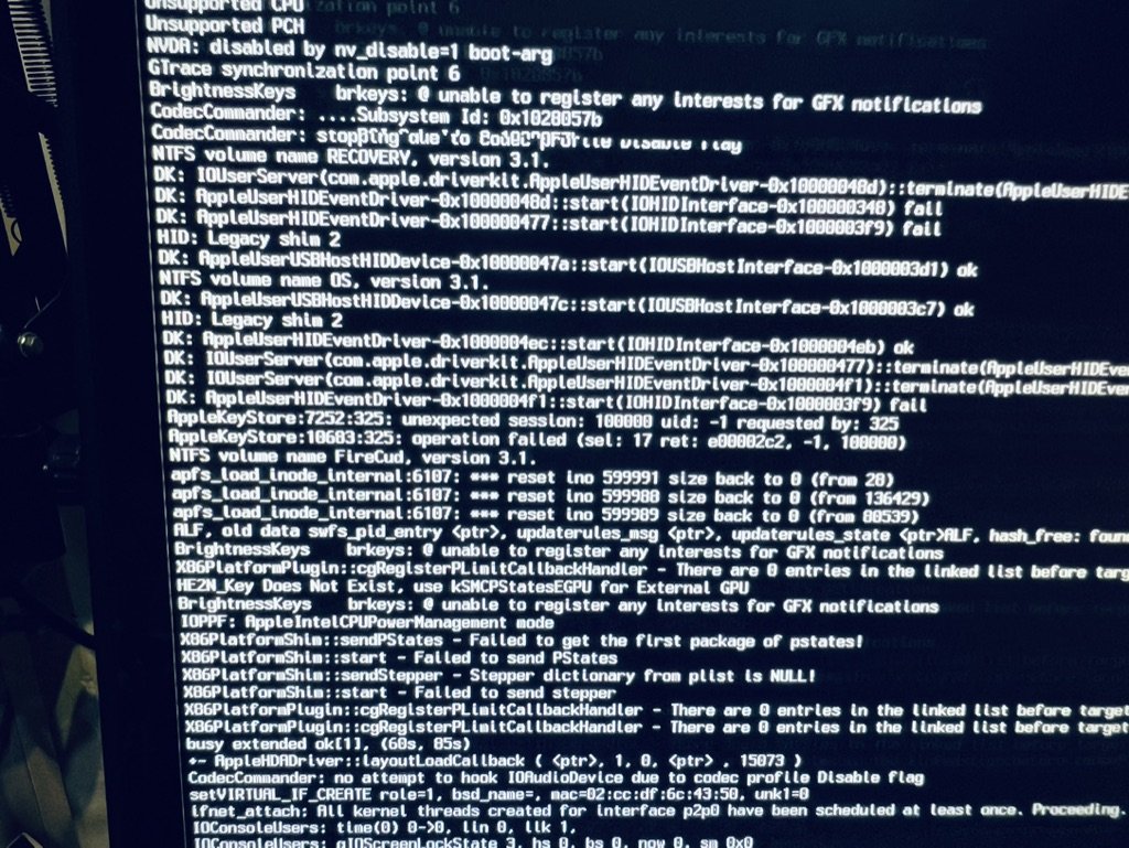

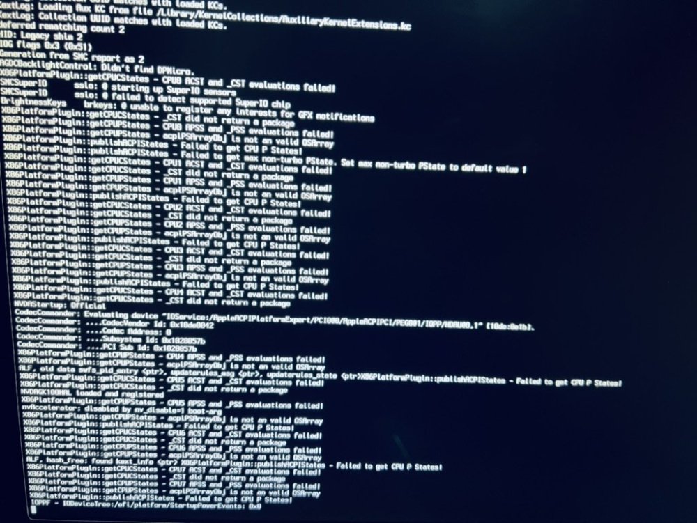

cccsskit Posted October 6, 2022 Share Posted October 6, 2022 (edited) Hello,i am a newb of this, just make around 3 days to make it installed and 3days to diy the whole EFI to complete the kext. now I have a few problems asking 1.Killer 1675X the BT not detected but wifi work 2.I am Using the 120hz 3D Panel that will be drive dGPU(GTX 660M(GK107M) only, while the ID is 0FD4 but can't reconlized by not using nv_disable=1 and no signal,how can I make my card work?even can't boot if I define it in DeviceProperties PciRoot(0x0)/Pci(0x1,0x0)/Pci(0x0,0x0) AAPL,slot-name;Internal@0,1,0/0,0 device_type;VGA compatible controller model;GK107M [GeForce GTX 660M] I have tested the 60hz Panel and active the iGPU also nv_disable=1 also make the iGPU VRAM=7MB and no acceleration(like fake) if no flag it will have no signal, even the cursor of black screen 3.Monitor EDID not correct 4.SB Recon3Di I sound card can't detect with AppleALC in ALC=11.The CodecCommander cant make it work VoodooHDA can drive it but SliderVolume is not work(kext option set to true already) Install id: HDAUDIO\FUNC_01&VEN_1102&DEV_0011&SUBSYS_1458A016&REV_1009\4&6C8D95D&0&0201 Hardware id: USB\VID_0C76&PID_1607&REV_0100&MI_00 5.some minor problem CPUpm unsupported CPU unsupported PCH ----------- I am most concerned about the GPU, it can barely use only ,so laggy X( thank you for reading and please give me some help. config.plist DSDT.aml ACPI.zip Edited October 13, 2022 by cccsskit Quote Link to comment https://www.insanelymac.com/forum/topic/354252-hello-new-comer-hereneed-some-help-for-m17x-r4-of-big-suroc/ Share on other sites More sharing options...

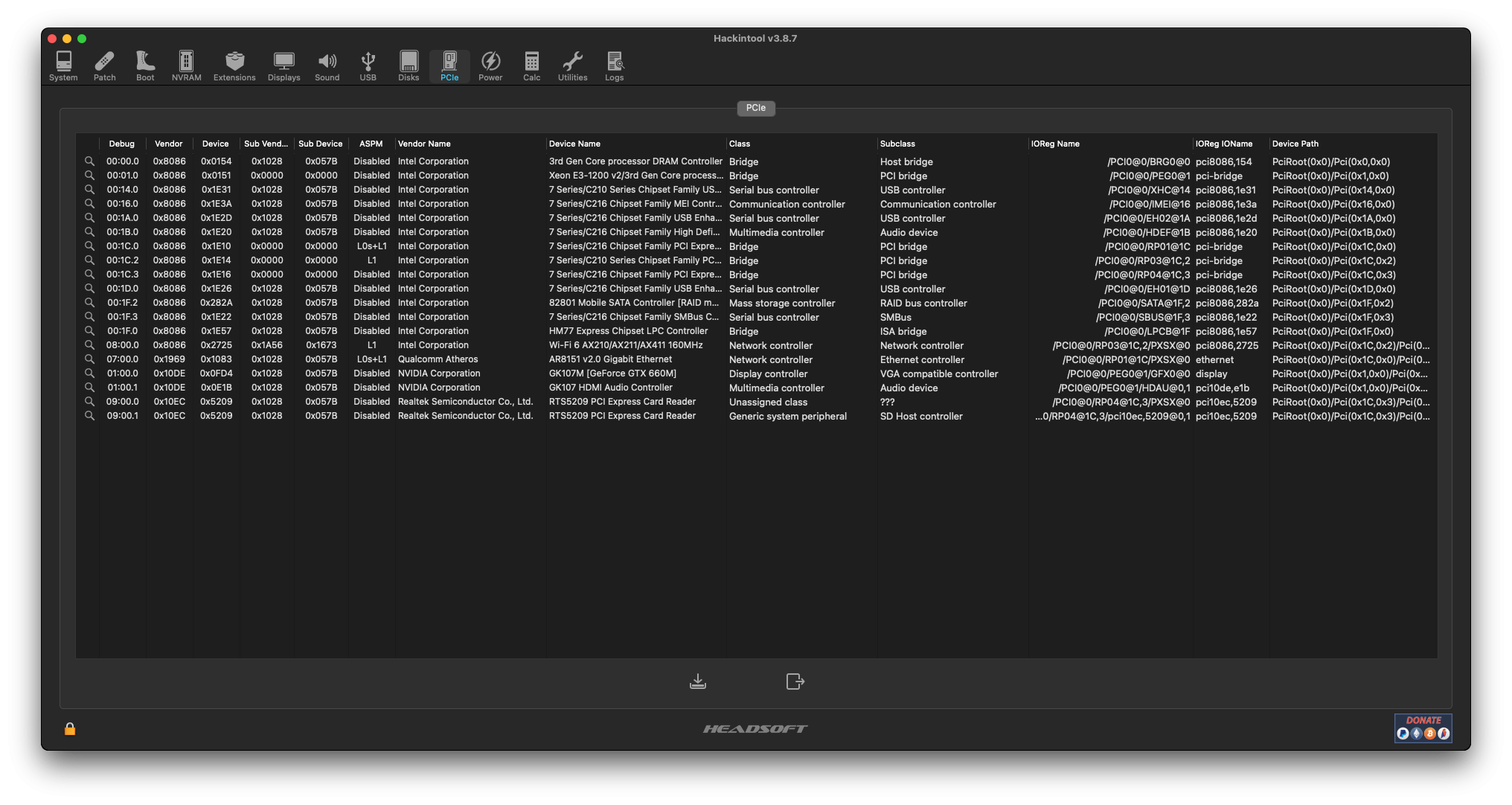

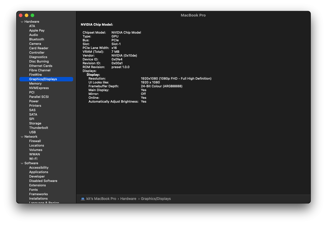

cccsskit Posted October 11, 2022 Author Share Posted October 11, 2022 (edited) hackintosh tool Device details listed i have some progress about GPU at DeviceProperties PciRoot(0x0)/Pci(0x1,0x0)/Pci(0x0,0x0) device-id;(bland) or not d40f(GTX660M) it can boot without nv_disable=1(but in d40f is bland screen,wired) system information said No kext loaded even i put in OC>Kext to force loaded Edited October 11, 2022 by cccsskit Quote Link to comment https://www.insanelymac.com/forum/topic/354252-hello-new-comer-hereneed-some-help-for-m17x-r4-of-big-suroc/#findComment-2794854 Share on other sites More sharing options...

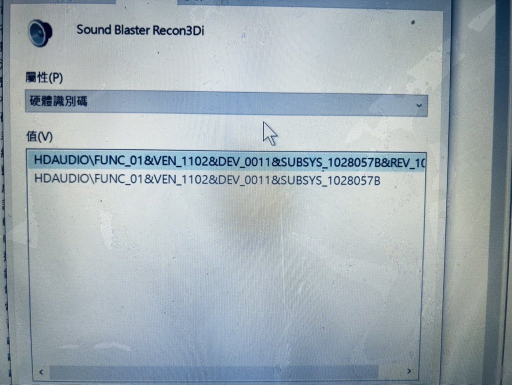

BillDH2k Posted October 11, 2022 Share Posted October 11, 2022 (edited) 9 hours ago, cccsskit said: thx for reply Excuse me,is these patch for the sound card? This is required to make AppleALC to work with your on-board audio (from the C216 chipset). But I realized this may not apply to you, since your Dell laptop audio output may be wired to the Sound Blaster chip instead. There was a macOS 10.11 driver from Creative website, just google "sound blaster recon3d macOS driver". You may want to give it a try. You may also need to spoof the device-id to make it work for the OEM hardware. Edited October 11, 2022 by BillDH2k 1 Quote Link to comment https://www.insanelymac.com/forum/topic/354252-hello-new-comer-hereneed-some-help-for-m17x-r4-of-big-suroc/#findComment-2794887 Share on other sites More sharing options...
cccsskit Posted October 11, 2022 Author Share Posted October 11, 2022 (edited) 50 minutes ago, BillDH2k said: This is required to make AppleALC to work with your on-board audio (from the C216 chipset). But I realized this may not apply to you, since your Dell laptop audio output may be wired to the Sound Blaster chip instead. There was a macOS 10.11 driver from Creative website, just google "sound blaster recon3d macOS driver". You may want to give it a try. You may also need to spoof the device-id to make it work for the OEM hardware. okay,lets try yes,that is a CA0132 Edited October 11, 2022 by cccsskit Quote Link to comment https://www.insanelymac.com/forum/topic/354252-hello-new-comer-hereneed-some-help-for-m17x-r4-of-big-suroc/#findComment-2794889 Share on other sites More sharing options...

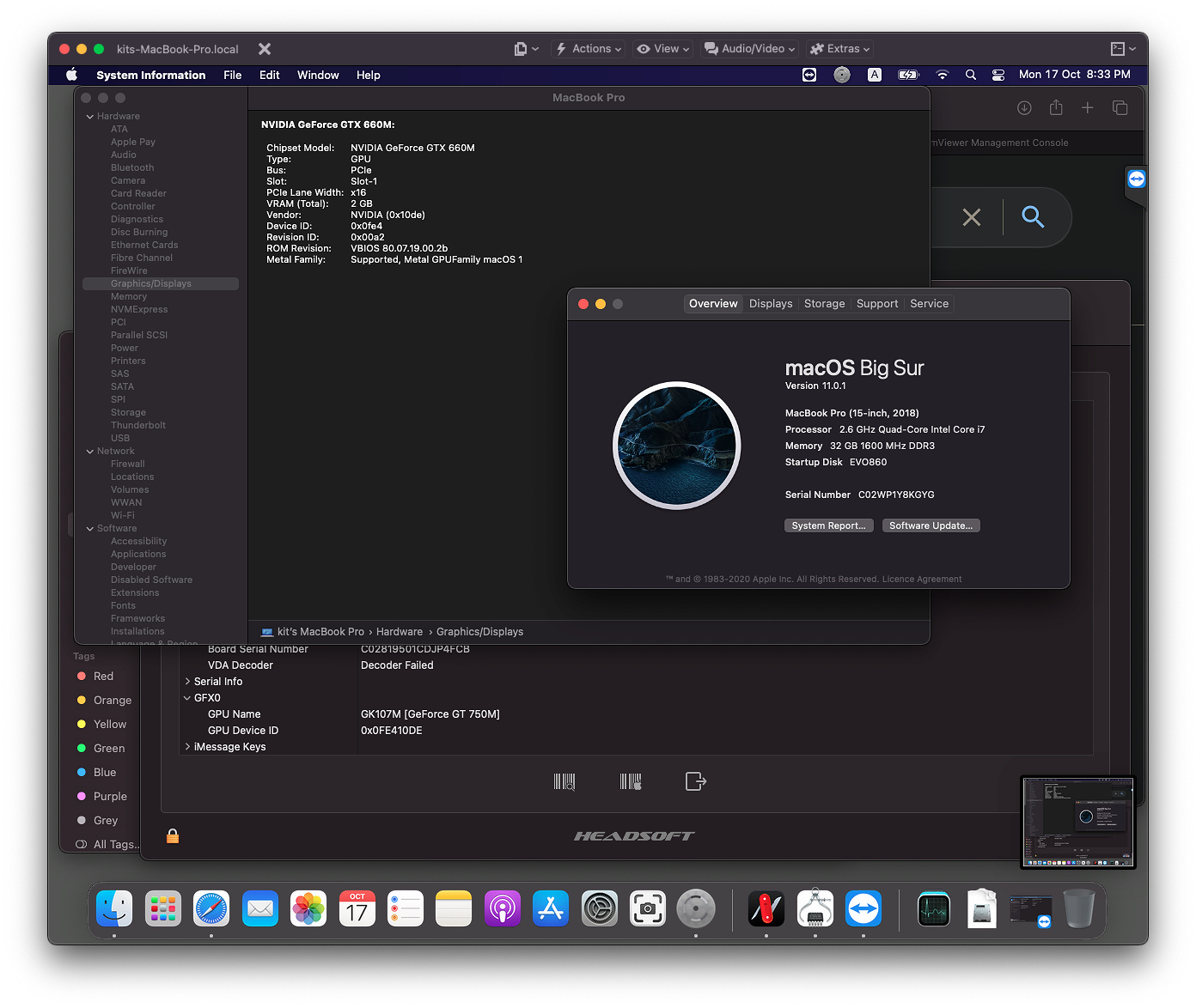

BillDH2k Posted October 11, 2022 Share Posted October 11, 2022 7 hours ago, cccsskit said: hackintosh tool Device details listed i have some progress about GPU at DeviceProperties PciRoot(0x0)/Pci(0x1,0x0)/Pci(0x0,0x0) device-id;(bland) or not d40f(GTX660M) it can boot without nv_disable=1(but in d40f is bland screen,wired) system information said No kext loaded even i put in OC>Kext to force loaded You may try to fake the GPU device-id to GTX 750M (GK107), as it is supported by Apple in their 2013 MacPro. Googled show two possible ID's: 0x0FE4, 0x0FE9. Try both of them. Enter "E40F' or "E90F" in the device-id field (reversed byte). Quote Link to comment https://www.insanelymac.com/forum/topic/354252-hello-new-comer-hereneed-some-help-for-m17x-r4-of-big-suroc/#findComment-2794891 Share on other sites More sharing options...
cccsskit Posted October 12, 2022 Author Share Posted October 12, 2022 13 hours ago, BillDH2k said: You may try to fake the GPU device-id to GTX 750M (GK107), as it is supported by Apple in their 2013 MacPro. Googled show two possible ID's: 0x0FE4, 0x0FE9. Try both of them. Enter "E40F' or "E90F" in the device-id field (reversed byte). when i modded the kext became blended, and restore back the kext it suddenly cant boot with nv_disable again =( i dun know what is going on about the kext. so while in disabling, the GPU is recognized but not correctly either i spoofed to 750M already.why? Ofcause it will be blended without it. Quote Link to comment https://www.insanelymac.com/forum/topic/354252-hello-new-comer-hereneed-some-help-for-m17x-r4-of-big-suroc/#findComment-2794958 Share on other sites More sharing options...
BillDH2k Posted October 12, 2022 Share Posted October 12, 2022 11 hours ago, cccsskit said: when i modded the kext became blended, and restore back the kext it suddenly cant boot with nv_disable again =( i dun know what is going on about the kext. May be you need to do a NVRAM reset/clear? 1 Quote Link to comment https://www.insanelymac.com/forum/topic/354252-hello-new-comer-hereneed-some-help-for-m17x-r4-of-big-suroc/#findComment-2794983 Share on other sites More sharing options...
cccsskit Posted October 13, 2022 Author Share Posted October 13, 2022 (edited) Oh,I am always forgot to do this. Tried to reset the nvram , still blended if i add AAPL,slot-name;Internal@0,1,0/0,0 it will get a SMC error Edited October 13, 2022 by cccsskit Quote Link to comment https://www.insanelymac.com/forum/topic/354252-hello-new-comer-hereneed-some-help-for-m17x-r4-of-big-suroc/#findComment-2795024 Share on other sites More sharing options...

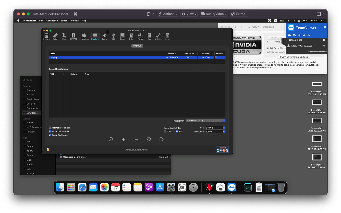

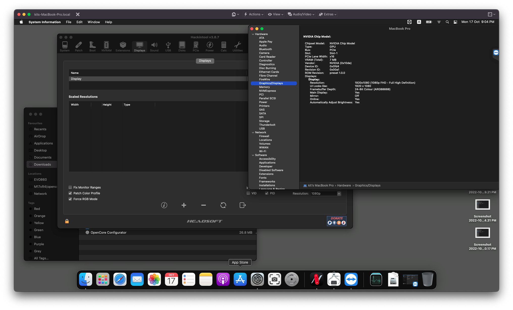

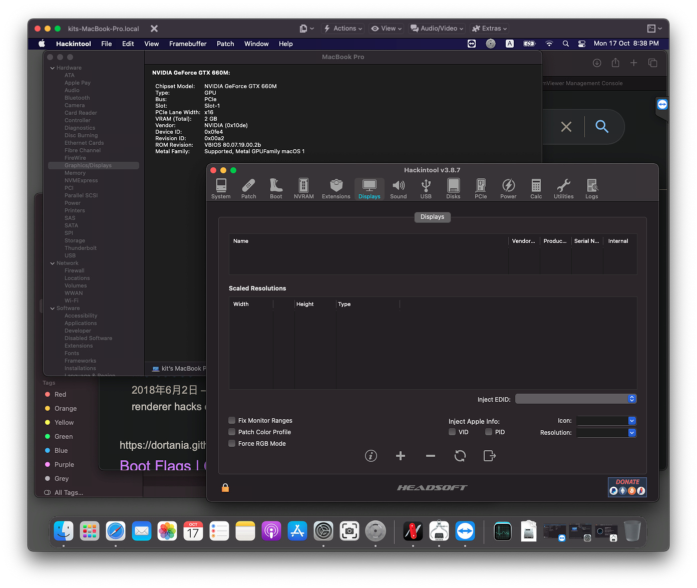

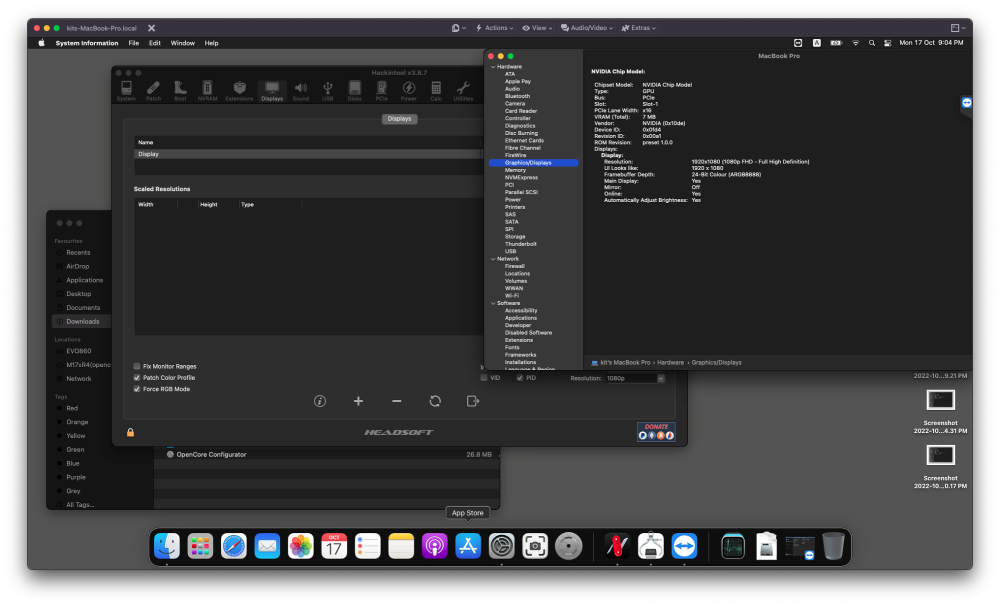

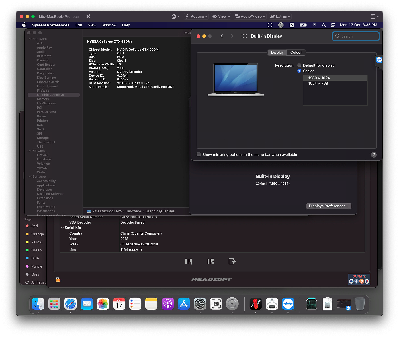

cccsskit Posted October 17, 2022 Author Share Posted October 17, 2022 finally,some one teach me to use remote to see the result.so here it is. Physically bland display. system detection error,overview didnt show the card in System info show GTX 660M but id is 750M even i spoofed. seems like have full accelerated but cant connected to a monitor. great news! Quote Link to comment https://www.insanelymac.com/forum/topic/354252-hello-new-comer-hereneed-some-help-for-m17x-r4-of-big-suroc/#findComment-2795299 Share on other sites More sharing options...

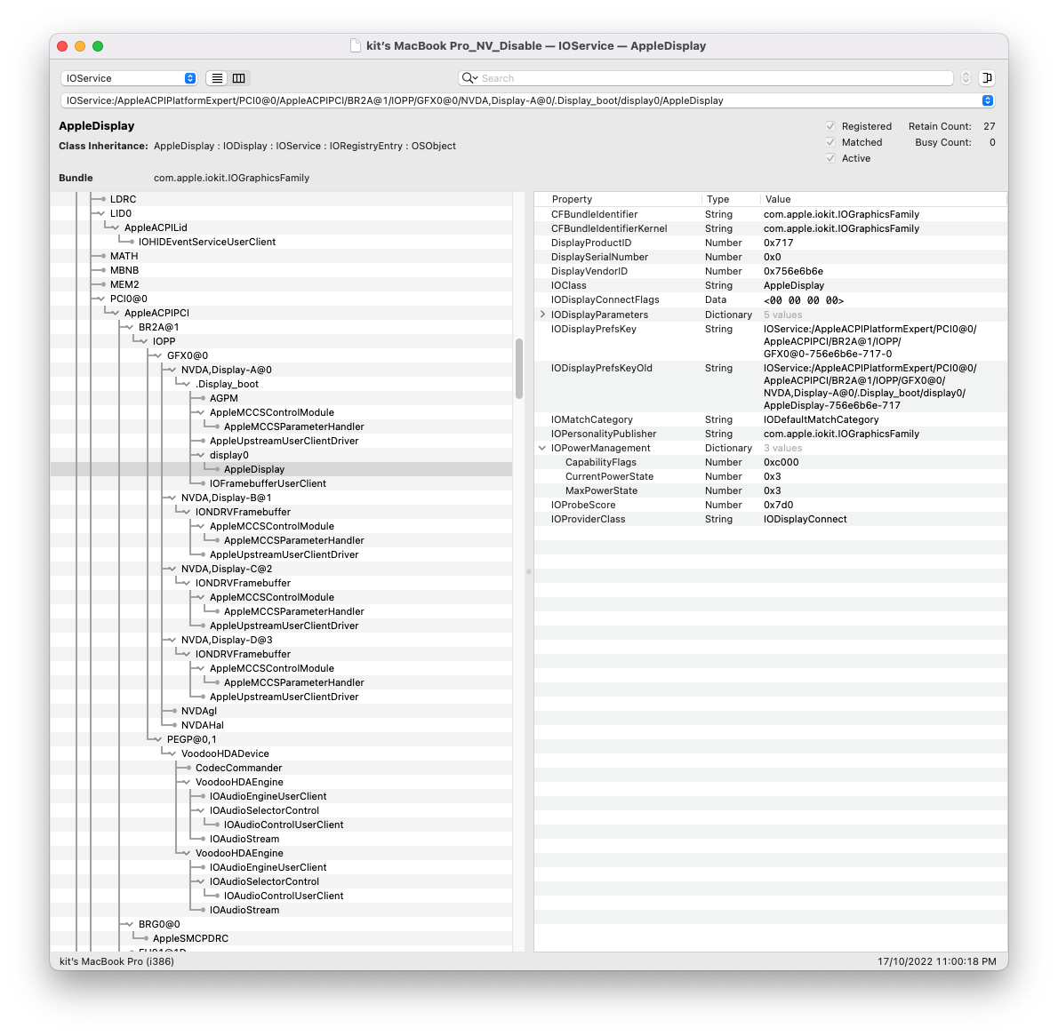

cccsskit Posted October 17, 2022 Author Share Posted October 17, 2022 nvdisable the display info,so next step? Quote Link to comment https://www.insanelymac.com/forum/topic/354252-hello-new-comer-hereneed-some-help-for-m17x-r4-of-big-suroc/#findComment-2795300 Share on other sites More sharing options...
cccsskit Posted October 17, 2022 Author Share Posted October 17, 2022 (edited) kit’s MacBook Pro_full.ioreg kit’s MacBook Pro_NV_Disable.ioreg here os the IOReg Edited October 19, 2022 by cccsskit Quote Link to comment https://www.insanelymac.com/forum/topic/354252-hello-new-comer-hereneed-some-help-for-m17x-r4-of-big-suroc/#findComment-2795306 Share on other sites More sharing options...
cccsskit Posted October 19, 2022 Author Share Posted October 19, 2022 process update log i try to add EDID to GFX0 and Display-A@0 still dont make it work =( i dun know what to do now my panel is LP173WF2-TPA1 EDID is 00 ff ff ff ff ff ff 00 30 e4 c5 02 00 00 00 00 01 14 01 04 95 26 15 78 02 5f 35 a4 58 56 9e 26 0f 50 54 00 00 00 01 01 01 01 01 01 01 01 01 01 01 01 01 01 01 02 3a 80 18 71 38 2d 40 58 2c 45 00 7e d7 10 00 00 1b d4 9a 80 c8 73 38 24 41 30 20 35 00 7e d7 10 00 00 1b d4 9a 80 c8 73 38 a8 40 30 20 35 00 7e d7 10 00 00 d4 9a 80 c8 73 38 40 40 30 20 35 00 7e d7 10 00 00 1b 01 27 Quote Link to comment https://www.insanelymac.com/forum/topic/354252-hello-new-comer-hereneed-some-help-for-m17x-r4-of-big-suroc/#findComment-2795508 Share on other sites More sharing options...
