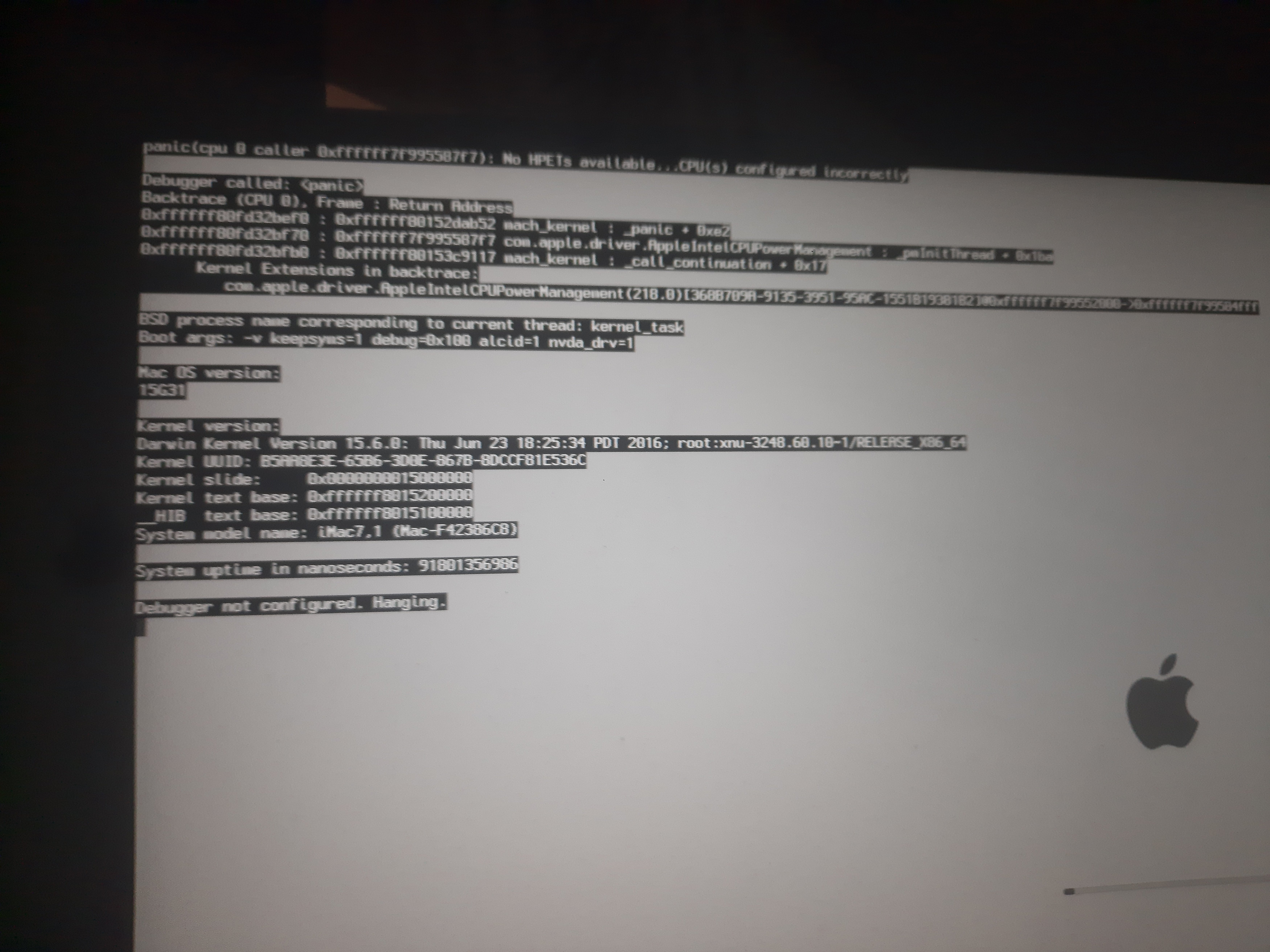

Hello,
I am having a Kernel Panic where it describes that I have No HPET's available. It also describes that something is associated with AppleIntelCPUPowerManagement. However, I have a dumped DSDT.
I switched from Pre-Made Clover to a custom built OpenCore, and that's the error I am having. I will also link my EFI folder in the post. I'm also trying to install 10.11 (El Capitan)
Thanks.

48 minutes ago, MaLd0n said:
try
AppleCpuPmCfgLock
Alright.
Edited by inusebyanothermember
3 minutes ago, inusebyanothermember said:
Do I need to add those drivers into my efi folder? I see you stated AppleCpuPmCfgLock but I don't understand what do you mean.
Yes. is a basic drivers.
idk if u need OpenUsbKbDxe
I tried to add drivers and it just made hanging critical error. However, removing it causes the same No HPET'S available. (i made the applecpupwrlock on true)
2 hours ago, MaLd0n said:
u need try with full efi folder above
some things just work with correct bootloader version
Won't it break my hackintosh? Because I have a completely different cpu and motherboard.
My motherboard is Asus P5B-VM SE and the cpu is 2 Duo E6850.
T9
1 hour ago, MaLd0n said:
test it one usb stick
these files in efi folder, acpi for example is from ur mobo from first post in this topic. i just patched
Thanks for the nice menu, but it didn't work. I was stuck on the No HPET's available again.
28 minutes ago, MaLd0n said:
try with hpet quirk
don't use merge files and dont use drag and drop into efi partition
Thank you!!! The recovery boots now!
