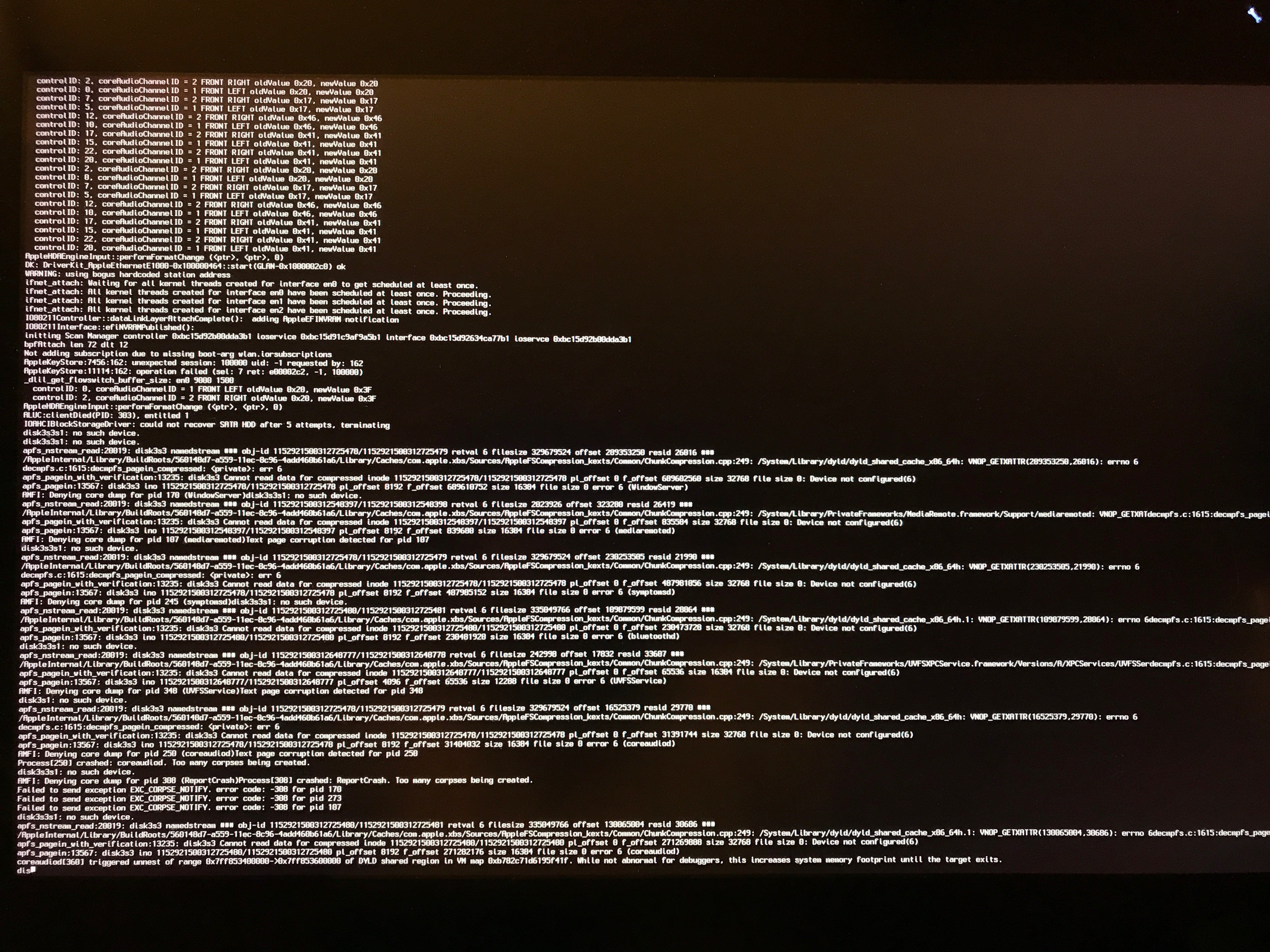

Foxy Gekkerson Posted June 29, 2022 Author Share Posted June 29, 2022 On 6/20/2022 at 3:14 AM, 5T33Z0 said: @Foxy Gekkerson There were servere formal errors in this config. Please use OpenCore Auxiliary tools for editing the config and updating kexts, drivers and OpenCore next time. EFI.zip 4.5 MB · 1 download I rebuilt OpenCore from scratch using OCAT instead of ProperTree. The boot process now gets past [EB|#LOG:EXITBS:START], but I'm still not able to get into my primary Mac drive. I can get into a rescue copy of macOS installed on an HDD, but there's no response from the keyboard or mouse, so I can't log in. The rescue HDD isn't my primary macOS partition anyway. The attached screenshot shows where the boot process now gets stuck when I try booting into my macOS SSD. In case my storage configuration is relevant, my motherboard is again the ASRock Z590 Extreme. My Winows SSD is on a Samsung MZVPV256HDGL m.2 stick in the m2_2 slot directly in the motherboard. My macOS SSD is on a Kingston Predator 240 GB m.2 stick in its included m.2-to-PCIE adapter in the PCIE_3 slot. I also have five HDDs connected to all the motherboard's SATA ports except SATA3_1. The motherboard's manual says on Page 5 that if there's an m.2 drive in slot m2_2, SATA3_1 will be disabled; I have nothing connected to it. It also says that if m2_3 is occupied, SATA3_4 and SATA3_5 will also be disabled. Foxy Gekkerson EFI 6-28-22.zip Link to comment https://www.insanelymac.com/forum/topic/352300-opencore-z590-stuck-on-stuck-on-eblogexitbsstart/#findComment-2787509 Share on other sites More sharing options...
Guest 5T33Z0 Posted June 29, 2022 Share Posted June 29, 2022 (edited) @Foxy Gekkerson Add boot-arg amfi_get_out_of_my_way=1 Keyboard issues could be related to USB. Add this updated version of USBInject all and enable it: https://github.com/daliansky/OS-X-USB-Inject-All/releases If this doesn't help, add OpenUsbKbDxe.efi to drivers (it's included in the OpenCore pkg) Edited June 29, 2022 by 5T33Z0 Link to comment https://www.insanelymac.com/forum/topic/352300-opencore-z590-stuck-on-stuck-on-eblogexitbsstart/#findComment-2787517 Share on other sites More sharing options...
MaLd0n Posted June 29, 2022 Share Posted June 29, 2022 Use this EFI folder with some observations: EFI Foxy Gekkerson.zip -Use USB2 port for easy installation with no remap USB -Users with IGPU can use -igfxvesa bootarg for easy installation -Delete old EFI folder and paste new. Don't use merge files -Don't use Drag and Drop into EFI partition. Use Copy/Paste instead -Reset NVRAM one time - with OpenCore use entry "Reset Nvram" You need check about m.2 compatibility. Kingston and Samsung have some problematics m.2. Enjoy Link to comment https://www.insanelymac.com/forum/topic/352300-opencore-z590-stuck-on-stuck-on-eblogexitbsstart/#findComment-2787565 Share on other sites More sharing options...
