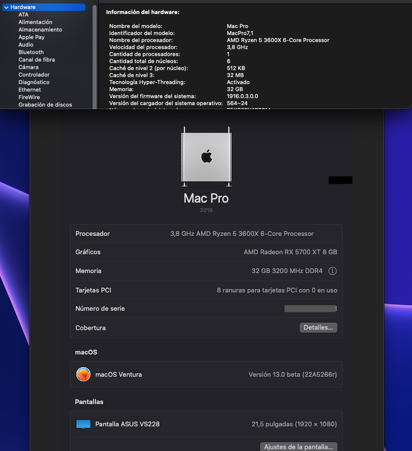

To the unfortunate owners of the infamous MSI board (in my case x570 Gaming Edge Wifi) I was able to install Ventura (Bios version 7c37v18)
Steps to follow:

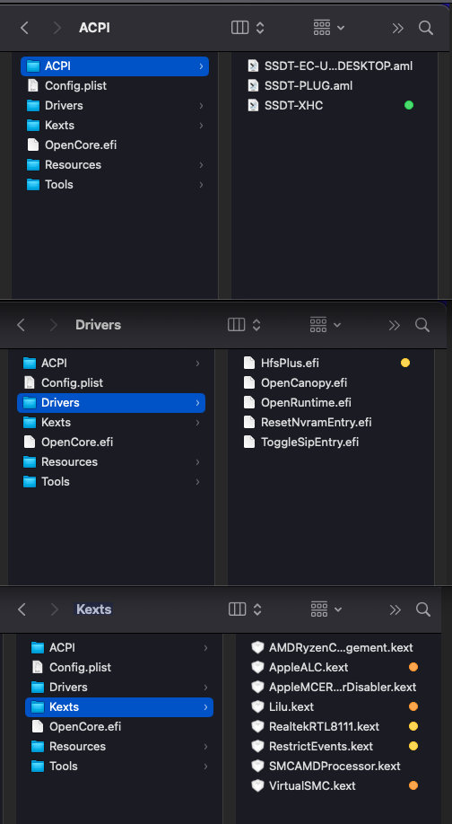

B) Download Opencore 0.82 and the latest kext for your motherboard.
C) Create the EFI folder and modify it until it is compatible with Monterey.
D) Install

In Monterey at startup I have a KP very occasionally, but the next reboot it works fine.
ventura is the same
This board comes from the factory in the DSDT some USB disabled so I use SSDT-XHC that enables all. No need to limit any ports.
I have not tried wifi, nor BT, nor the S.O., at the moment I just wanted to know if it was possible to install Ventura on this board.

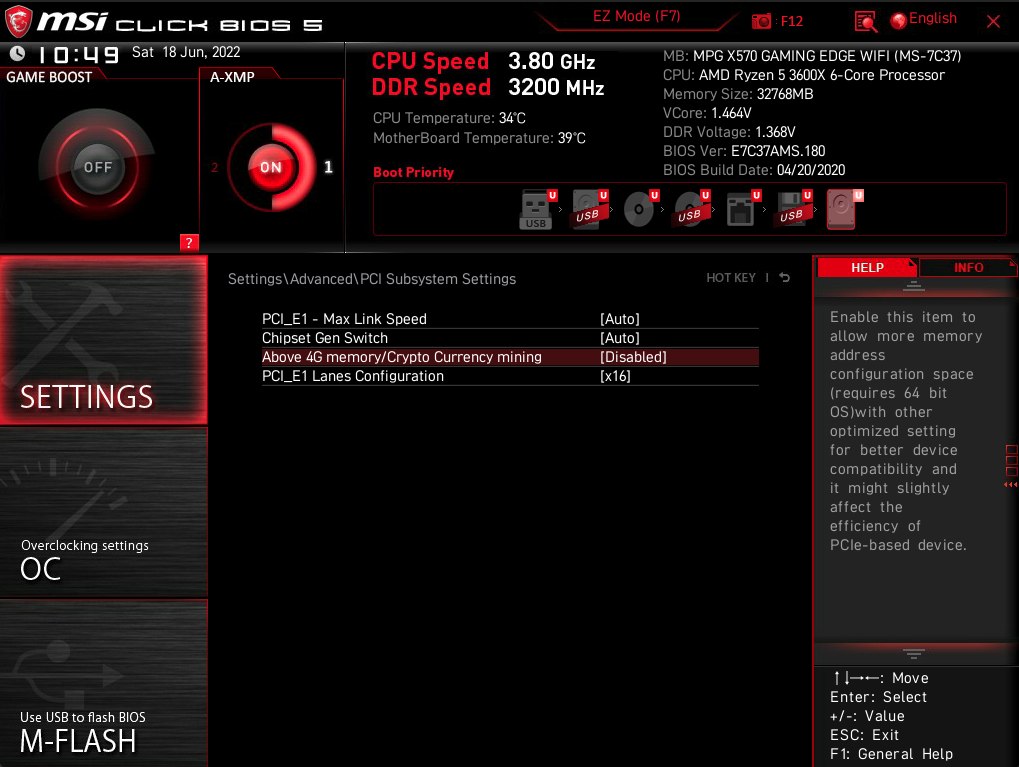

I use npci=0x2000 because I have “Above 4G memory/Crypto Currency mining” disabled in Bios
