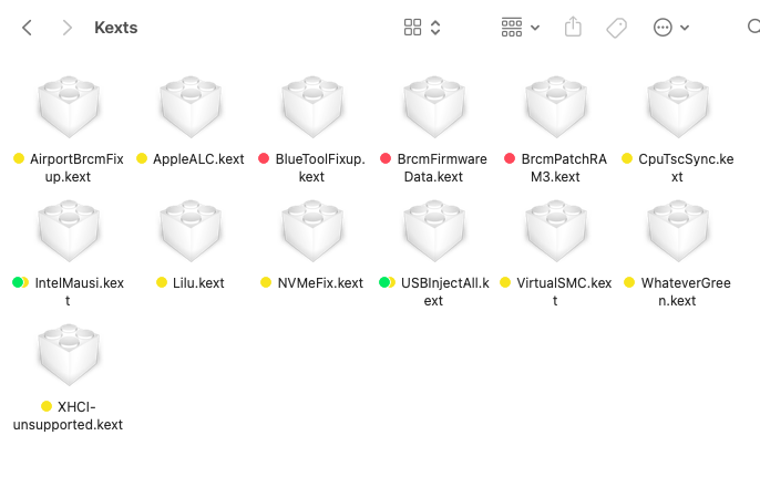

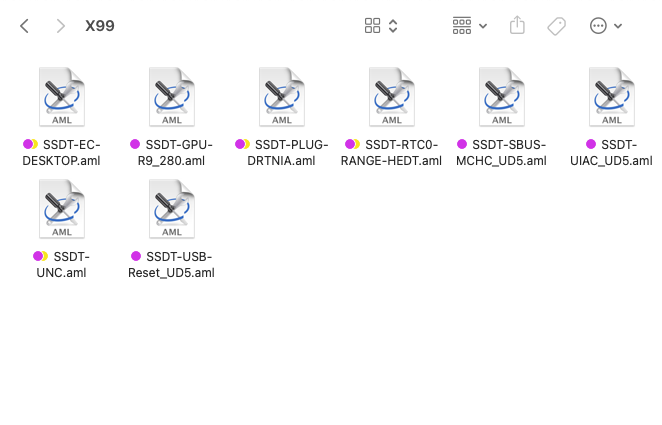

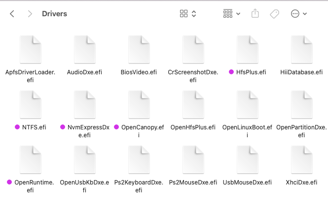

ltooz_audis Posted May 13, 2022 Share Posted May 13, 2022 (edited) My x99-UD5 with Broadwell-E i7-6900k has been working perfectly with GTX760 kepler on macOS Big Sur. I've been waiting for a long time until now macOS Monterey 12.3.1 to install it. With the new Monterey, I had to use OpenCore 0.8 with new opencanopy.efi folder to display correctly. I prefer Clover V5146 like all my laptops, but this one doesn't seem to work. I'll try it later. All problems come from the new config.plist, so I attached the configmonx99_sample.plist for you to use if you have the same setup. All the kexts should be on the internet, I attached the pictures of the folders with the files that need to be downloaded. On Monterey, my GTX760 no longer work, it's only support 7M of video ram, so I need to use the R9-280 for it to work properly, but still hang once in a while with videos. As long as you download the opencore .8 with all the files in it, all the kexts in the kernel turned on and the config.plist and you're good to go, make sure you have the graphic card supported. I also use the DW1820a that I bought for $20 for WiFi and Bluetooth, they work perfectly. Cheers, Louis configmonx99_sample.plist.zip Edited May 16, 2022 by ltooz_audis 1 Link to comment https://www.insanelymac.com/forum/topic/351701-install-monterey-1231-on-gigabyte-x99-ud5-broadwell-e-i7-6900k/ Share on other sites More sharing options...
