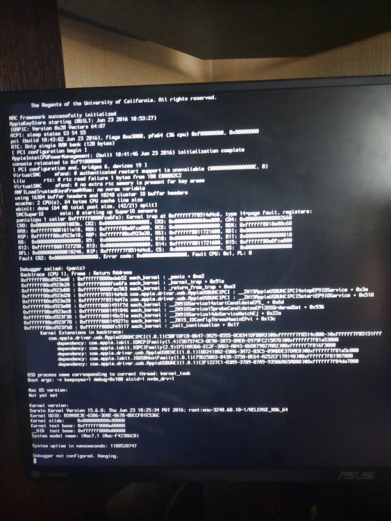

few Posted May 3, 2022 Share Posted May 3, 2022 My Computer supports only USB 1.1 EHCI and I'm trying to install macOS from a single 7GB USB stick. I also had more kernel panics but they were kernel extensions based. Now after fixing those kernel panics, I get kinda "Rare" error: Maybe USB based Kernel Panic? Hardware: Intel Core 2 Duo E6850 (Conroe) NVIDIA GeForce 9600 GT 7GB DDR2 ASUS P5KC GREEN Motherboard Gigabyte Chassis Poseidon Silver case Additional Information: I'm trying to install El Capitan on a Legacy Machine. I have tried USB mapping and it didn't help. My BIOS doesn't support Intel VT. How can I fix that? Quote Link to comment https://www.insanelymac.com/forum/topic/351592-a-rare-kernel-panic/ Share on other sites More sharing options...
Slice Posted May 3, 2022 Share Posted May 3, 2022 Yes, ElCapitan is possible here. May be you forgot to use FixUSBOwnership in clover config.plist? Quote Link to comment https://www.insanelymac.com/forum/topic/351592-a-rare-kernel-panic/#findComment-2781611 Share on other sites More sharing options...
few Posted May 3, 2022 Author Share Posted May 3, 2022 34 minutes ago, Slice said: Yes, ElCapitan is possible here. May be you forgot to use FixUSBOwnership in clover config.plist? I'm using OpenCore and the closest match to the FixUSBOwnership is ReleaseUSBOwnership, would that be ok too? Quote Link to comment https://www.insanelymac.com/forum/topic/351592-a-rare-kernel-panic/#findComment-2781613 Share on other sites More sharing options...

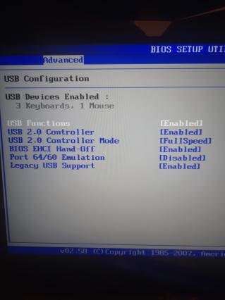

few Posted May 24, 2022 Author Share Posted May 24, 2022 On 5/4/2022 at 12:49 AM, Hervé said: Intel E6850 being Conroe, it lacks the SSE4.1 instructions set required for macOS (Sierra 10.12 and later). As such OS X El Capitan 10.11.6 (kernel 15.6.0) is indeed the last possible version you can install and run on this old system of yours. nVidia GeForce 9600GT is Tesla and should be expected to work OOB; no need for the nVidia Web Driver therefore no need for boot arg nvda_drv=1. Please note that EHCI is USB2.0 whilst USB 1.1 is UHCI: https://en.wikipedia.org/wiki/Host_controller_interface_(USB,_Firewire) But it's surprising that a Conroe platform would not provide support for USB2.0 port. Did you check your USB settings in BIOS setup? Should be set to enhanced/fast, not compatible/legacy. Don't hesitate to post a zipped copy of your OC EFI folder. Sorry for late reply, here you go. A photo is USB BIOS configuration and the link is the content of my USB: https://www.mediafire.com/file/yzw9db319xqxhmj/opencore.zip/file Quote Link to comment https://www.insanelymac.com/forum/topic/351592-a-rare-kernel-panic/#findComment-2782765 Share on other sites More sharing options...
few Posted May 24, 2022 Author Share Posted May 24, 2022 12 minutes ago, Hervé said: So you obviously have USB2.0 controller/ports. What options does your BIOS offer for USB2.0 Controller Mode: FullSpeed and ??? HiSpeed Quote Link to comment https://www.insanelymac.com/forum/topic/351592-a-rare-kernel-panic/#findComment-2782769 Share on other sites More sharing options...
few Posted May 25, 2022 Author Share Posted May 25, 2022 11 hours ago, Hervé said: Go for HiSpeed, that's for USB2.0 speed when FullSpeed is for USB1.1 speed. As always, remember the golden rule: RTFM... https://www.manualslib.com/manual/438353/Asus-P5kc.html?page=91#manual Do I need to set these configurations in my BIOS? As you linked it. When I turn on HiSpeed in BIOS, I get this kernel panic: Quote Link to comment https://www.insanelymac.com/forum/topic/351592-a-rare-kernel-panic/#findComment-2782785 Share on other sites More sharing options...
few Posted May 25, 2022 Author Share Posted May 25, 2022 18 minutes ago, Hervé said: If you want UB2.0 speed, you must set USB2.0 controller mode to HiSpeed. Goes without saying and this affects all OS you'd install on that old computer. You're experiencing a KP because your setup is incorrect. OpenCore is not suited to old Core2Duo platforms given that it does not support generating C states & P States like Clover and earlier bootloaders such as Chameleon/Enoch do. Generating C States and P States is necessary to provide proper CPU Power Management. You should switch to Clover for your old system, Opencore is not really suitable here. I've noticed that you inject XHCI-unsupported kext but that's for USB3.0 which your system does not have; as such, get rid of that kext. You also inject a SSDT-EC-Desktop patched table but that's not required for El Capitan. I'd get rid of it too. nVidia GeForce 9600 GT is Tesla and should therefore be natively supported; as such no need for the nVidia WebDrivers nor your boot arg nvda_drv=1. In fact, did you actually install the Web Driver? You may just need to inject a few nVidia properties through DSDT patching or, ideally, dedicated patched SSDT should the card not be supported OOB. Can you link me a tutorial how to make Clover hackintosh? Quote Link to comment https://www.insanelymac.com/forum/topic/351592-a-rare-kernel-panic/#findComment-2782792 Share on other sites More sharing options...
