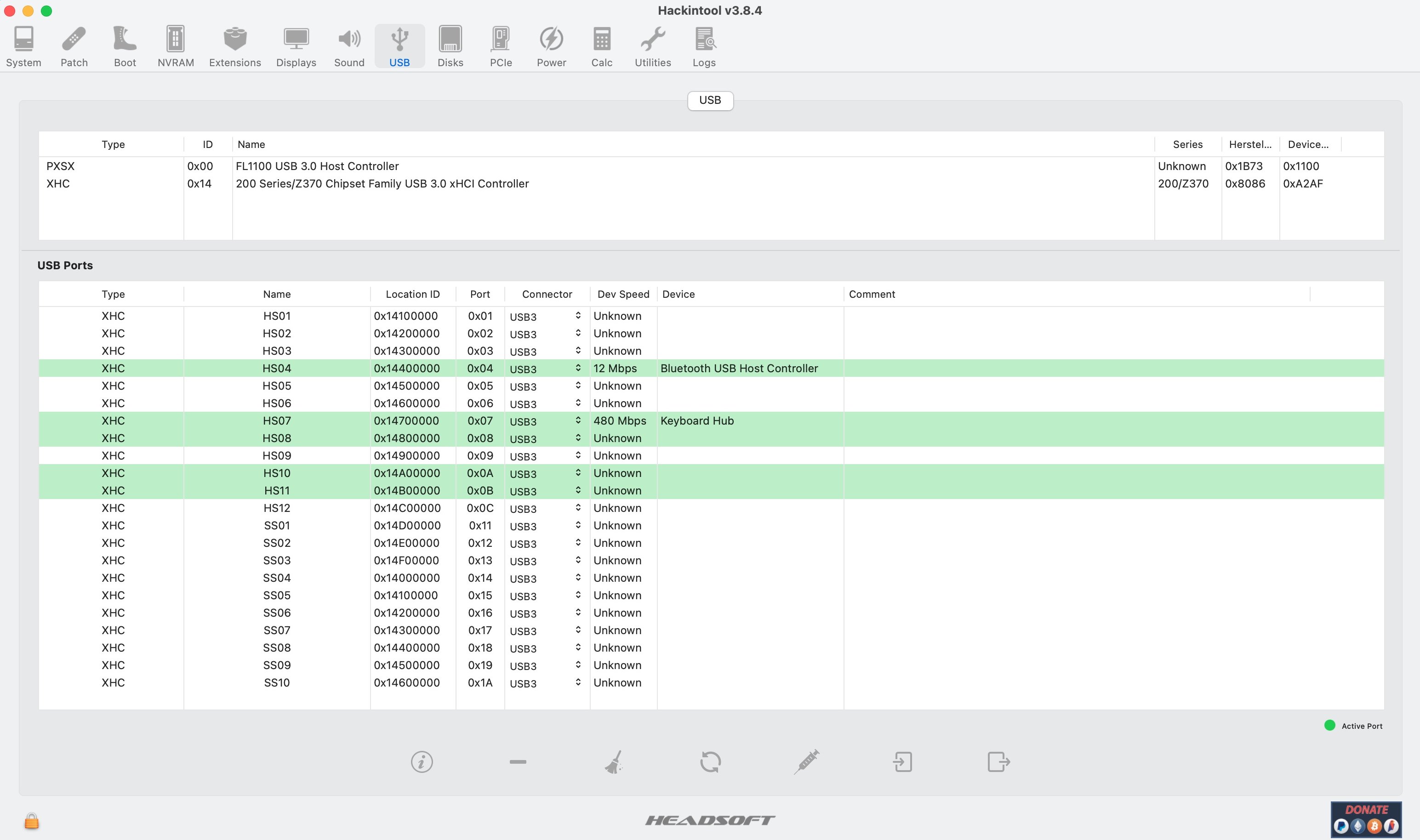

AlfredoM Posted March 14, 2022 Author Share Posted March 14, 2022 (edited) On 3/13/2022 at 10:42 AM, Hervé said: BCM94360CD, being an Apple card, works OOB and requires no add-on kexts a all; you can therefore remove those firmware patching kexts that are of no-use at all for that card. I use such card in my Dell Latitude E6230 laptop without issue under Big Sur and a closely related BCM94360CS2 in my Latitude E7270 without issue under Big Sur and Monterey. Those have always worked and still work 100% OOB. You likely have a USB-related issue. Yes, it is probably the USB problem, which I have now solved with the XHCI-unsupportet.kext. So you mean that I can remove all the BT kexts and it would still work? You're actually right, because the OC 0.6.6. I didn't have any Bluetooth kexte in it and it worked. I will test it tonight am currently on the iMac UPDATE: I'm on the hack right now... you're absolutely right, it doesn't require a single bluetooth kext. Just like it was before with OC 0.6.6. It was just the error in my USB ports and that the XHCI-unsupported.kext was set to true instead of false. I'm attaching a photo from Hackintool for you, I don't know how to patch these USB ports so that ALL USB ports work and not just a few. could you help me with this ? Do you need any information from me about this? I would be happy to learn that this 15 port limit is no longer there. Edited March 14, 2022 by AlfredoM Link to comment https://www.insanelymac.com/forum/topic/351077-not-bluetooth-in-big-sur-10116-and-not-in-monterey-1221-and-beta-123/#findComment-2778253 Share on other sites More sharing options...
