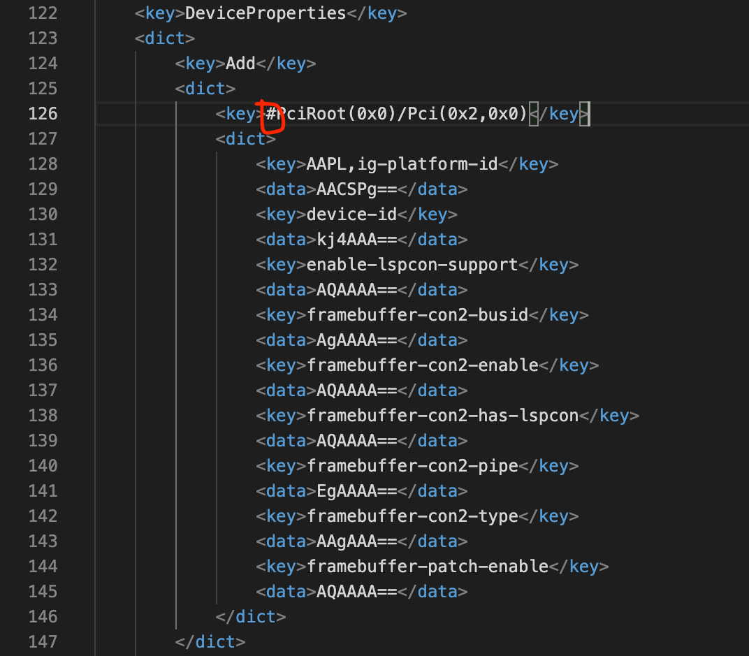

Guest Posted March 8, 2022 Share Posted March 8, 2022 (edited) EFI is incorrect. I deleted "#" that prevents graphics patches. EFI.zip Edited March 8, 2022 by vivzer0 Quote Link to comment https://www.insanelymac.com/forum/topic/350957-lenovo-yoga-c740-15iml-81td-wont-boot-to-catalina/#findComment-2777829 Share on other sites More sharing options...
