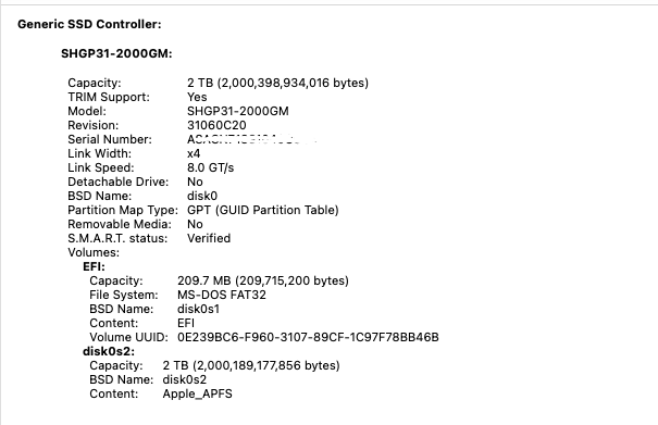

rafale77 Posted January 27, 2022 Author Share Posted January 27, 2022 A continuation of my test, I am happy to report that the Hynix P31 2TB works out of the box unlike what Dortania reports on github. Like the Phison E12, the boot time is 21s which is the shortest I have seen. I can now only conclude that there is a minor problem occurring during boot with the Silicon Motion drives and MacOS beyond what the Samsung drives are seeing. I can now definitely recommend the 2TB Hynix drive and someone else on github has had good experience with the 1TB drive after firmware update. MacOS would otherwise stall during boot even if the drive was merely detected by MacOS. Link to comment https://www.insanelymac.com/forum/topic/350559-nvme-ssds-and-macos-boot-times/#findComment-2775800 Share on other sites More sharing options...
