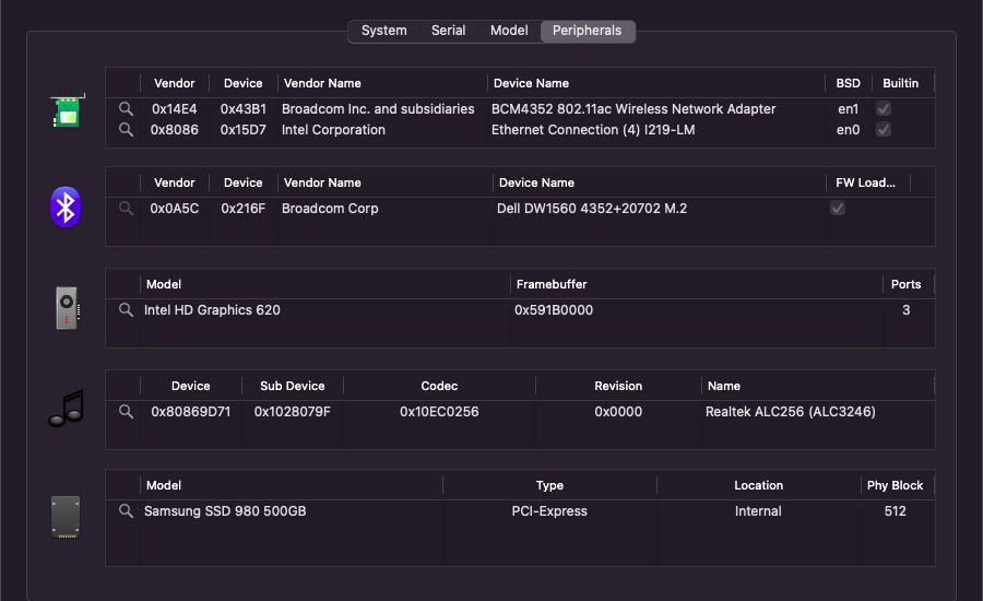

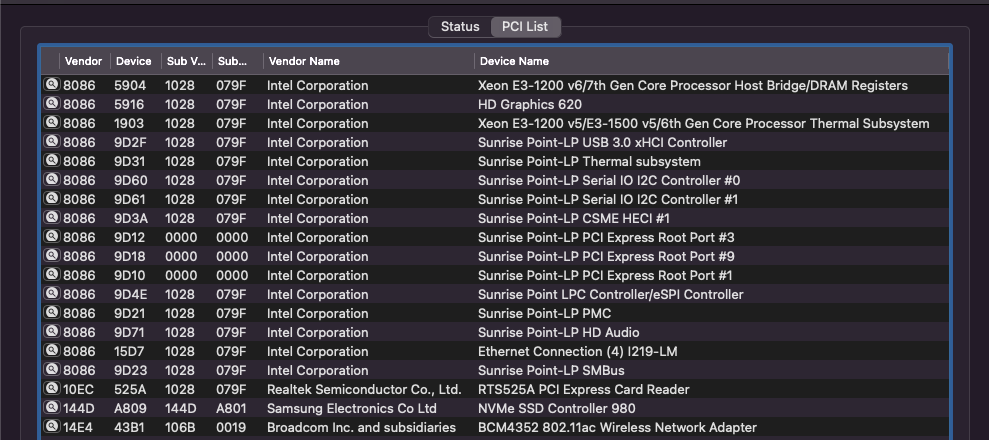

Computer Spec:
Component Brank
CPU Intel i5 7300U (2C-4T 3MB KBL)
iGPU Intel® HD 620 Graphics
Lan Intel I219-LM
Audio Realtek ALC256
Ram Crucial 16 GB DDR4 2133 Mhz
Wifi + Bluetooth BCM94352Z (DW1560)
NVMe SAMSUNG 980 500 GB (MACOS+WIN 11)
SmBios MacBookPro 14,1
BootLoader OpenCore 0.7.7
macOS
Monterey 12.2 Beta 2
What works :
  •  Intel HD 620 iGPU eDP with Backlight Output
  •  Intel HD 620 iGPU HDMI Output
  •  Intel HD 620 iGPU Type-C to HDMI Output

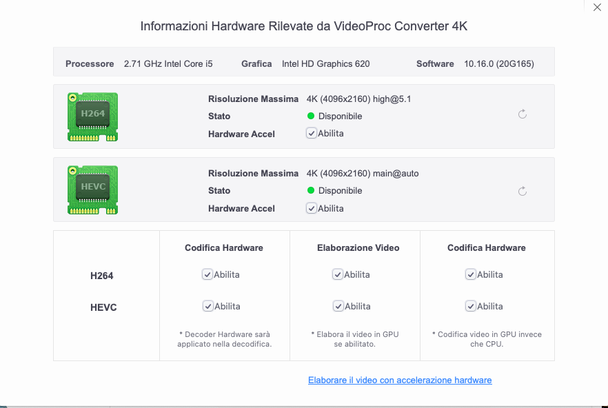

  •  Intel HD 620 iGPU - H264 & HEVC
  •  ALC256 Internal Speakers
  •  ALC256 Internal microphone
  •  ALC256 Combojack headphones
  •  ALC256 Combojack microphone
  •  ALC256 HDMI Audio Output
  •  ALC256 TYPE-C to HDMI Audio Output
  •  All USB-A 3.1 Ports (TYPE-C 3.1 Included)
  •  SpeedStep / Sleep / Wake
  •  HID Key PWRB & SLPB

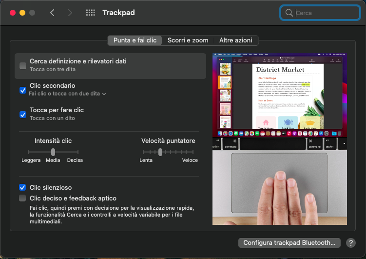

  •  I2C ALPS Touchpad with gesture
  •  Keyboard (PS2-Internal) with backlight
  •  Brightness Key
  •  F11 Print Screen Key
  •  F1 & F2 & F3 Sound Key
  •  Wi-Fi and Bluetooth BCM94352Z (DELL DW1560) Module
  •  Lan Intel I219-LM
  •  SSD NVME Slot-1 PciE
  •  Micro SD Cardreader
  •  WebCam (USB-Internal)

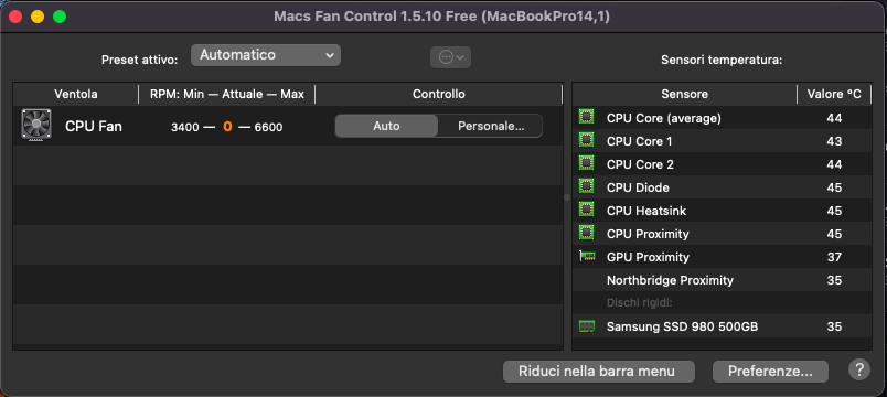

  •  All Sensors CPU, IGPU, BATTERY, NVME, FAN
  •  ACPI Battery
  •  NVRAM (Native)
  •  Recovery (macOS) boot from OpenCore
  •  Windows 11 boot from OpenCore
