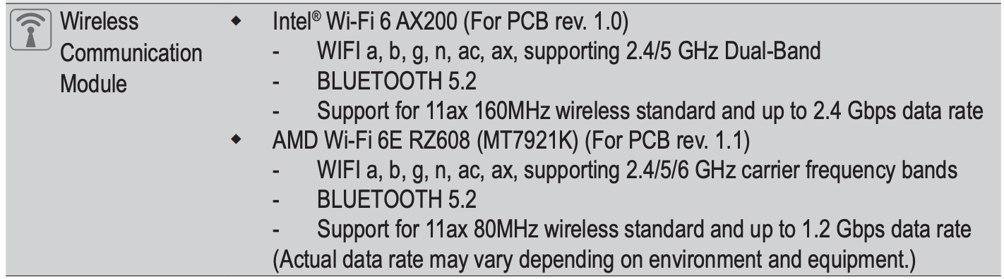

sebtech Posted January 16, 2022 Author Share Posted January 16, 2022 (edited) 7 minutes ago, Hervé said: As I said, Chris1111 does not write drivers; he merely collects those that have been published over the years by manufacturer's and fits them into his own installation package. That's a far as his tool goes. Sorry but I think your post wasn't be updated when I was replying... And refering to the Gigabyte's documentation, since the 1.1 PCB revision, the wireless module has changed : Edited January 16, 2022 by sebtech Link to comment Share on other sites More sharing options...
