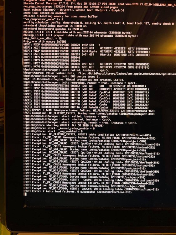

bigpoppa206 Posted January 21, 2022 Author Share Posted January 21, 2022 On 10/8/2021 at 8:18 AM, Hervé said: That's it? Are we supposed to guess the targeted platform? Is it the computer in signature? What bootloader? What config? We're pretty good but for miracles and crystal ball readings, it's odd sundays only, 10am. All I can say is that your system does not hang with an error message "ACPI Error: 7" but with an error message "ACPI error: 7 table load failures...". Seems clear enough to me and the affected tables are listed right above that last message: DSDT + 6 x specifically named SSDTs. -> Erroneous config or issues with patched tables in all likelyhood. Seems CPU power management related. Can only be a guess at this point of time. What part of my signature are you having issues with? CPU: Intel Xeon 3370 Quad Core, MB: Gigabyte GA-EP45C-UD3R, RAM: 8GB (2 * 4 Corsair DDR3 PC3-12800 Boot SSDs: Crucial MX100 2.5" 512GB SATA III SSD, Graphics: Nvidia GT 740 OS: Lion 10.13.6, retail vanilla install using Clover & customized DSDT 1 Link to comment https://www.insanelymac.com/forum/topic/349191-1013-install-hung-up-at-acpi-error-7-in-verbose-mode/#findComment-2775415 Share on other sites More sharing options...
Guest 5T33Z0 Posted January 21, 2022 Share Posted January 21, 2022 @bigpoppa206 About your OS: OSX Lion = 10.7 macOS 10.13.6 = macOS High Sierra. Which one is it that you are trying to install? And which version of Clover are you using? Link to comment https://www.insanelymac.com/forum/topic/349191-1013-install-hung-up-at-acpi-error-7-in-verbose-mode/#findComment-2775422 Share on other sites More sharing options...
