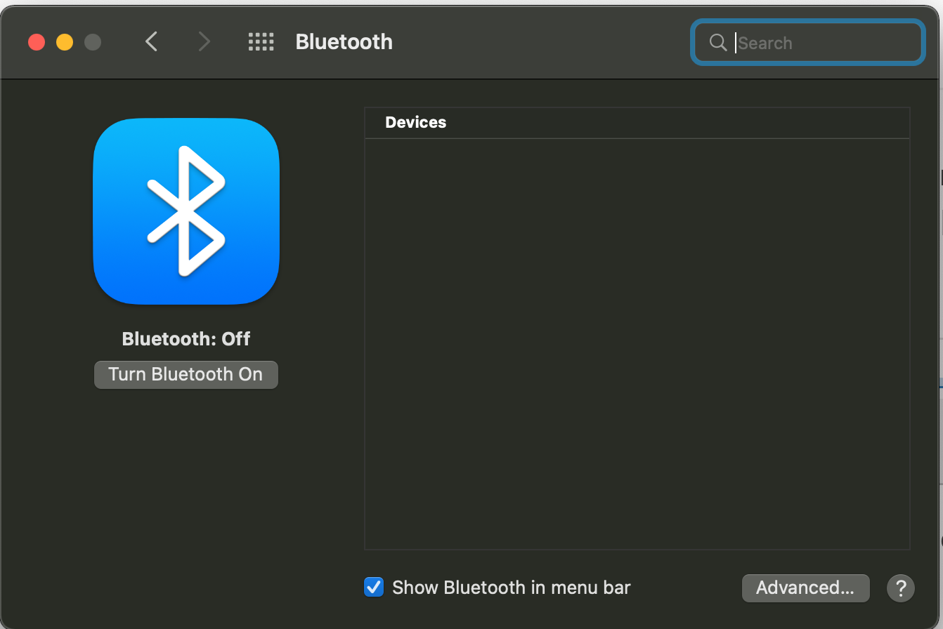

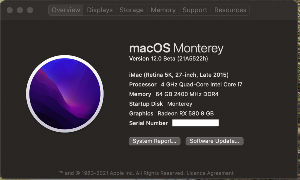

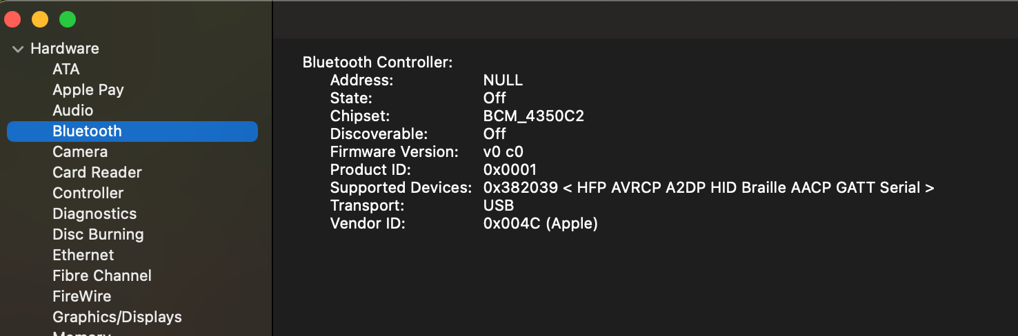

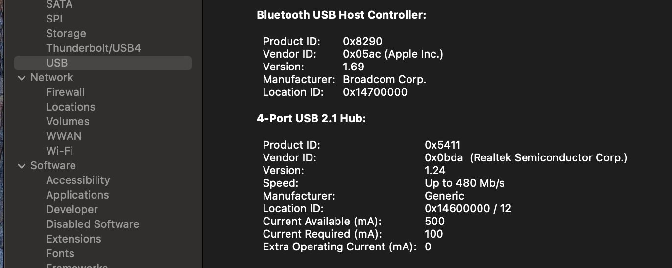

Henties Posted November 2, 2021 Author Share Posted November 2, 2021 To @All whose bluetooth IO peripherals, such as a magic keyboard and mouse, stop functioning when Monterey 12.1 wakes from sleep. I discovered that this does not happen when I run Monterey 12.1 with bluetooth turned off, the attached screenshots refer. It appears that Apple split their "code" controlling the operation of bluetooth into a section for IO peripherals and another one for airdrop and whatever, and that these 2 software streams do not as yet live well together and in "harmony" on some of our hacks. I have been writing this posting on Monterey and an Apple magic keyboard, with bluetooth off, after the machine was woken from sleep a number of times. When I use my IO peripherals with bluetooth turned on I can only restore their functionality with a reboot after the machine has woken from sleep. I tried the latest "BlueToolFixup.kext" on its own and also in combination with the other kexts present in the 2.6.1 release folder, but without any success whatsoever. I am using a Fenvi T919 adapter Regards Henties 1 Link to comment https://www.insanelymac.com/forum/topic/349024-bluetooth-woes-with-fenvi-t919-under-monterey-beta-7/#findComment-2770827 Share on other sites More sharing options...
Henties Posted November 2, 2021 Author Share Posted November 2, 2021 @All, I conducted more tests and in the process some more mysteries unfolded. Monterey: Cold booting Monterey with bluetooth disabled allows me to navigate the OC boot menu and pick whatever operating system I want to boot into. All this with only an Apple magic keyboard and mouse, this basic BT functionality must therefore originate or is embedded in the OpenCore codebase, although I also have basic BT functionality in my bios environment, therefore BT in the OpenCore environment may actually originate from the bios code as well. This basic BT functionality even allows me to actually enter the Monterey desktop via its login screen, promting me for my password, which I enter with my Apple magic keyboard, and I once again emphasise with Monterey's bluetooth turned off good and solid. Big Sur: Cold booting Big Sur with bluetooth disabled also allows me the same Apple magic keyboard and mouse functionality whilst still in the OpenCore menu environment, but here the bus stops in its track. When the Big Sur boot process has completed and I land on the login screen there is no response registered by pressing a key on my Apple magic keyboard, which is what one would expect to happen considering BT is switched off in Big Sur. To me it is clear that the basic Opencore or bios bluetooth functionality is being disabled during the Big Sur boot process making "room" for Big Sur's own BT code to kick in, provided Big Sur's BT is in "On Mode". During the Monterey boot up process the basic opencore or bios bluetooth functionality is allowed to survive up to the Monterey login screen and beyond. Therefore once In Monterey the basic BT functionality, is allowing BT IO peripherals to continue operating normally. That basic OpenCore BT service is even able to survive as many sleep wake sequences as one desires, provided Apple's own bluetooth remains off. As a consequence that obviously no airdrop and whatever, will be available, as these features are not, and need not be provided by the source providing the basic BT capability, which somehow continues to make it's presence felt in the Monterey environment where it should never have been in the first place. Just my 2 cents worth. Greetings Henties 2 Link to comment https://www.insanelymac.com/forum/topic/349024-bluetooth-woes-with-fenvi-t919-under-monterey-beta-7/#findComment-2770835 Share on other sites More sharing options...
